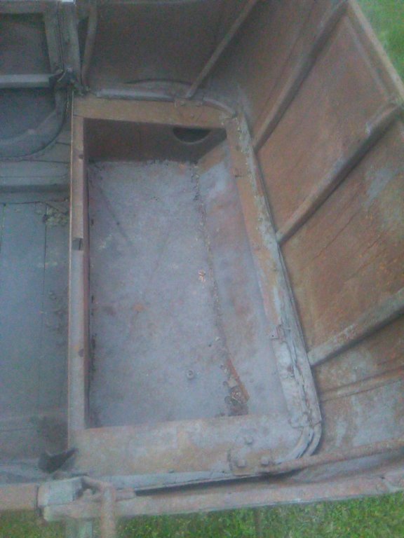

I am ready to start the body work on my 1916 Touring, there is a lot of surface rust on the inside and out. I would like to remove this support for the back seat so I can get at the rust better. Does it come out? Know of any videos?

Sheet metal looks to be in great shape with just superficial rust. I’d mix up a 50/50 water and Ospho and brush it on. Then it can be spray painted after drying. Removing 106 year old wood from 106 year old wood wouldn’t portend a result as structurally sound as it is now....

Personally, I view the rust in the photo to be merely surface rust and if that is correct, this treatment is ideal for it.
