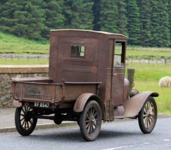

Decipher this pickup?
Post by Flivver » Mon May 23, 2022 10:26 am
I am not familiar with this model year / body style. Is this a TT? Most TTs I have seen don't have pickup boxes, and look heavier than this. Is it a TT body on a car(pickup) chassis?
Posts: 5585
Re: Decipher this pickup?
Post by RajoRacer » Mon May 23, 2022 10:32 am
Yes, closed cab on a car chassis AND a rare 1925 Ford box !

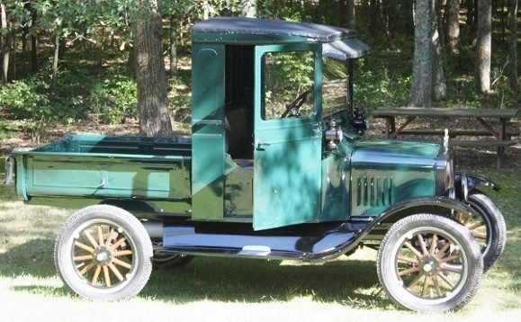

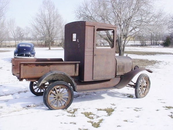

Post by DanTreace » Mon May 23, 2022 10:49 am
Fun build, many can be found done in recent time. Wasn't ever a Ford T body type of a closed cab and bed on T chassis.
Use the '24-'25 all steel TT closed cab, placed on regular T chassis and adding a period runabout '25 metal pickup box.
IMG_6301 (800x494) (600x371) (579x358).jpg (143.26 KiB) Viewed 2468 times
DSC00042 (600x450).jpg (136.73 KiB) Viewed 2468 times

Post by Original Smith » Mon May 23, 2022 11:23 am
The first photo appears to be in a foreign country by the license plate.

Post by Mark Gregush » Mon May 23, 2022 12:06 pm
Maybe not so foreign to the OP! :)

Taked a rusted out, busted-up, dogged-out closed cab, rebuild it and do a 3" top chop.... put it on a T chassis with a pickup bed.

Post by Mark Nunn » Mon May 23, 2022 1:26 pm
Scotland, if I remember correctly. John ?

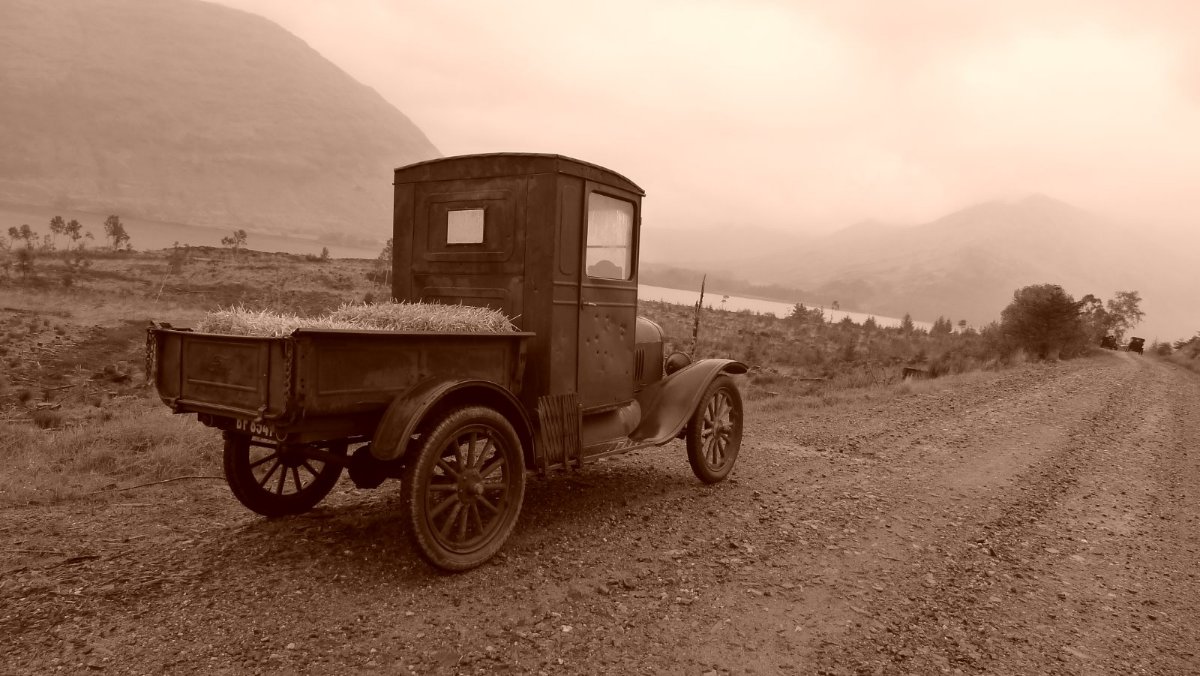

Post by Mark Nunn » Mon May 23, 2022 1:37 pm

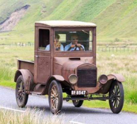

Post by jiminbartow » Tue May 24, 2022 11:23 am
Looks like somebody got mad at that passenger side door and took a hammer to it. Jim Patrick
