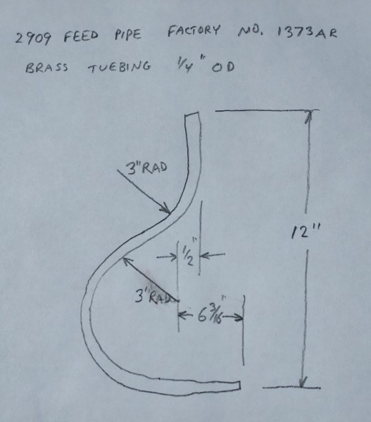

I looked this part up at the Benson Ford Research Center and sketched the shape and dimensions from the drawing. I made my fuel line out of automotive brake line. Do not use soft copper tubing.

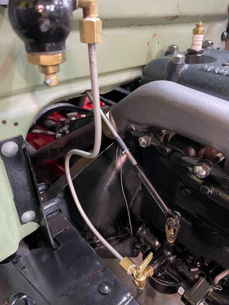

The extra shut off valve that most use can be placed either at the carburetor or at the sediment bowl

On my 1926 coupe. Jim Patrick

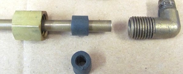

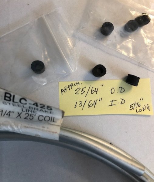

Humblej .... 1/4" neoprene gas line rubber has thicker walls compared to 1/4" neoprene rubber vacuum tubing. , so will not be acceptable for a sealing packing.....Pictured below is the neoprene vacuum tubing, ..... when cut to size fits snug on metal gas line, and leakless after retaining nut is tightened.

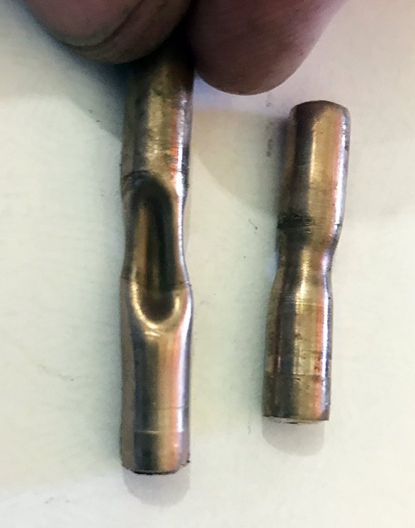

to add to what Bob said, it takes very little tightening to get a leak free seal. Additionally, the rubber expands to grab threads and it acts as a very nice deterrent to accidental unscrewing. Excessive tightening will act like a very effective swage and can "neck down" the tubing on some tubes depending on the alloy used.
also note the use of the correct elbow and nut in the pictures!! This is very important! You cannot buy this fitting or nut from a hardware store...it can only be purchased from a "T" guy or a supplier. The correct fitting will have 1/8 NPT on one end and the correct 1/2-18 end on the other end (not a compression-ferrule fitting). This fact cannot be stressed enough.
