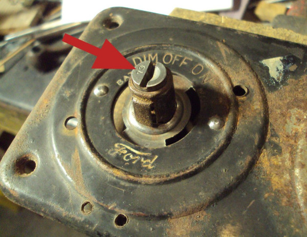

This is where the number should be found.

Post by J1MGOLDEN » Tue May 24, 2022 1:18 pm
The odds are quite high that the key cylinder is broken anyway.
The pot metal cylinder absorbs water and expands with age.
The top and bottom of the key slot is usually broken or missing, as it appears to be in the above photo.
