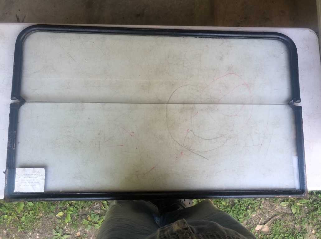

I need to change to safety glass in my 100 year old touring T.
I have taken the frame and glass out of the car and found a fellow to cut the safety glass and replace it.
What advice can forum users give me to get out the old glass and put in the new safety glass?
Should heat be applied or some solvent to loosen the glass? It seems to be solidly held in the frame.
I don’t want to bend the frame while getting out the glass either. Any ideas?
Secondly, what should be used to pack the frame when putting the new glass in?
Thanks.

I JUST did my 1915 107 year old plate glass to modern safety glass and to be honest, it was surprisingly easy. I sprayed wd-40 on the channel for about 24 hours, unscrewed and removed the end caps by tapping with a small hammer. I then clamped two pieces of wood on either side of the glass and wiggled it right out. I took the panes to my local glass company and they charged me $134.00 for the new glass. I was very happy. bobt

I used two blocks of wood, two pieces of rubber floor mat and C clamps. Hold the frame down with your feet and pull out the glass.

WD 40 on both sides of the glass channel (still holding plate glass). Remove the end caps and set aside being careful to not lose the 2 little screws. Using a gloved hand grab the glass in the center of the windshield. Lift it comfortably, now using a rubber mallet tap the 2 frame ends equally where the end caps used to be. Install safety glass by evenly tapping the glass into the channels. I did this on my ‘14 with brass-not nickel-channels. I carefully removed and highly polished them. Then clear coat powder coated them. Still appears shiny after 12 years.

I was able to remove both the upper and lower glass and take it to a car glass company who used it for a pattern.
They even made sure to cut the new glass so that the saftey glass stamp was visible on the lower drivers side at no extra cost.
I cleaned the old channel and slipped the new glass in, then tightened it all up.
Turned out a nice job.

My friend had his done recently - he separated the two windshield halves and took the whole shebang to the glass company. They removed the old glass, fabricated and installed the new and disposed of the old glass. Giving them the whole windshield insured everything fit right.
