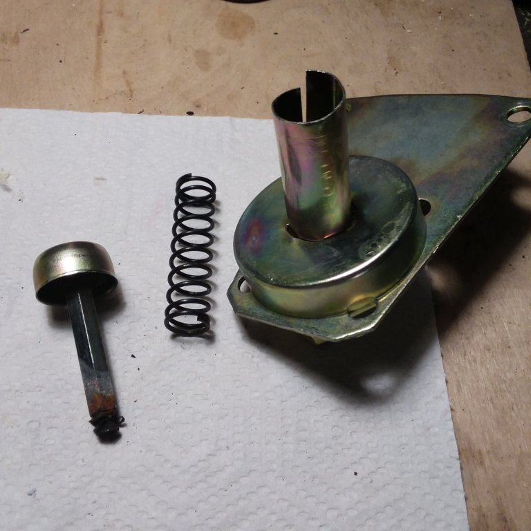

Mashed a bit too hard on my starter switch today. Good thing i had a spare.... bent, loose and wobbly. It shorted out and the arc sound was spectacular. Did a bit of welding.....

That's a modern replacement, and they often fail at that point. In my experience, they also have inadequate material in the spring contacts within the switch. They seem to lack 'spring' to recoil the bridge from the base contacts, causing them to 'weld' on.
A good original is far better if you can find one. I posted one for sale recently, but perhaps he postage inclusion made it too dear for some.

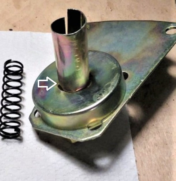

The problem with the current reproduction switches is that the tube hold the plunger is affixed to the base with 4 bent over table (not the tabs holding the mechanism to the large plate). The plunger only needs to be depressed about 1/2" or so to make contact. So that's all the plinger head needs to be above t he floor board. Any higher will put too much force on tube.Professor Fate wrote: ↑Wed May 25, 2022 1:01 amHi Allan!

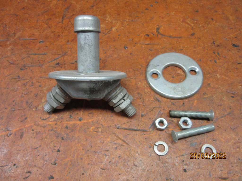

This very reasonable priced one is the type that had the top come off my switch while I was driving.
The only option was to pull over and shut off the engine, then quickly remove the battery terminal.

Save the mounting plate, as it can be used to mount a solenoid.
Then you can hide a small starter button to trigger the solenoid.

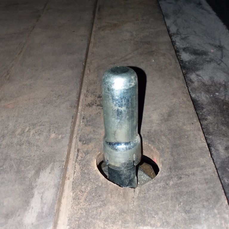

The replacement switch is pictured. Is this a good switch it at least better than the failed one I had?? It just sits too high. Not easy for me to get to.

The extension is wrong here. Take it off.Professor Fate wrote: ↑Wed May 25, 2022 4:51 pmThe replacement switch is pictured. Is this a good switch it at least better than the failed one I had?? It just sits too high. Not easy for me to get to.
I'm still going to a push button or pull knob to be mounted next to my main cutoff switch on the metal seat bottom between my knees.
Having the main cutoff there was excellent to provide a quick response to a major short yesterday.
If the top of the switch is not quite high enough to just activate, put some spacers under the switch base.
Is it mounted on top of the frame now?

Not only is that switch to high but the hole is too big. I’ve seen too many people get in there and push the switch sideways as they’re pushing it down and that messes the switch up
