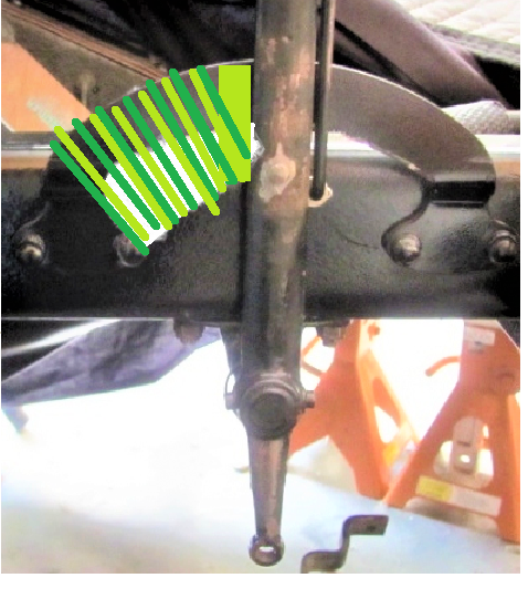

- Posts: 6579
Re: Trying to get an idiot-proof free neutral for shipping my T
Good idea! But since others suggest allowing for neutral and brake, just block the unwanted half. No need to write instructions it looks like a hand brake. If they don't recognize it as such they wouldn't think of reading instructionsThreePedalTapDancer wrote: ↑Thu May 26, 2022 12:34 pmPut the brake lever upright and insert a block of wood into the slot in front and behind the lever and secure it from moving.

- Posts: 5248
Your pix here shows me a simple C clamp or equivalent on the quadrant would do the job easily.TRDxB2 wrote: ↑Thu May 26, 2022 5:34 pmGood idea! But since others suggest allowing for neutral and brake, just block the unwanted half. No need to write instructions it looks like a hand brake. If they don't recognize it as such they wouldn't think of reading instructionsThreePedalTapDancer wrote: ↑Thu May 26, 2022 12:34 pmPut the brake lever upright and insert a block of wood into the slot in front and behind the lever and secure it from moving.

- Posts: 6579
I'd just tape something, someone is liable to steal the c-clampspeedytinc wrote: ↑Thu May 26, 2022 5:45 pmYour pix here shows me a simple C clamp or equivalent on the quadrant would do the job easily.TRDxB2 wrote: ↑Thu May 26, 2022 5:34 pmGood idea! But since others suggest allowing for neutral and brake, just block the unwanted half. No need to write instructions it looks like a hand brake. If they don't recognize it as such they wouldn't think of reading instructionsThreePedalTapDancer wrote: ↑Thu May 26, 2022 12:34 pmPut the brake lever upright and insert a block of wood into the slot in front and behind the lever and secure it from moving.
