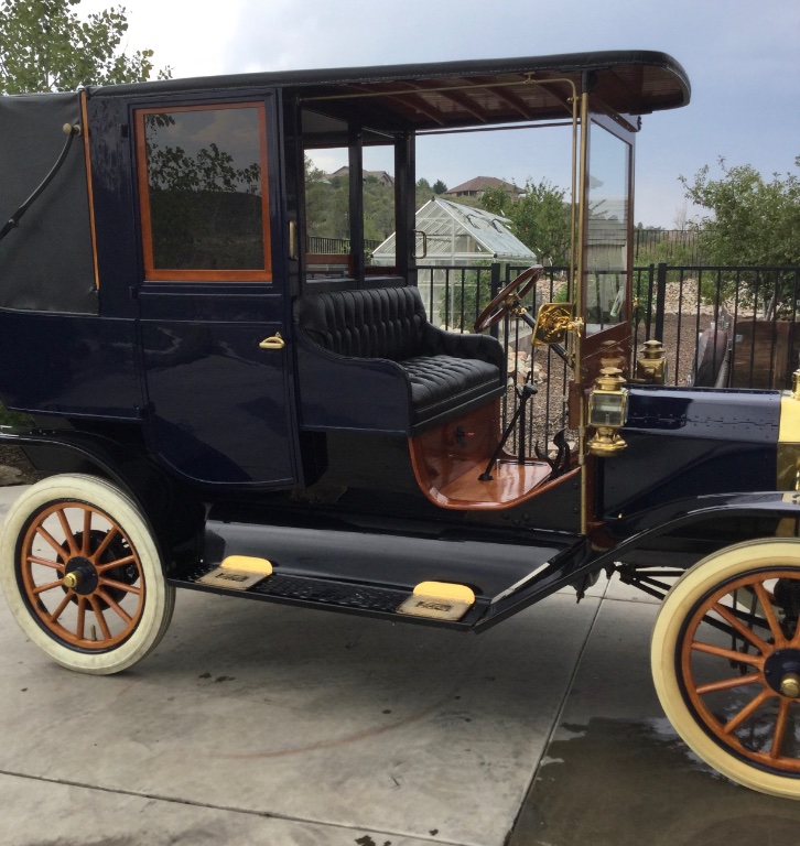

In order to match the original factory paint, the body of the 1915 town car in the thread below was painted an extremely dark 1940s or 50s Cadillac blue approximately 65 years ago when it was owned by the late Dwight Madsen. (It was painted in the body shop of Warren Cadillac in Minneapolis.)
A casual observer viewing the car in person may think it is black but it is, in fact, blue (In person, it is slightly more obvious that it is blue than what is indicated in the photos.)

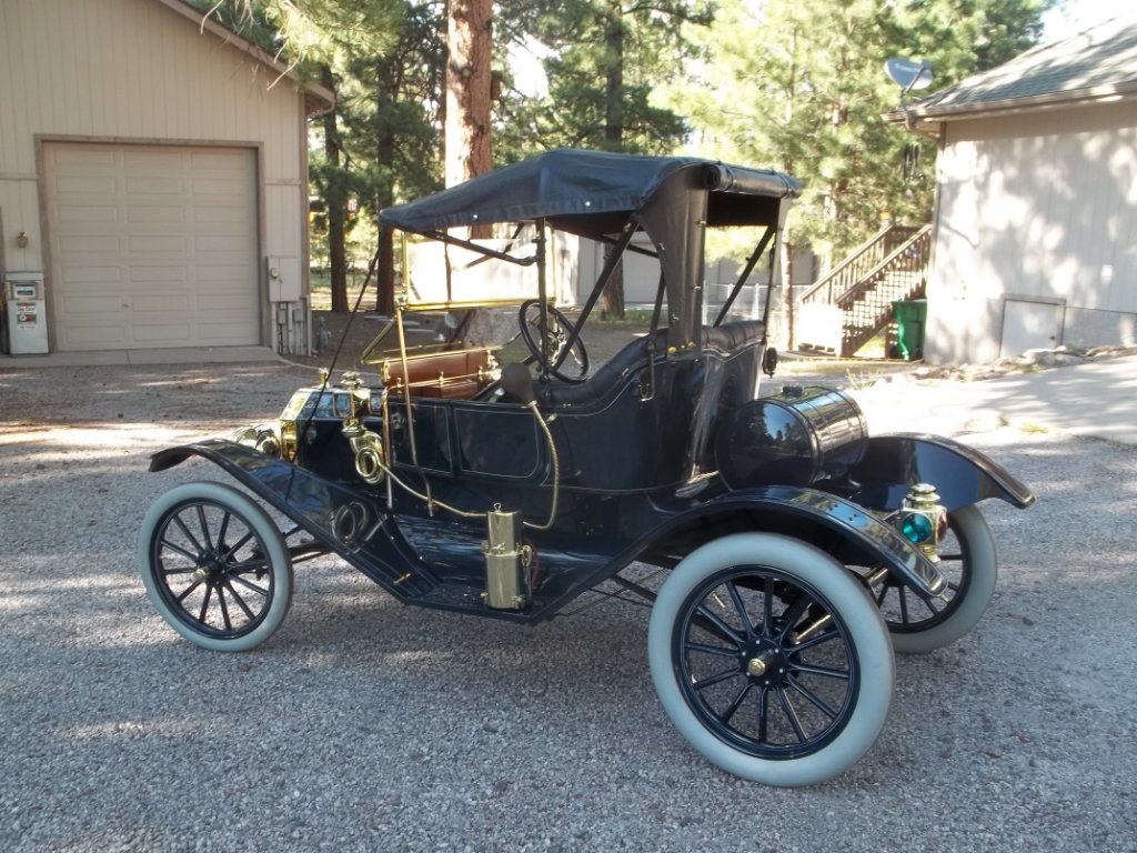

Again, opinions….. you know what they say about everyone having one. Here is a subtle example , made in my hometown of Elyria, ohio. Very subtle, huh?

My point being, for everyone’s “opinion” , there is usually a counter opinion. Many of these things are unknowable, and just opinions.

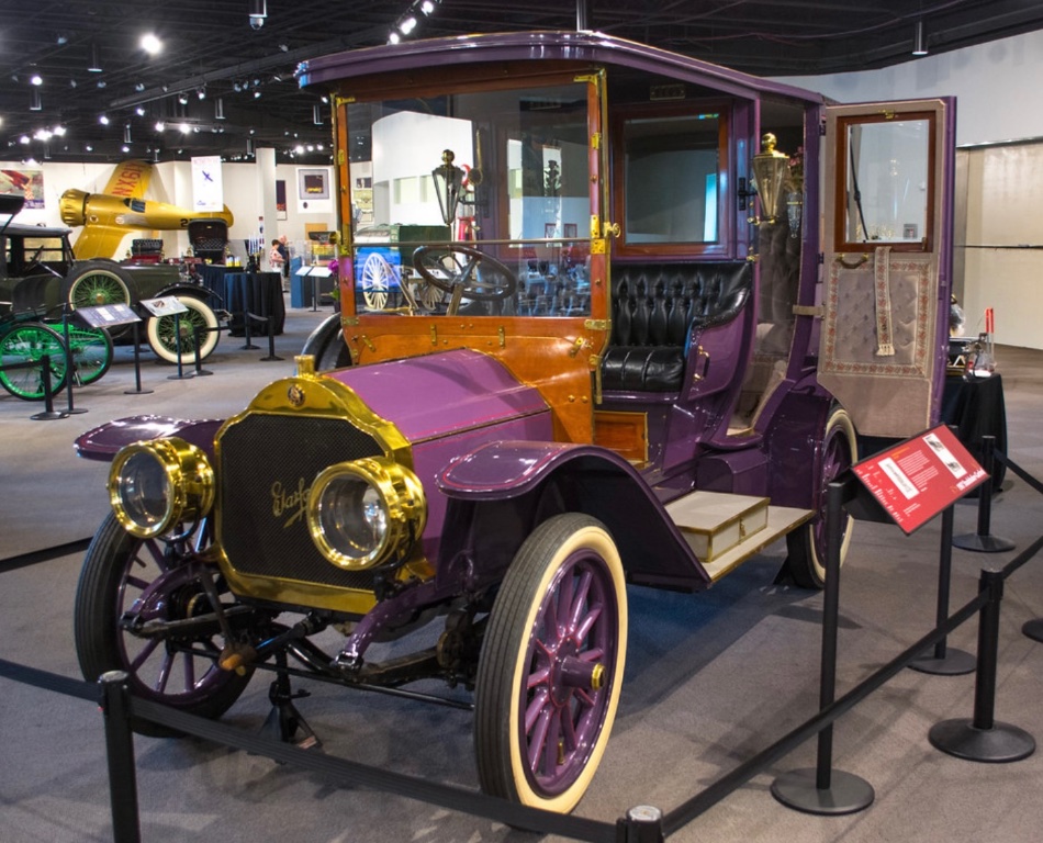

Tim, Mrs. Potter Palmer's custom-painted heliotrope Studebaker-Garford limousine shows there are always some exceptions, even if it takes a wealthy Chicago hotel widow to do it. Fortunately Garford limousines came standard with more conventional color options.

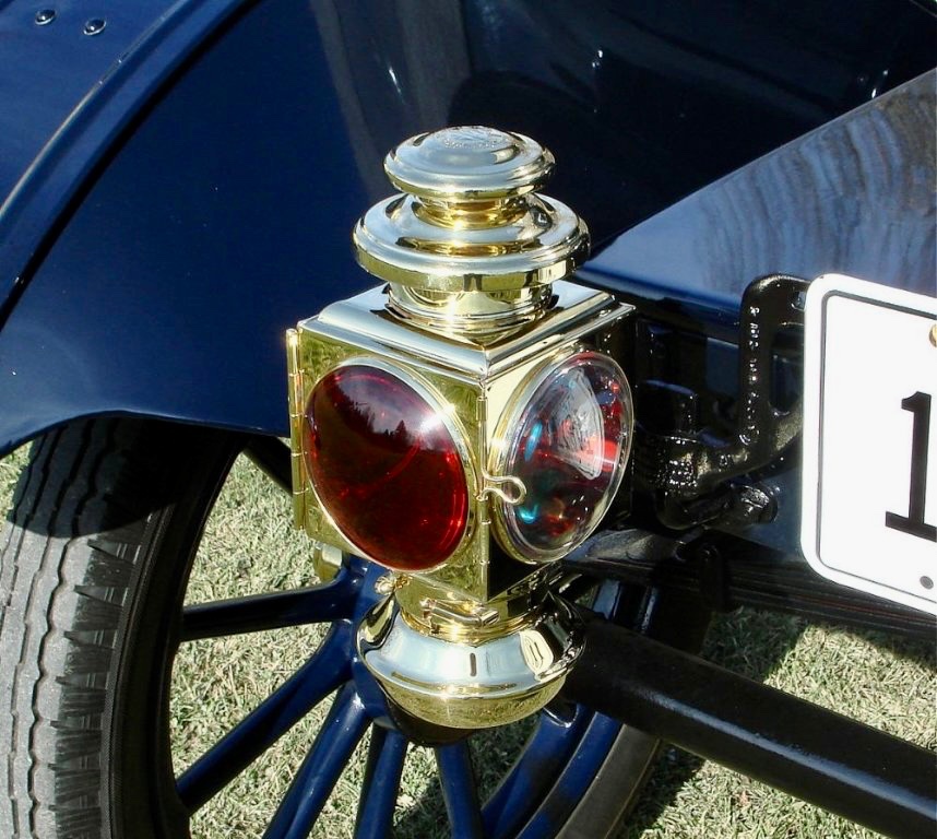

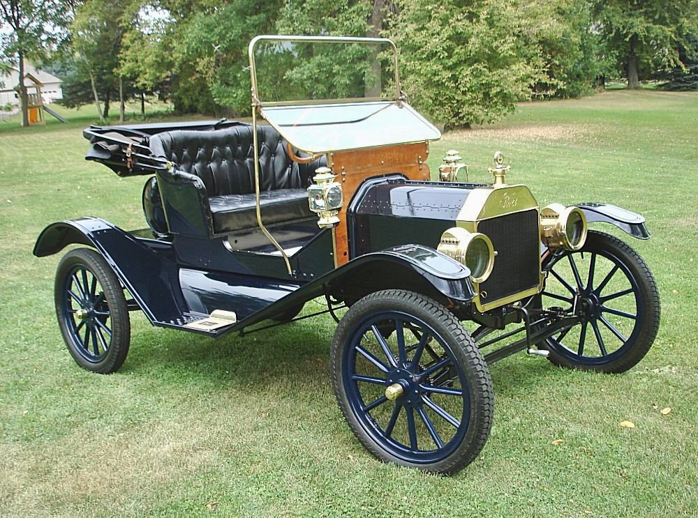

Post by hull 433 » Mon May 30, 2022 11:29 am
Hey Jay,
People with dark blue cars have posted a few of their recommendations. They are:
Mercedes DB-332 (Diamont Uno 4635 A)
Mercedes DB-904
All of these look great, and from photos of the cars posted you could use them with confidence. Keith Townsend's beautiful fore-door 1911 is DB-332 (also known as Diamont Uno 4635 A), while Roger Byrne's handsome runabout is DB-904. You might consider DB-904 for a car in the 1913-14 range (wheels and body, the rest black) or one of the other dark blues like DB-332 for an earlier 1911-12 car. They might be able to give their experience using the colors.

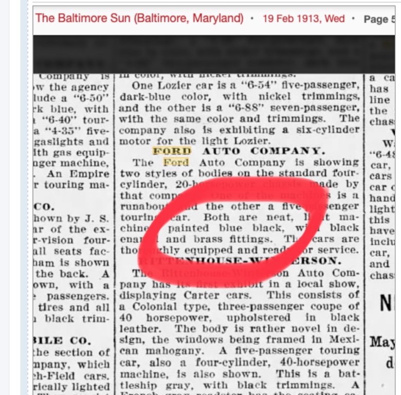

Here are some photos of Keith and Roger's cars that they posted here before. Also, a 1913 article describing brand new Fords as "blue black, with black enamel and brass fittings."

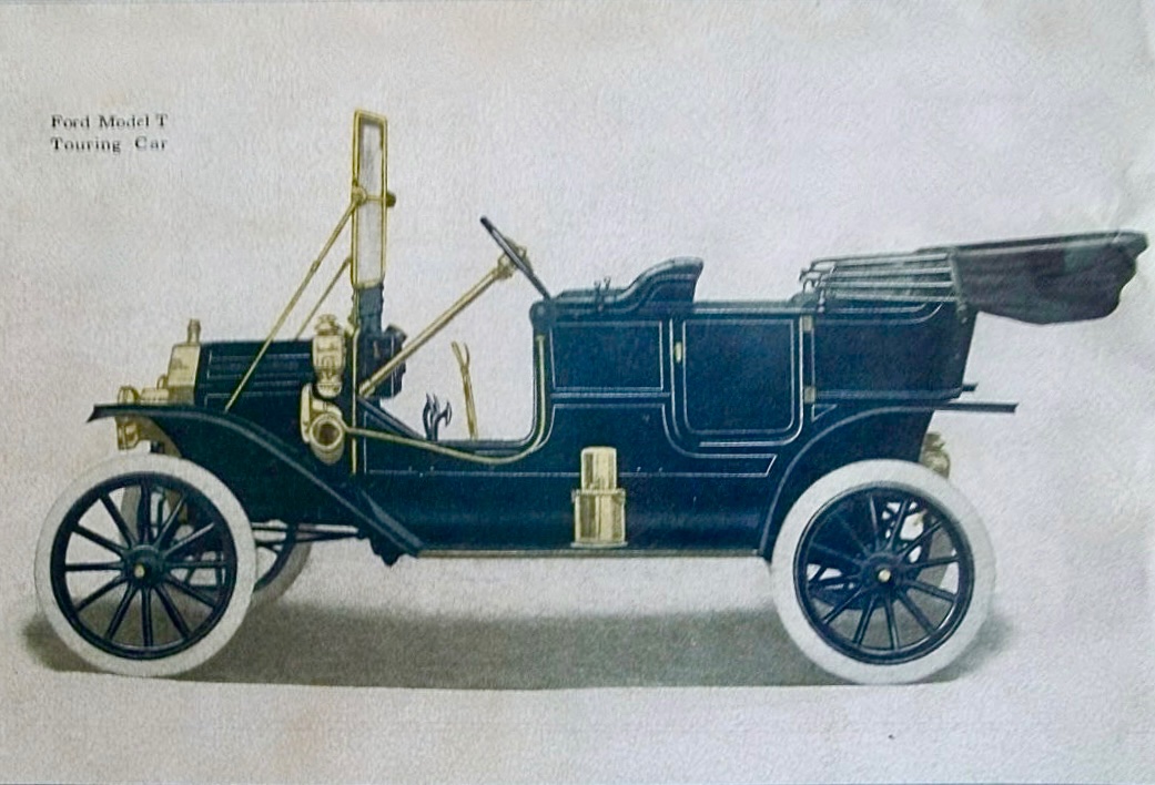

Post by hull 433 » Mon May 30, 2022 8:47 pm

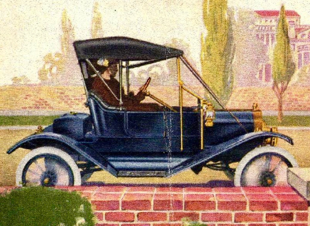

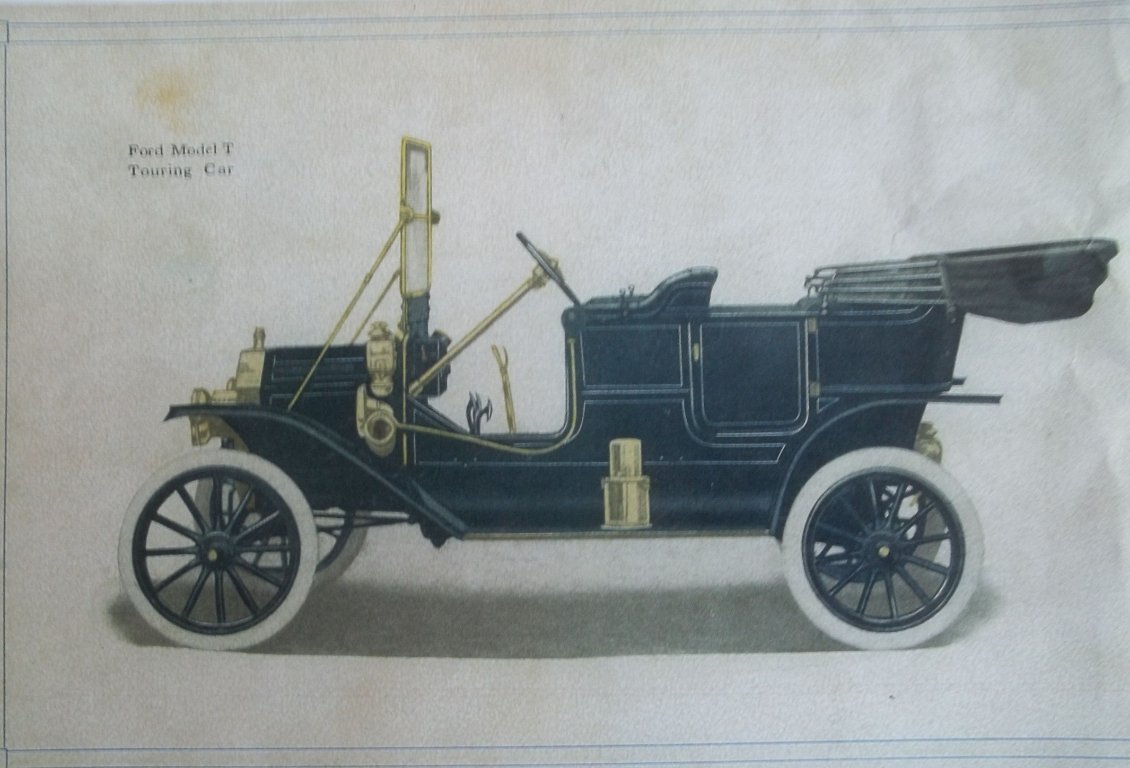

Here's a cleaned up version of that beautiful torpedo and touring.
Russ, the 1913 article describes blue-black, so could there have been a slightly lighter shade used in, say, 1911-12?

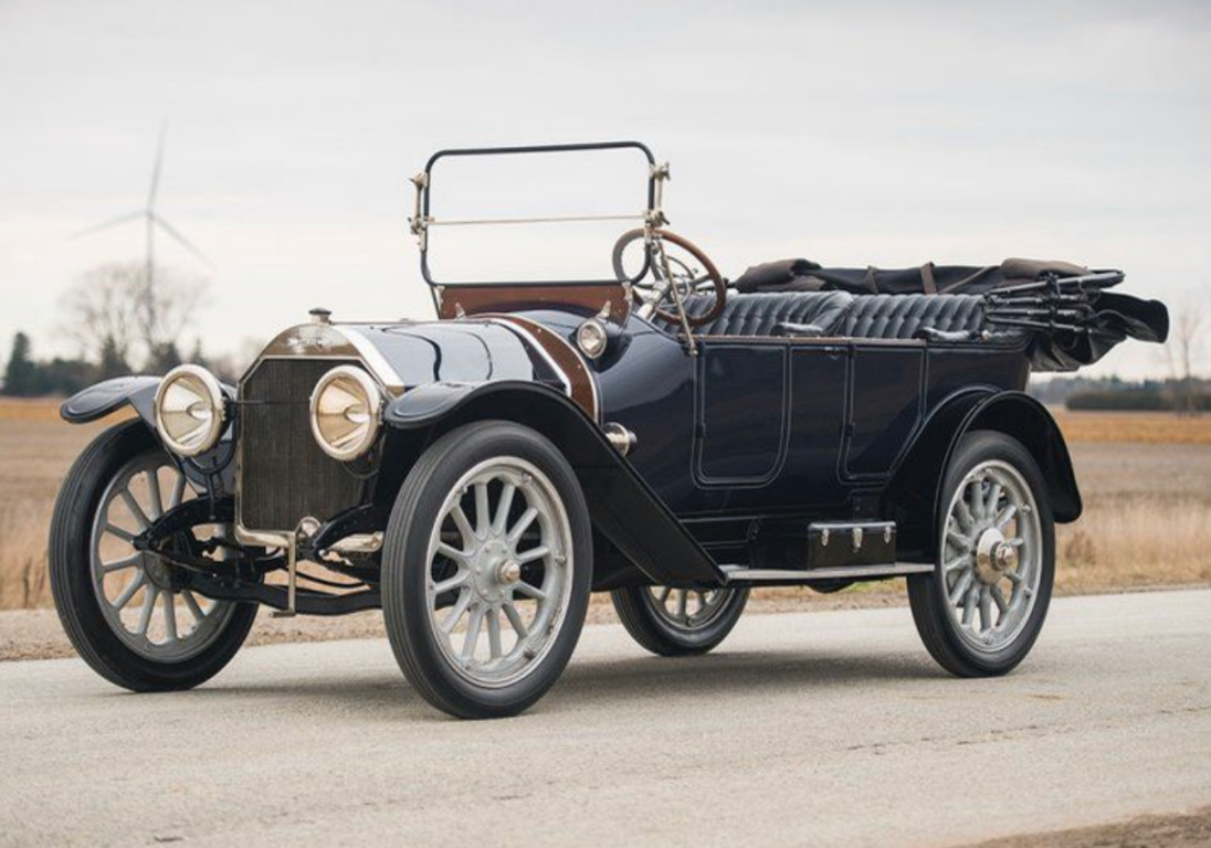

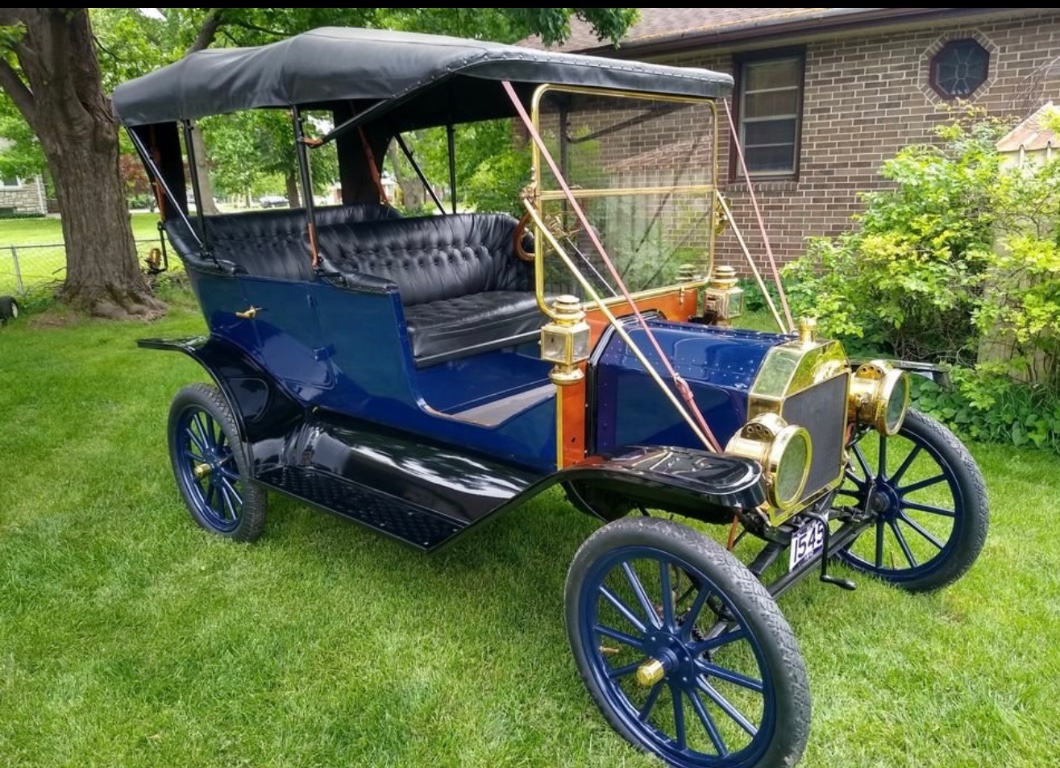

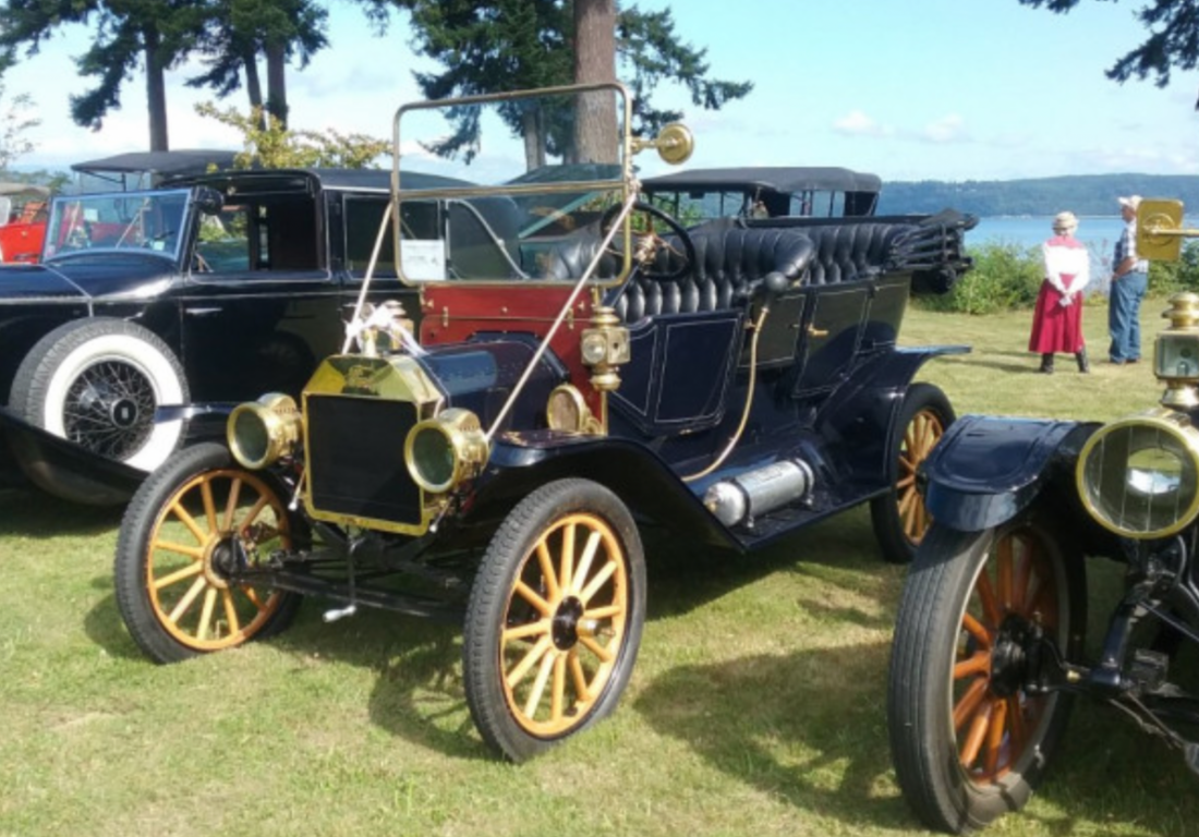

Here is a beauty, IMHO. Sorry, can’t give credit , just a pic I stole. I’ll say it again…..why would a company paint a body an almost black color?? It just makes no sense. Age and oxidation make the few surviving examples appear so dark. Again, just my opinion. Still waiting for slim to post some FoMoCo archival info. Thanks for your examples, Russ!
. I

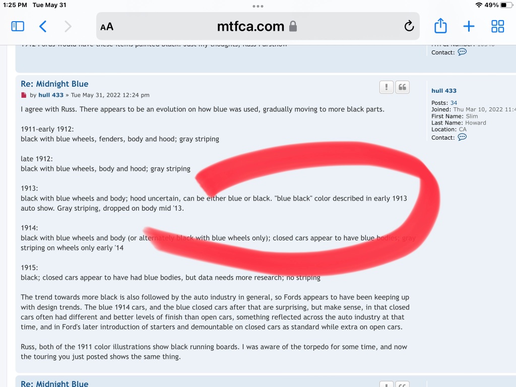

Post by hull 433 » Tue May 31, 2022 12:24 pm
I agree with Russ. There appears to be an evolution on how blue was used, gradually moving to more black parts.
1911-1912:
Overall blue except frame and axles, gray striping
1913:
Blue wheels and body; hood uncertain, everything else black. Early year cars striped gray, later year cars drop stripes from body

Regarding the artist's rendition of the 1911 touring, I have never seen a period photo of a 1911 that shows pinstripe on the flat panel below the seat riser, nor "boxes" pinstriped on the hood. The drawings also show what looks like brass plated steering column and hand brake. I believe that artistic liberties were taken to enhance the aesthetics of the illustration, including the brighter paint color, to make the picture pop!
The 1912 Ford parts book list fenders and running boards for 1911 and 1912 available in blue. Black is not a option listed.
On wheels, they ask that you specify color: red, green, blue or gray (French or Pearl).
That information tells me that 1911 and 1912 cars were ALL blue. I don't believe black fenders, running boards, and splash shields were an option in 1911 and 1912. If someone wants their fenders, running boards, and splash shields black, that is would be their choice, although historically inaccurate in my interpretation.
I'm not picking a fight with anyone, it is just my interpretation of the Ford facts and I chose to be as historically accurate with my 1911 as possible.

Post by hull 433 » Tue May 31, 2022 5:01 pm
Had no idea how frisky paint can get.
Keith, great info on the run boards. Body color makes more sense. I adjusted the list above, but to reiterate, here's the revised version again. Let me know if there are anythings that can get refined.
1911-1912:
Overall blue except frame and axles. Gray striping
1913:
Overall black except blue wheel and body, hood uncertain. Gray striping, later year cars on wheels only.
If someone has a 1913-14 parts list, check the hood and fenders to see if any color for those parts is mentioned. I kind of get the feeling that the 1911-12 cars were one thing, and the 1913 maybe 1914 cars were another. But there are lots of questions about when changes got made, whether running of year end, and how these changes reflected the assembly process on the dawn of mass production.

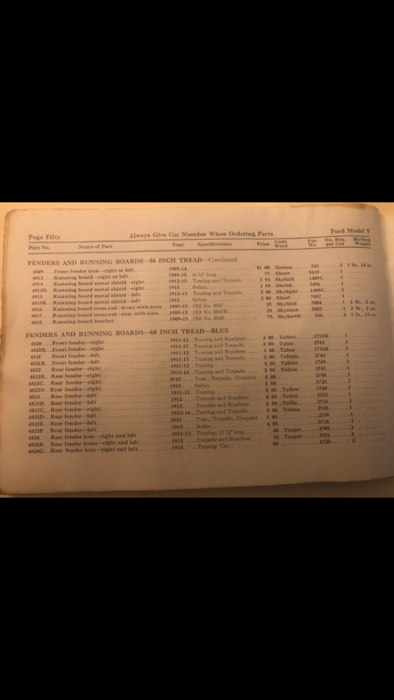

Post by Corey Walker » Wed Jun 01, 2022 11:35 pm

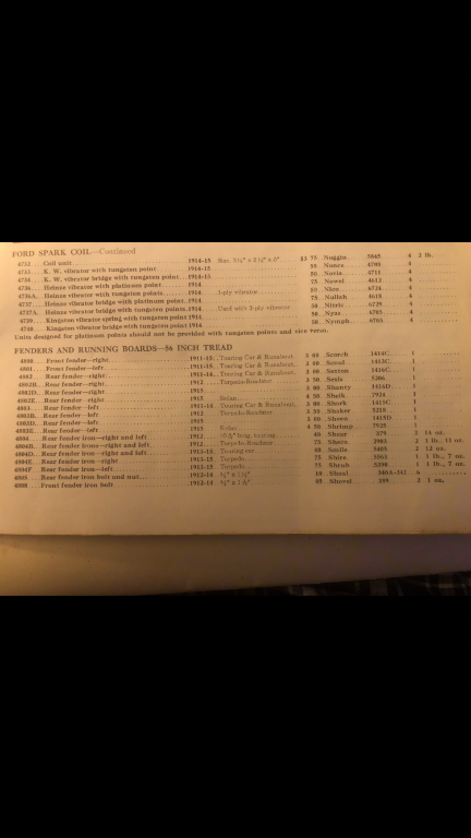

Price list of parts doesn’t specify a color for 56” tread but specifies blue for the 60” tread all years. The hood section reads,”specify color”.
