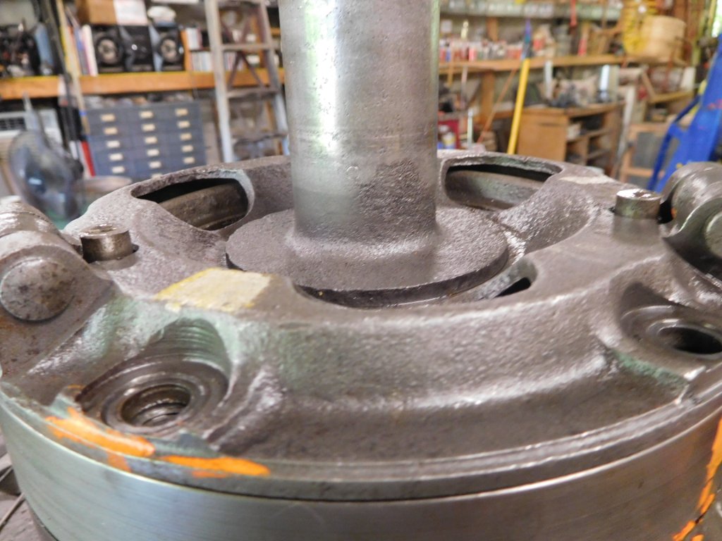

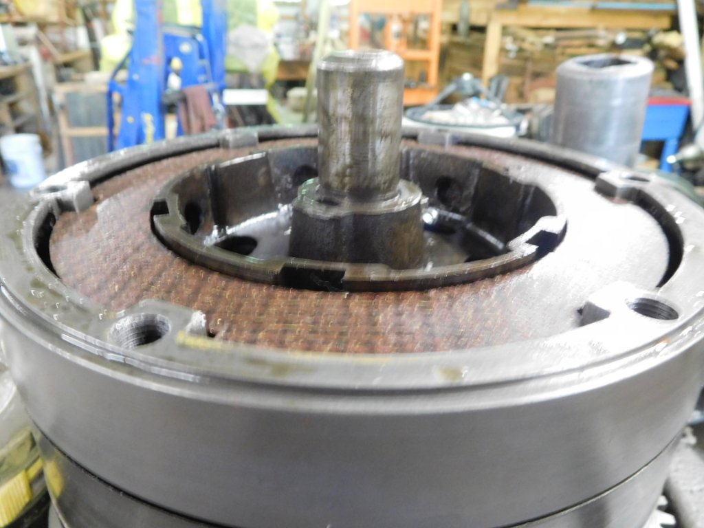

I have just replaced a faulty aftermarket clutch with a NOS Watts clutch which was made when Mr. Watts had that business. I have used several Watts clutches in the past and had no problems with them. I always set them up using the 13/16" measurement under the fingers, and that always worked out fine, within 1/2 turn or so. I installed this clutch following RV's instruction sheet and began to adjust the three fingers, but the spring was compressed to 1-1/2" before I reached the 13/16. Yes, I'm using a push ring with shortened pins. Mine measure .922". The clutch pack (see pics) is about 1/8" below the top edge of the brake drum, and with the drive plate in place, the push ring pins extend about 1/8" above the drive plate. I'm hoping that someone with a lot more experience with clutches will be able to see something wrong here. I'm thinking that I need to shorten the push ring pins even more in order to get things where they need to be. Thanks for any help.

Yes, you need to shorten the pins for a Watts clutch because the clutch pack is thicker. Mine (with the 8 steel discs called for in the instructions) is 1-1/4" total thickness.

With the drive pate in place, I can grab the ends of the push ring pins with pliers and move them up and down 1/16" or more, so the ring isn't being bound up.
