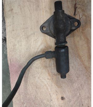

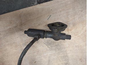

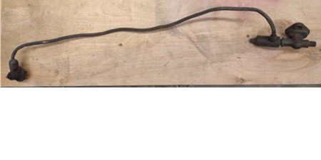

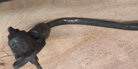

What is this and is it to a late Model T?
TBones12
Topic author - Posts: 183
- Joined: Tue Jun 18, 2019 2:20 pm
- First Name: Robert
- Last Name: Poane
- * REQUIRED* Type and Year of Model Ts owned: 1916 Hack, 1910 Touring, 1914 Touring, currently a Touring 1912, 1912 Torpedo Roadster
- Location: Baltimore
Looks like one end belongs on the transmission post?
- Attachments
- thing 1.jpg (24.18 KiB) Viewed 1139 times
- thing 4.jpg (24.99 KiB) Viewed 1139 times
- thing 3.jpg (16.41 KiB) Viewed 1139 times
- thing 2.jpg (12.91 KiB) Viewed 1139 times
- Posts: 8640
Re: What is this and is it to a late Model T?
That looks like some type of "mag post" auxilliary outside oiler. It would have collected oil at the magneto terminal post and delivered it via a tube to the front of the engine.
