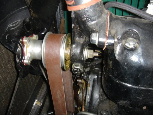

My ‘26 Roadster came with a water pump. It also has a rough and falling apart belt that is 1-1/8x36. We figured out how to adjust the fan assembly to get the old one off, but the new one is just a bit too small. Anyone else have this? What is the first, second, last pulley to put the belt on?

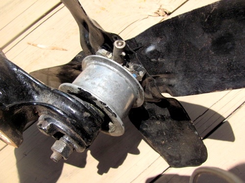

To adjust, loosen the eccentric by slightly loosening the lock nut and with a wrench holding the fan shaft flats, then rotate to eccentric, using the lug, to drop the upper pulley down.
Slip the new belt over the fan, then fit the new belt to the crank pulley first, you have to remove the ratchet on the crank handle to fit a new belt, very hard to snake it past that ratchet.
Next, fit the new belt over the water pump pulley, with the new belt now loose over the fan pulley.
Finally, adjust the fan pulley eccentric to pull the belt snug, not too tight. You should be able to pull the belt over the pulleys with about a 2-3 lbs. pull holding the belt between thumb and fingers.

Mine doesn’t have that set up.

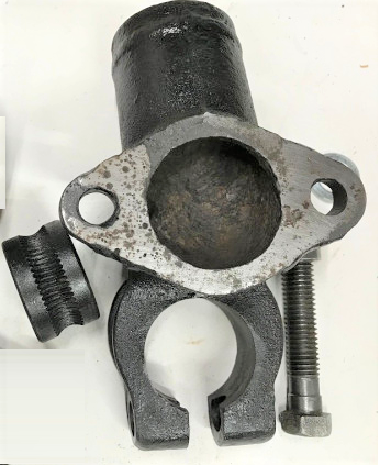

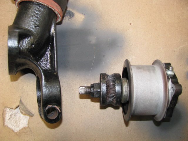

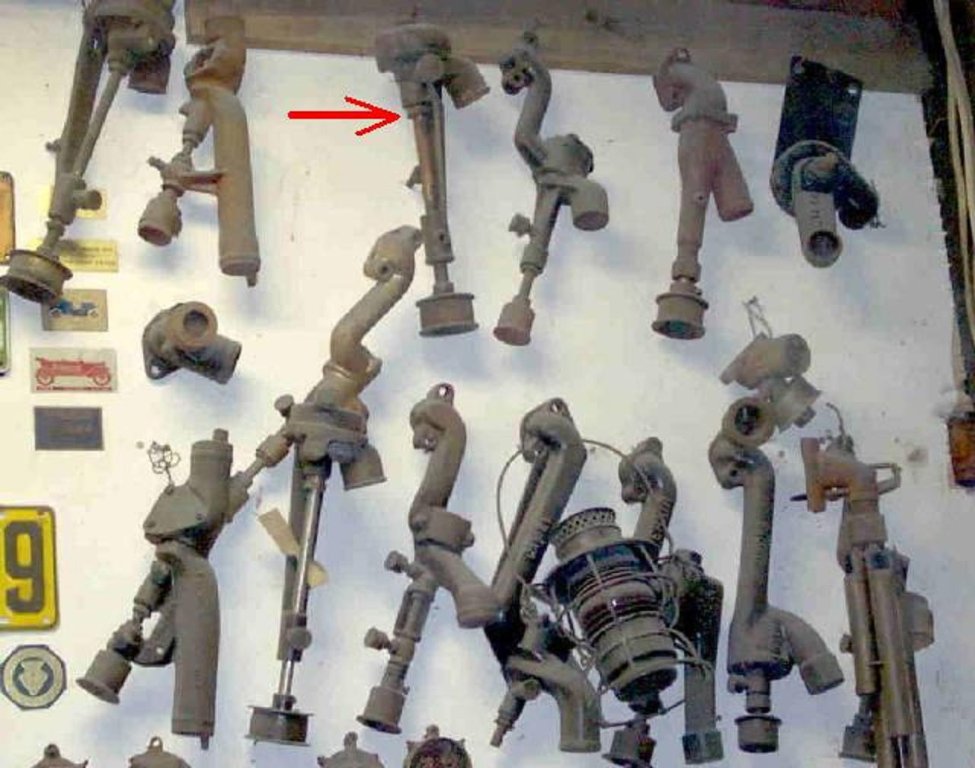

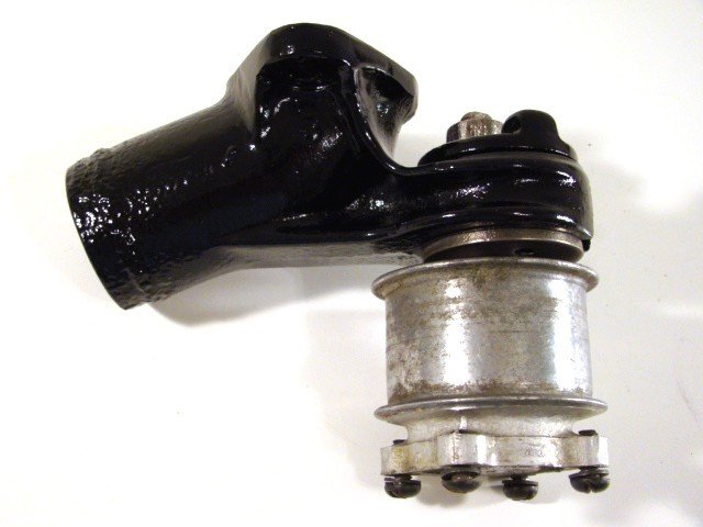

Be aware 1926 Model T's had two different types of fan belt adjustment eccentrics.
Make sure you know which type you have before you start wrenching?

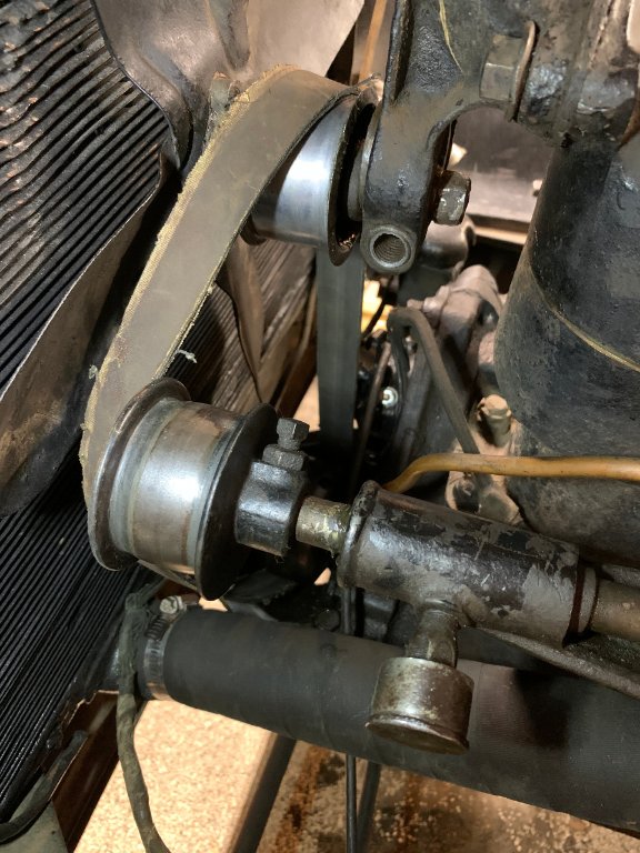

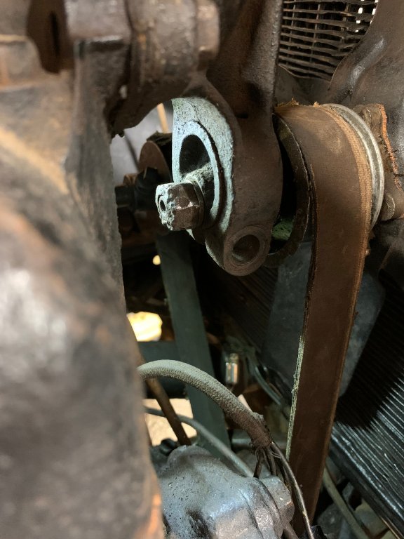

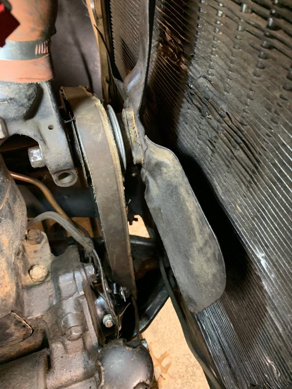

Here's some pictures that I couldn't post this weekend. The water pump pulley is 7-1/4" in diameter.

Your fan pulley adjuster bolt is missing. See Rom Patterson's post for the bolt location. It is unlikely that you will be successful without the adjuster. It has a worm gear on it to turn the eccentric. I may still have an extra bolt if you need one but I replaced it due to wear. The good news is that your fan pulley mount is not broken, which is common.

Oh, you mean the larger bolt that runs horizontal? Yes, I have that. It's just not in the picture.

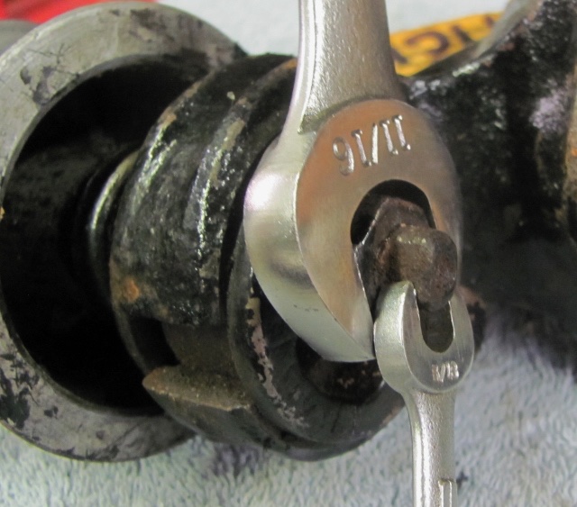

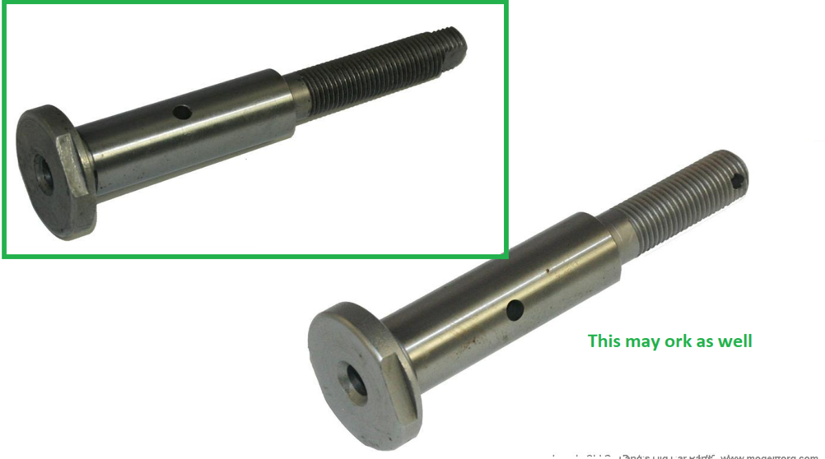

You have an early 1926 Water Outlet. The long bolt is used to rotate the concentric hub (like a worm gear). Later 1926 concentric hubs were smooth. You need to be careful in tightening the long bolt as making it to tight might cause one of the jaws of the water outlet to break.
The fan shaft bolt holding the fan pulley also should look like this ( green box)

The plot thickens..... When I got this the shaft bolt doesn't go all the way through like yours. The belt was still snug. I suppose this will require removing the radiator?

From looking at your pictures, there is one thing which might help. First put the fan pulley back in place and adjust to the lowest and closest to the left of the car. Then install the belt to the fan pulley and water pump pulley. If you have the original crankshaft pulley without the lip, you might be able to slip it over that pulley.

You're saying that the shaft fan bolt should be towards the left rather than the middle like mine is?

So, I think I'm figuring this out.....maybe. We spent a lot of time turning the nut that goes on the fan shaft thinking that is how the tension is adjusted. Apparently that's not it? I'm starting to think that the function of that is to lock the tension. True? Then the lower, horizontal, bigger bolt is actually what adjusts the tension?

Correct! The nut on the fan shaft is just to hold the that pulley onto the concentric hub. The long bolt is to set the tension

Post by CatGuy » Tue May 31, 2022 5:00 pm
Eric Sole wrote:
Tue May 31, 2022 4:53 pm
Eric Sole wrote:
Tue May 31, 2022 12:48 am
If you turn the excentric clockwise, viewed from engine side, the belt moves slightly away from the timer and it's wires. This gives a little more margin for wire movement as spark is adjusted.
I didn't realize that you had an early 26 water outlet when I wrote my comment. The threaded adjuster on that type automatically takes into account which way is best to rotate the excentric!
I didn't know, either. The car is legally registered as a '26, the frame is a '27 and the engine is a '28. That is, from what the numbers tell me......

If you cannot find the correct belt, go to your local NApa store and see if they have a serpentine belt that matches width and length. Put it on with the smooth side against the pulleys, they are designed to run with pressure against the smooth side.

Post by CatGuy » Tue May 31, 2022 9:47 pm
I got it on. It took a brake tool to pry it on over the pulley, sort of like putting a tire on a bike rim. It feels tighter than I think it should be, but I can still turn the fan without the belt moving.
