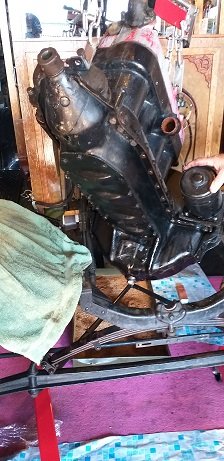

Re: How do you remove brake pedal?
Update - Motor and Trans are out.
I managed to leave the steering as is, the starter motor and generator as is and didn't touch the pedals at all!
Removed the carby, once engine was broken free adjusted the lift for greater tilt bit by bit.
When inlet manifold was forward and close to steering shaft (right hand drive) we levered the other side of the engine (using a bar) above the chassis rail with the motor on a steep angle (see pic) then twisted the engine clockwise until the pedals were low enough to clear the firewall and moved it out.
Took a bit of head scratching and trial and error.
If the steering was removed it would be much easier and I might have to do that for the refit.
In the next couple of days we will tackle the speedster and see if that is any easier. It doesn't have a generator on it (block off plate) plus the pedals are much closer. I will find out if there is less or more room on a steel firewall.
Here is the exact angles for the last stage of the removal.
download/file.php?mode=view&id=130629
