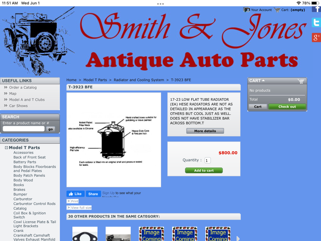

You may want to call Smith and Jones to ask if they have these radiators in stock. Both high and low. I bought one a few years ago for the 23 and it is still fine. Differences in construction from Ford, and Brassworks as not a true replica .
The inlet is centered unlike the slight off set of Ford, so the upper hose takes a bend. But it is USA made, flat tube, and fit the frame ok, no center bar across the bottom of the core, but sure better than a worn out steam making radiator!

Found a new low cowl radiator ready to ship. Should be here in two days! Many thanks for the comments, suggestions, etc.
