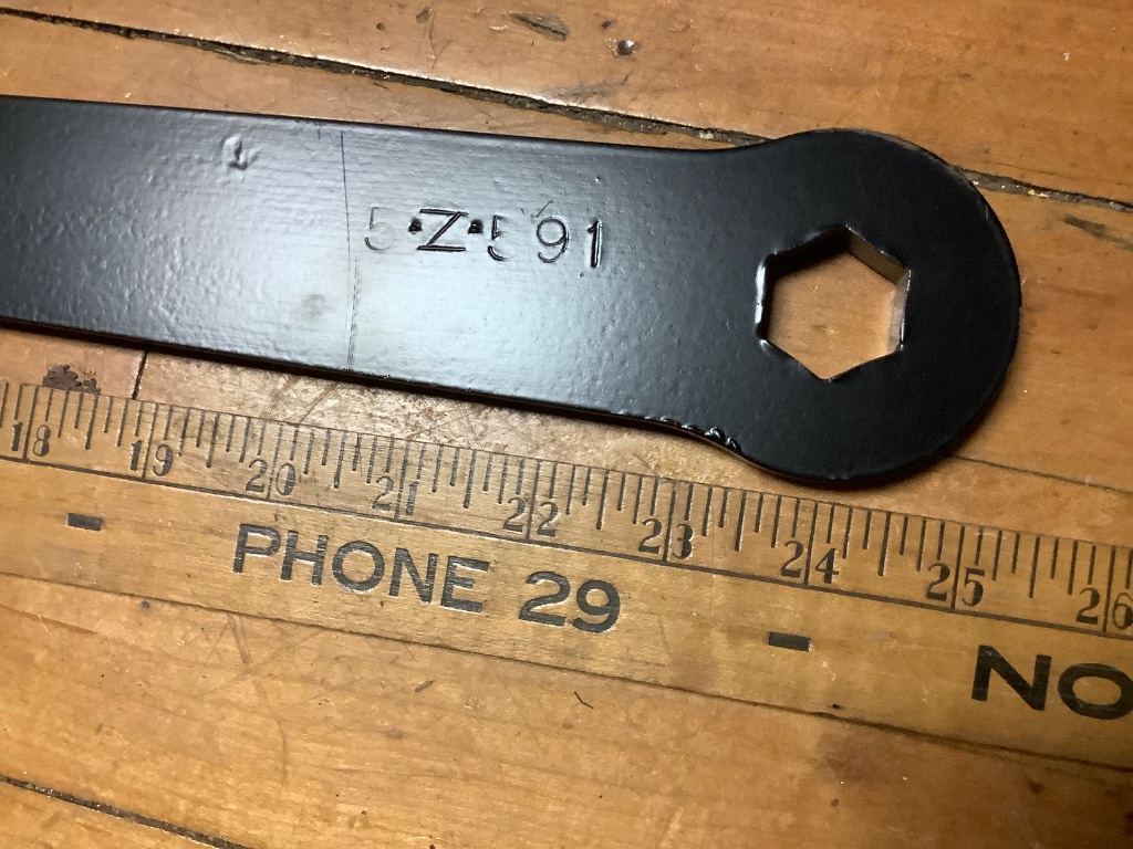

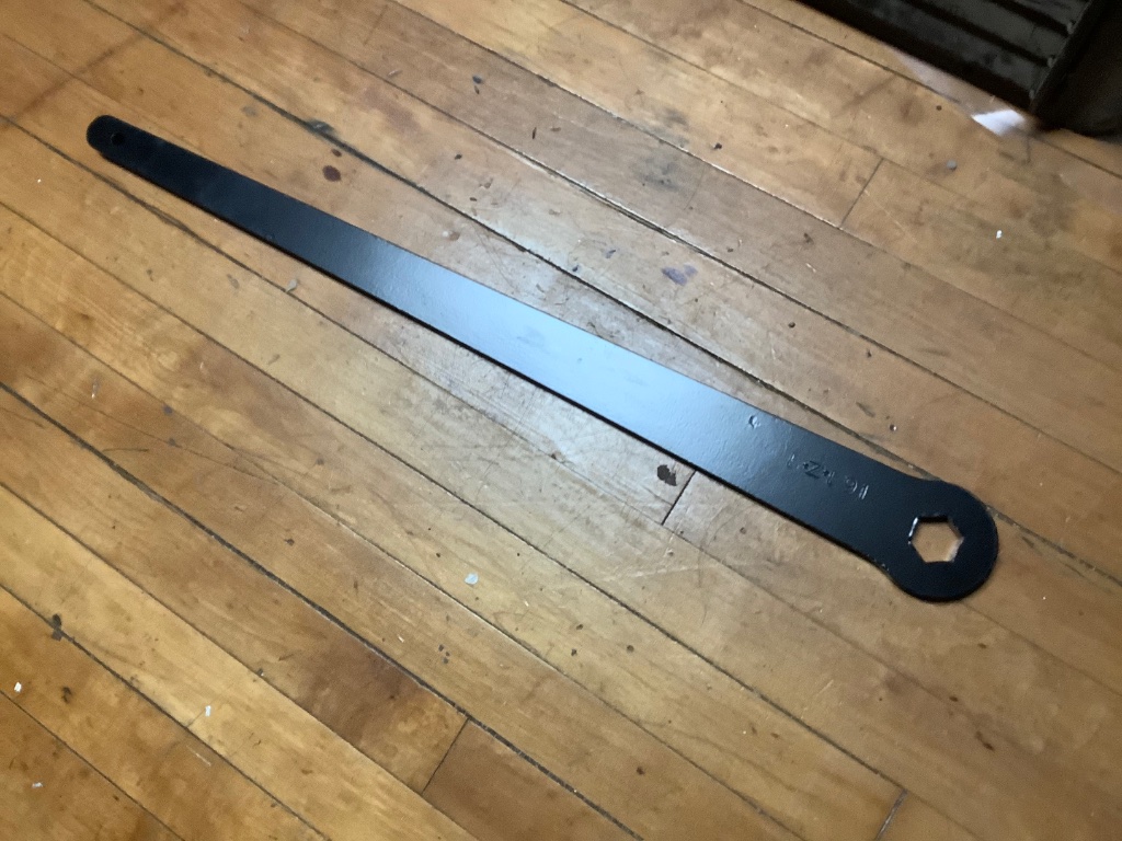

Re: Rear wheel REALLY stuck
In the ‘ forwhatitsworth’ department. This a copy of the original Ford axle nut wrench, the 5z tool. Joe Andulics made it for me a long time ago. Notice the length. And you KNOW the service guy stood on it to tighten the nut. If it broke or stripped the threads, it wasn’t a big deal because a new axle shaft was probably a buck and a half to have installed. way back then the torque value was “ just before it breaks”
I’ve been blessed with a lifetime supply of FoMoCo axle keys. Some people think you can take a new one out of the fancy ford script bag and use it. I’ve seen some horrendous ones over the years. You need to take the time to shape them right and stone them for a correct fit, which is certainly not hammered in. If memory serves, I believe you had one in a shaft you couldn’t get out. If you have an oversized key in the axle AND hub, you may be in for a bit more than just a hair dryer to get it off. I’m wishing success, whatever the problem.
