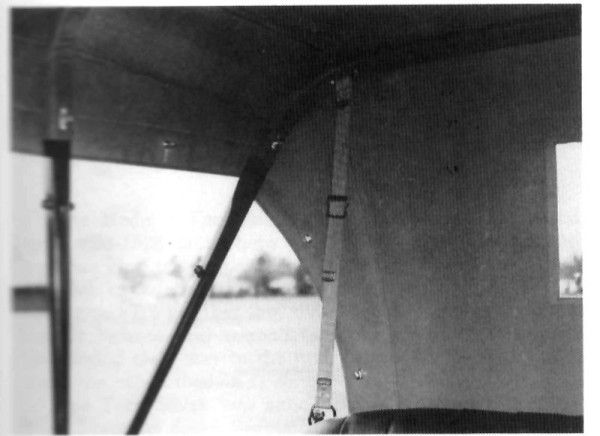

Anyone here have a description AND a very good and clear picture what the rear curtain or rear top straps look like and how they attach to the body and to the rear bow on a true 1919 touring. Also what material these straps are made of, the width and thickness and also their length.

Here is a link to a thread from the Old Forum: http://www.mtfca.com/discus/messages/17 ... 1321379147
The photo above is from page 285 of Model T Ford (McCalley), and there is also a nice photo of an original set of straps on page 276. They should be black, woven cotton webbing, and I believe they are 1" in width and I have the same question as to their length.

Re: 1919Touring rear curtain straps
The late RV Anderson manufactured fairly faithful reproductions of the front and rear black cotton webbing straps complete with hardware. The webbing is thicker and has a coarser weave than factory originals.
They are available from Lang's.
Front bow to windshield hinges:
https://www.modeltford.com/item/3314WS.aspx
Rear curtain straps:
https://www.modeltford.com/item/7831SWB.aspx
RV Anderson made-up a set of straps for my father's 1917 touring. However, my dad gave him the original factory hardware from his car (D-rings, buckles, hooks, etc.) so the only thing that is new is the webbing, the metal end-caps and the rivets. The rest is original factory.
Note, original rear straps are just long enough to pass through the buckles. The strap in shown in Joseph's post is too long and a waste of webbing.
