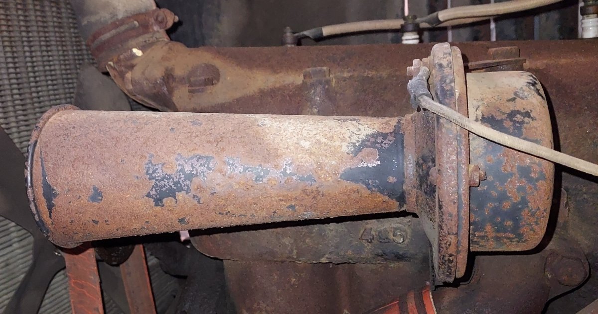

Post by Humblej » Fri Jun 03, 2022 5:40 pm
Battery horn as found on my unrestored1924 T.

Post by speedytinc » Fri Jun 03, 2022 6:46 pm
This is the correct horn, mount & all for your electric 22.

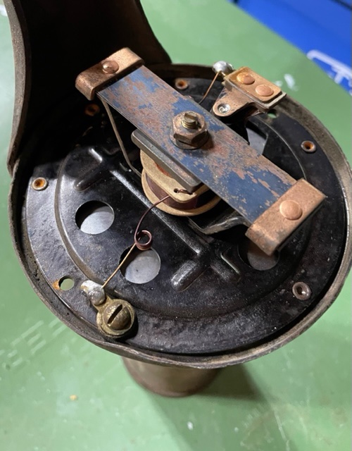

Post by Steve Jelf » Fri Jun 03, 2022 10:01 pm

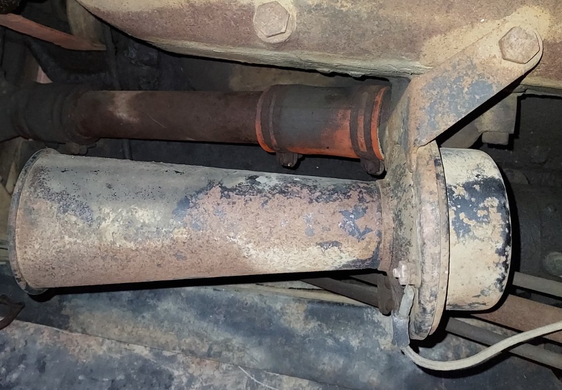

Post by George Mills » Fri Jun 03, 2022 10:24 pm
I posted this a few weeks ago...
Folks said it was a battery horn.
Posts: 7133
Re: Looking for horn information.
Post by Allan » Sat Jun 04, 2022 12:47 am
That's a battery horn all right George, with a bracket for a 26-7 model with the coilbox on the motor. It looks to be a nice one.
