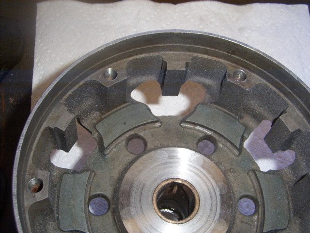

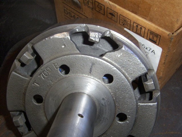

Removed 18 grams from the brake drum photos
Post by RGould1910 » Tue Apr 09, 2019 1:23 pm
I was careful not to disturb stuff on the inside.
ChrisB
Posts: 409
First Name: Chris
Last Name: Brancaccio
Location: Calgary AB
Re: Removed 18 grams from the brake drum photos
Post by ChrisB » Tue Apr 09, 2019 1:27 pm
Richard, was it balanced after that?
Chris Brancaccio
MTFCA Webmaster
MTFCA Forum Admin
RGould1910
Posts: 1244
Last Name: Gould
Location: Folsom, CA
Post by RGould1910 » Tue Apr 09, 2019 1:33 pm
Forgot to add the balancing was done with the driving plate attached and after other stuff was done. It balances very well on a static balancer.
RGould1910
Posts: 1244
Last Name: Gould
Post by RGould1910 » Tue Apr 09, 2019 1:36 pm
Yes Chris it was a back and forth job of removing stock and placing it on the balancer until there was no heavy side and the the brake drum/driving plate assembly came to rest without favoring a position.
Posts: 7312
Post by Allan » Thu Apr 11, 2019 6:08 am
Richard, did you take anything off the driving plate?
RGould1910
Posts: 1244
Last Name: Gould
Post by RGould1910 » Sun Apr 14, 2019 4:15 pm
No Allen I only took stock off the brake drum. I did have have the driving plate attached of course but there was no place I could take off any appreciable amount from it.
RGould1910
Posts: 1244
Last Name: Gould
Posts: 7312
Post by Allan » Sun Apr 14, 2019 6:28 pm
Richard, I asked because sometimes it means less of a hole has to be dug in the drum. If I find that much needs to be removed I juggle the driven plate around to a different position to see if that makes any difference to the out-of-balance before starting o the grinding.
RGould1910
Posts: 1244
Last Name: Gould
Post by RGould1910 » Mon Apr 15, 2019 8:44 am
I rotated the driving plate to where there was the least run out of the tailshaft before balancing.
