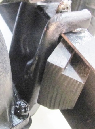

I'm in the process of an engine swap and both cars have a block of wood under the trans mounts inside the chassis rail.
What a pain as the vertical bolt cant be removed with the wood in place. I manage to chisel then smash the wood away in the first car after an hour or 2 but was impossible to do in the 2nd after a frustrating period however I managed to pry the mounts over the bolts in the end.
I would like to save the next person grief and leave them out. The trans bracket sits steel on steel anyway, what are these blocks meant to do?
Has anybody tried a layer of hard strong rubber between the mounts and the top of the chassis rail?

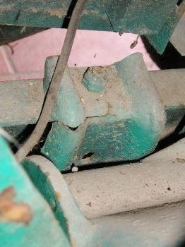

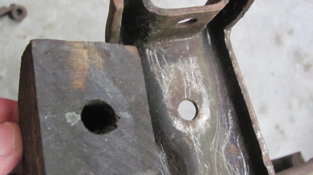

Wood blocks are there for a reason. Pre 1926 ears are prone to work hardening and breaking over time, many a pre 1926 engine oil pan I have seen have a broken or cracked ear. Given the failure rate of ears I would not deviate from the Ford recommended mounting, using the wood blocks, horizontal bolts snug, vertical bolts tight, cotter pins, castle nuts, the whole 9 yards. That being said, the Ton Truck engines used a different mounting method. No wood blocks, no horizontal bolts, and a spring like the radiator mounting spring on top of the ear. I have studied the TT engine wood block drawings at the Benson Ford Research Center and found that the early TT engine mounting used the same method as the car engine mounting at first but with a larger block due to the taller frame rail, then eventually eliminated the block and horizontal bolt and added the spring on top of the ear. Even with that change to mounting, my 1924 unrestored TT has a broken ear too.
Unlike a conventional car that has engine mounts that are rubber to isolate the engine from the chassis, the T engine oil pan is actually part of the suspension and ties the front and rear wishbones to the chassis. The suspension forces, plus the frame twisting, plus the engine vibrations, all place loads on the oil pan ears.
TT engine mount as found on my 1924 Ton Truck.

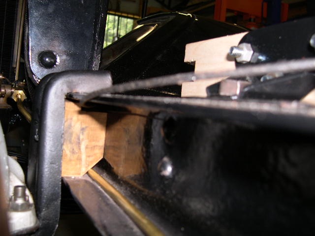

A couple things I have found that make the installation of these wood blocks and fasteners easier:
Use a pry bar of some sort to move the pan ear and frame apart a fraction of an inch. This makes it far easier to tap the blocks into position.
Some years ago I ditched the cotter pins and castle nuts and switched to stover-type self locking nuts. I am, as a rule, very keen on period fasteners throughout, but practicality rules supreme here.

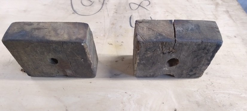

I think I have found original wood blocks in my stash of parts. I will try to find them and post pictures.

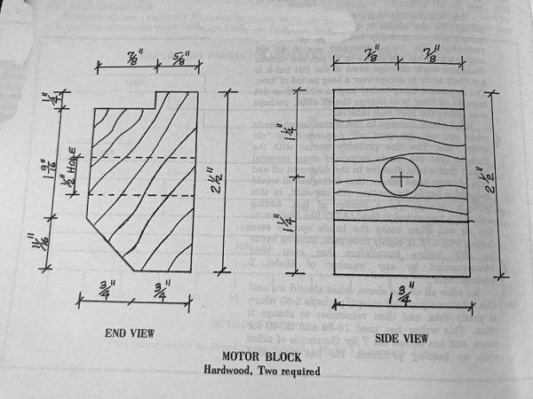

Maybe this will help

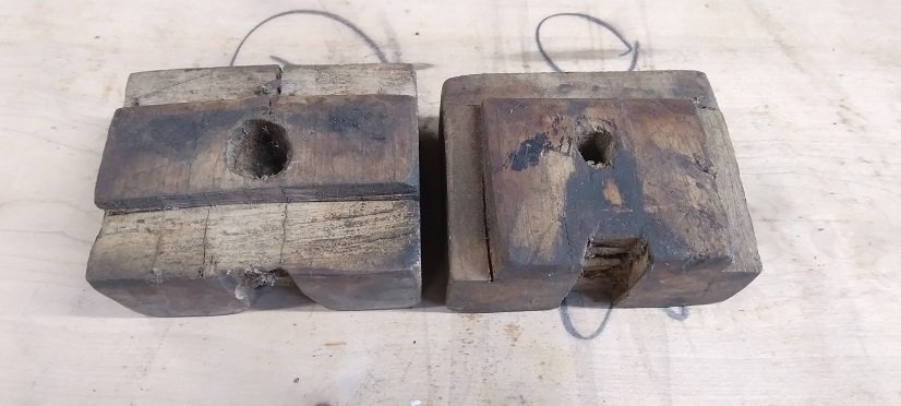

The notch at the base of the block on the passenger side is where the fuel line for the under seat gas tank is routed to prevent the fuel line from bouncing around the inside of the chassis channel. Jim Patrick

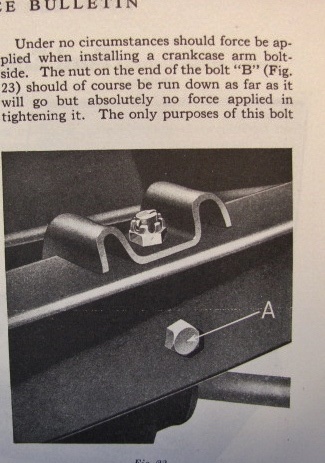

Here is that post:George House wrote: ↑Mon Jun 06, 2022 9:49 amKen, I tried to search for Herman’s advice not to use the wood blocks under the pan ‘ears’ but came up empty. Can you please provide specificity ?
By Herman Kohnke on Tuesday, February 22, 2011 - 01:54 pm:
We have for 40 years only used the top frame bolts. The side bolts do no good, only harm. If the arms are held tight, or loose, with the side bolts, and you go over any uneven ground, where the frame will twist, it can crack, or twist the arms, but what you don't see in the twist it puts on the ball cap, and the rest of the pan. Herm.
Just as much experience, have driven, restored and owned over 12 Model T's in 50 years, always have used the wood block between the frame and crankcase pan arms. No cracks also.

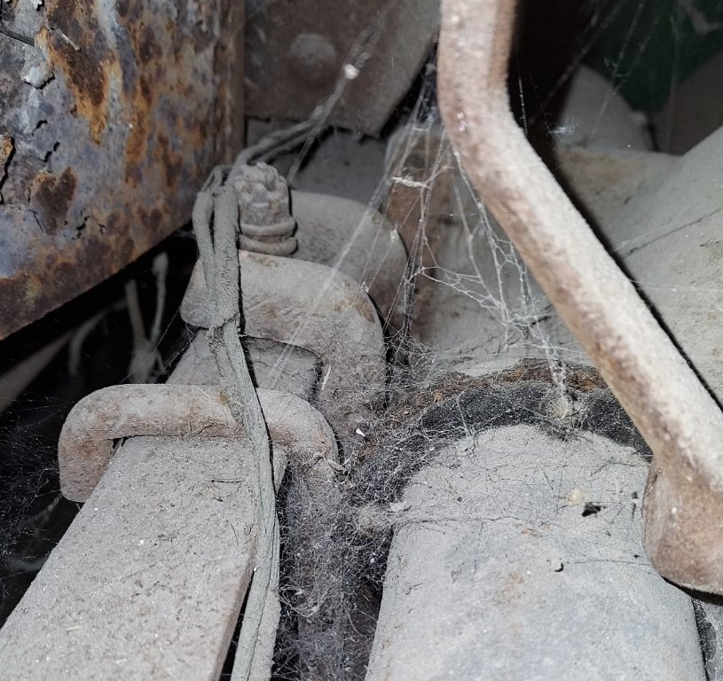

Photo off this forum, no side bolts or wood blocks......just picturing the results of non- Ford assembly.

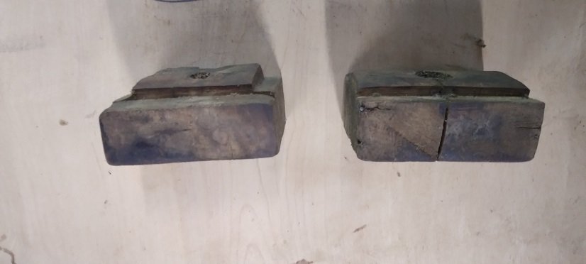

I think these are original wood blocks for the tranny mounts. What do you guys think?
- Posts: 8653
Re: Is there need for block of wood at trans mounts?
I believe that Ford would not have hesitated to delete the blocks, bolts, and the costs and labor of making, stocking, and installing them if they were found not to be important. They are meant to limit side-to-side movement of the engine assembly in the flywheel area. They are not mean to be a solid, inflexible joint, and they aren't. The oil pan assembly is a stressed member in the Model T design. It has to absorb engine torque forces, engine vibration, thermal stresses, stresses arising from frame flexing, road pounding delivered directly to it via the front wishbone, and considerable forces delivered from the rear axle that result from drive forces, road pounding, and braking stresses. All this on top of supporting and locating the engine and transmission. The wood blocks divert much of these various loads directly to several squuare inches of the frame side members, rather than concentrating all of them in the pan ears at and near the point where the upper mount bolts attach to the frame flanges.
- Posts: 8653
Never seen any like those.

Thanks Dan for Herman’s info and thank you Tim Juhl for the dimensional diagram of these hard wood blocks. I shall now endeavor to build 7 pairs for my Model T s. I am now persuaded they’re necessary...
