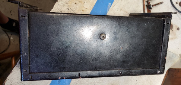

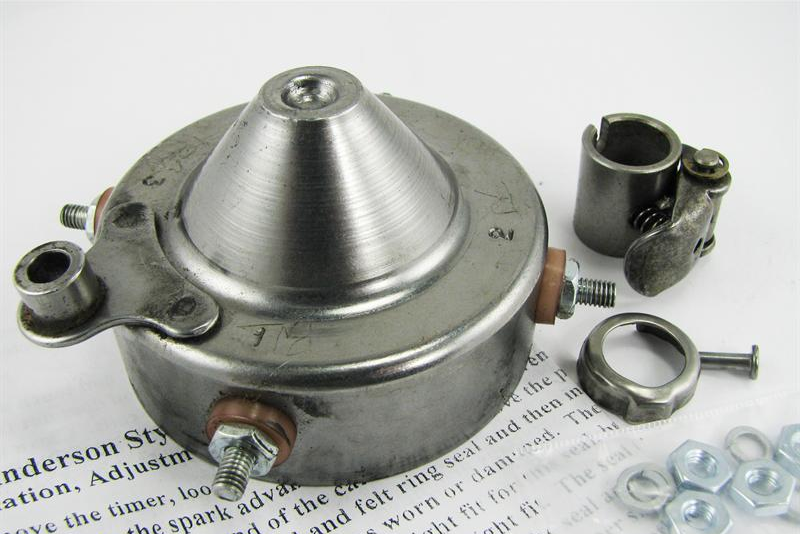

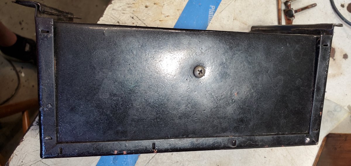

#1 Plug will not Fire
RVA23T
Topic author - Posts: 851
- Last Name: C
I cannot get a plug to fire/spark in the #1 cylinder. There is spark at the plug and can get an arc when shorting it to the cylinder head with a screwdriver and it does not change the rpm nor rough/misfire when 1 is shorted out.
Car is a 23 Touring has a 26 engine block and transmission.
Here is what has been done:
1. Installed I-timer and adjusted the timer rod.
2. All 4 coils have new correct capacitors (from Langs) installed and adjusted on my ECCT.
3. installed new insulator washers on the coil box insulators
4. checked all contacts in the coil box for positioning / alignment.
5. changed plug wire with spare and same issue plug will not fire
6. tried other plugs both installed and outside the head (grounded the head and or bolts) Motorcraft, Champ X, Edison plugs.
7. traced and checked timer to coil harness/wires for position, isolation, and not contacting ground from timer movement.
8. made sure nothing inside timer housing insuring it is dry & clean.
9. when hand cranking the engine (plugs not installed but wires attached and plugs resting on the head) to set the I-Timer, had both
suction and compression at the hole.
Ran fine after I-Timer install for 20 miles on Friday and for 30 minutes Saturday between idle and test drive after adjusting the timer rod. While/after cooling down, washed the car had some water on the block and in the spark plug bowls and, on the firewall, there was some overspray but the firewall was not washed nor hosed down and used compressed air to dry off block/engine compartment and blew out the coil box firewall holes to make sure it was dry and no water shorting things out. Could not get it start, opened the carb drain and the tank spud drain to make sure no water. I was sure I was getting fuel from smell but having just had covid smell is still not back fully, shot with starting fluid and got no reaction, check connections at firewall and timer got it to fire on 2 and 3 but not 1 and 4 which allowed me to get it back into the garage.
I am missing something but i can't think of where to go next except a compression test. Any suggestions would be appreciated.

Did you get any water on the timer? If you are getting spark to the plug, but not when running, then you could very well have burnt a carbon path into the wood in the firewall or the coil box. if this is so, then the current will take the path of lowest resistance. It is harder to jump the gap under compression, and it might be jumping somewhere in the coil box. Also take the advice above and make a smaller spark gap in the plugs.
Other than that, I can only think of two other things. One would be a stuck or burnt valve which will not let you get fuel or compression to that cylinder, or an intake manifold leak which will make the mixture too lean on that cylinder.
I know nothing about e-timers except that I would recommend that you always have a spare working timer with you, because electronics can go bad at any time. But I would also recommend the same thing with an old fashioned timer as well.

Thanks for replies here are some answers to your asked questions and shared thoughts.
speedytinc: I do have access to a plug tester that uses compressed air to test and has the "sand" blaster feature to clean the plugs as well. I will get My dad to dig it out and test all of them.
TXGOAT2 [color=#0000FF]Mark Gregush[/color] : Water was involved because I had to flushed radiator (block sat open all winter and spring while I worked on trans change so there was some new rust lose in the radiator) and from general washing, any leaking was corrected & when rinsing off the engine I tried to avoid the fire wall with any direct spraying. Timer has been removed, wiped off and out and found dry. Timer harness is new installed this spring while replacing transmission, driveshaft and rear diff.
John Kuehn: I will add this to the diagnostic list.
KWTownsend: coils, wire and plugs moved/swapped and it stays at the #1 position. pulling out the Coil Box and inspection added to list.
Charlie B in N.J.: Coil Box is through the firewall as a 23 should, Block has a 1926 number and has wide band brake drum. Your are the 2nd to suggest smaller plug gap so this is added on as well as the compression just to know.
RajoRacer: going to get the ohm meter out and retest the new harness& plug wires against the old harness for continuity and resistance.
Norman Kling: Thinking valve issue also but plugs were also not firing out of cylinder, the compression test should show this and rechecking with the roller timer added to the list.
John Codman: Installed I-Timer for the maintenance free factor vs a roller. Going to pull coil box and really inspect. I have spark at the top of the spark plugs just not through a plug at #1 and the 4vcoils all test excellent on my ECCT.
Will update as I go along. Thanks again

Mark Nunn
- Posts: 1289
- Last Name: Nunn
- Location: Bennington, NE
Re: #1 Plug will not Fire
Here's a stupid idea. Do you have dirt daubers in your area? One could have blocked the intake passage. It could happen.

Richard- the timer below works flawlessly and will never give you trouble...

I might have found the issue with the coil box. It is contaminated with a Phillips head screw!

Looks like the plywood in the box got more wet than I thought while washing thins off last weekend. I have zapped the 4 hole backer board and it let off a good bit of steam.
I have soldered the tabs to the bolts. Did not find any carbon tracking so it would have to have been the water retinsion in the old plywood causing the extra resistance.
It's going back together for the weekend and I'll be order the recommended plastic replacement for the wood.
Case closed & thanks for all the input.

RVA23T wrote: ↑Fri Jun 10, 2022 1:32 pmLooks like the plywood in the box got more wet than I thought while washing thins off last weekend. I have zapped the 4 hole backer board and it let off a good bit of steam.
You won't typically see the carbon tracking on the surface of the plywood. I tends to occur in the glue seams between the plies, where it can't be seen. Best to replace the plywood with the plastic rebuild kit.
