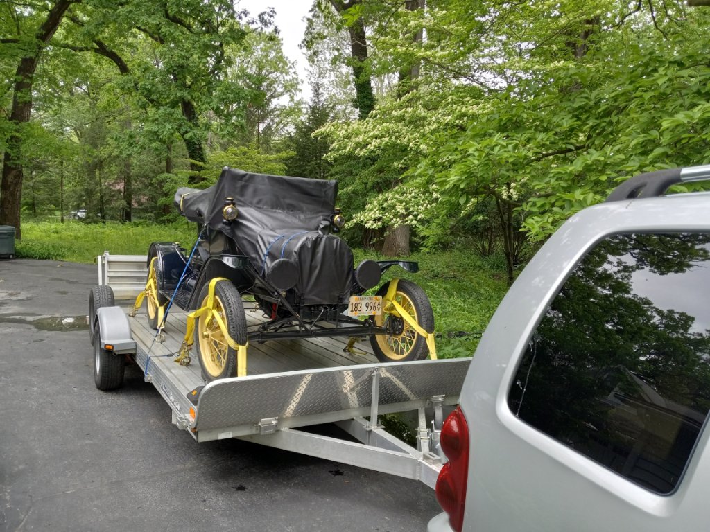

I use a small Triton aluminum open trailer to tow my 1915 runabout. I am interested in getting a 12v winch to make loading my T onto the trailer easier. I am looking for suggestion / recommendations.
