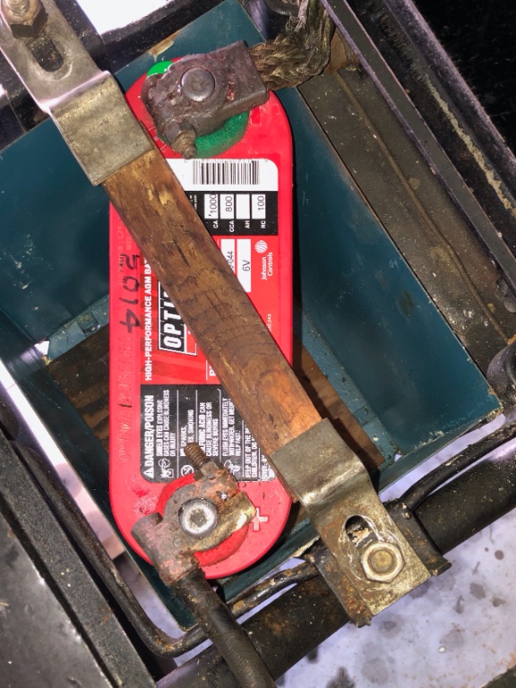

The Optima will fit the reproduction metal box just fine. This photo was test fit, later trimmed the lid for the cable and ground strap. Then fitted a 1/4"piece of plywood to the inside of the metal lid to act as insulator for the terminals.
Fastened the lid with factory clamps. Now of course with the wood liner inside the lid, one can't lift the tiny access door to add water.....but why? Optimas need no H2O

I like Dan's red top fitting. The wooden bar he uses does just the right thing. If that is a current photo, and the date written on the battery is the year it was fitted, I hope my two red tops do as well. One is in its sixth year now. They are largely a fit and forget item as far as maintenance goes.
