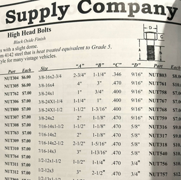

If you can determine the dia. from the brackets you have, and measure the needed length of the bolt, easy to get thick or high head bolts from Restoration Supply Company. For early cars, this co. and its catalog are very handy.

Dan, that’s it! I knew there was someone out there with the answer - thanks!
