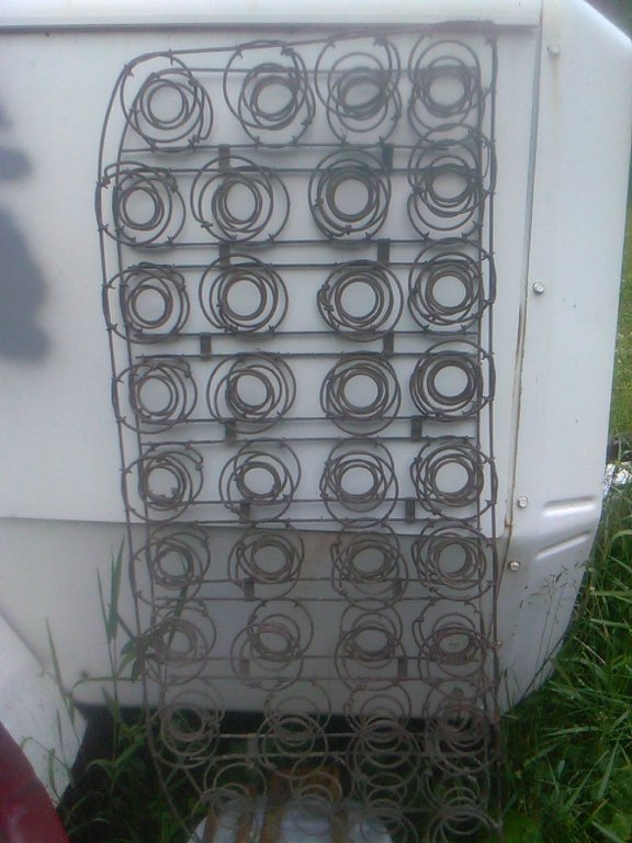

I purchased a 1916 Touring. It came with only 1 seat cushion. How do I know if it is for the front or back or will it fit either? Here is what Langs has to offer for the back rest for the front & rear:
Seat Backrest Spring, Touring and Roadster Front Backrest Item Number: TS7028 Year: 1914-1916 $99.00
Seat Backrest Spring, Touring and Roadster Rear Backrest Item Number: TS7030 Year: 1914-1916 $91.00
Much cheaper than Snyders, does anyone see a problem with these?
Does the seat I have look usable? I can get more pictures.

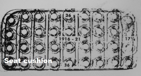

Your Lang's part numbers are incorrect, you will want the '16-'21 versions, Langs # TS7034 front, $166 and TS7032 rear, $135. These prices are the same as Snyder's and part numbers are the same.
Here are the dimensions for your front cushion spring.
to793 (600x323).jpg (126.05 KiB) Viewed 3492 times

Andy,
"IF" repeat "IF" the seat spring you show is for a 1915-25 Model T touring, it is the bottom spring that you sit (called cushion in the Lang's catalog). But just looking at the photo I cannot tell if it is a front or back seat bottom spring or what year range it fits. It might even be a seat spring to a different make of car. Dan’s illustration shows the dimensions for one spring above.
"IFit is a bottom/cushion spring from a Model T Touring -- you can put it in the back seat and then put it in the front seat and it will fit one place much better than the other as the body gets wider as it goes from the front to the back. That will tell you which one it is for but will not necessarily tell you which year range it fits. .
