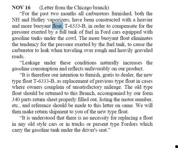

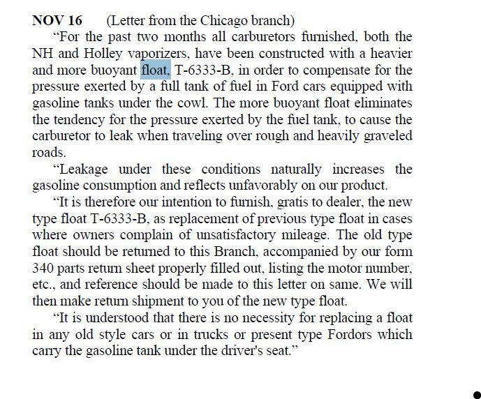

Holley's early NH literature indicated that the nut on the top of the carb was to be TIGHTENED and LOCKED DOWN once ideal running setting had been achieved. They obviously abandoned that advice (even to the point of having a friction device on richness adjustment on later NH versions) and "T" owners fiddled incessantly whether necessary by temperature conditions or not. Importantly, though, it is this advice which shows that it was never intended to be adjusted for various speeds as both the idle and fast-running settings were identical in a properly adjusted carb by design.
I am going to bet that your carb does not have the "B" float which was larger than standard, having been changed due to extra head pressure supplied by the cowl tank's height...rough roads and extra fuel pressure led to problems which were to an extent, alleviated by the larger, more buoyant float

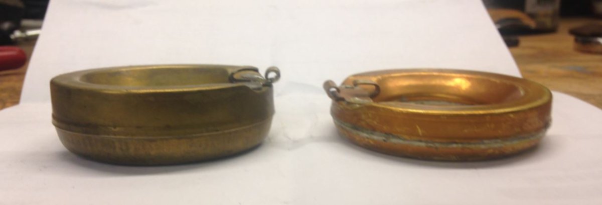

Does the B float have any identifying marks?

Here you go, Pat
they are not marked, but the difference is stark
