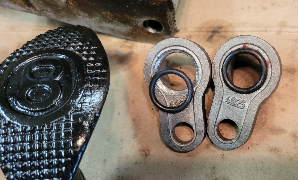

I'm going to have the happiest hogshead on the block with these new pedal cams!
I'm putting in O rings to help with the oil leaks at the pedals.
The transmission book shows how an O ring, spring, and washer can be installed on the clutch control shaft to stop the oil leak there.
Has anyone done this? Is it effective (or really needed)? Or just something to get carried away about? Any reasons not to do it?
Of course for the early hogshead the clutch control shaft goes all the way through to the outside on both sides, so I'd have to use two O rings, springs, and washers.
Should I do it? Yes or no?

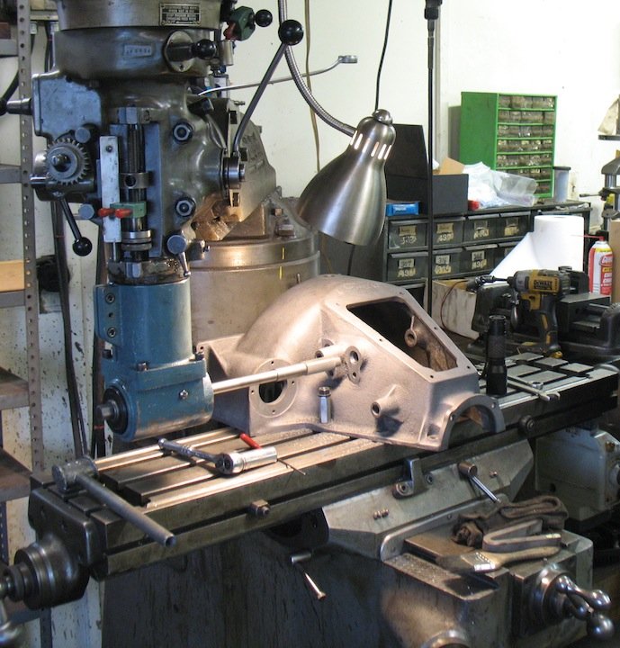

An O ring is an easy fix, of dubious effectiveness, especially in an alloy cover. Most times the holes are well worn and the shafts also, meaning the clearance between shaft and cover is way over spec. I hand ream the cover holes to take a thin walled bronze bush to get the size back to spec. I have made a tool with a fly cutter to cut a seal land in the outside of the cover. It is driven with a carpenter's brace. The I use use a proper oil seal, as John does. This allows the shafts to still be oiled. When new shafts are used, this makes really nice job of it.
An added bonus is the open end on the clutch fork rod can be properly sealed. I leave that bush protruding outside the cover, and plug it with a cup type freeze plug. All this is achievable with hand tools.

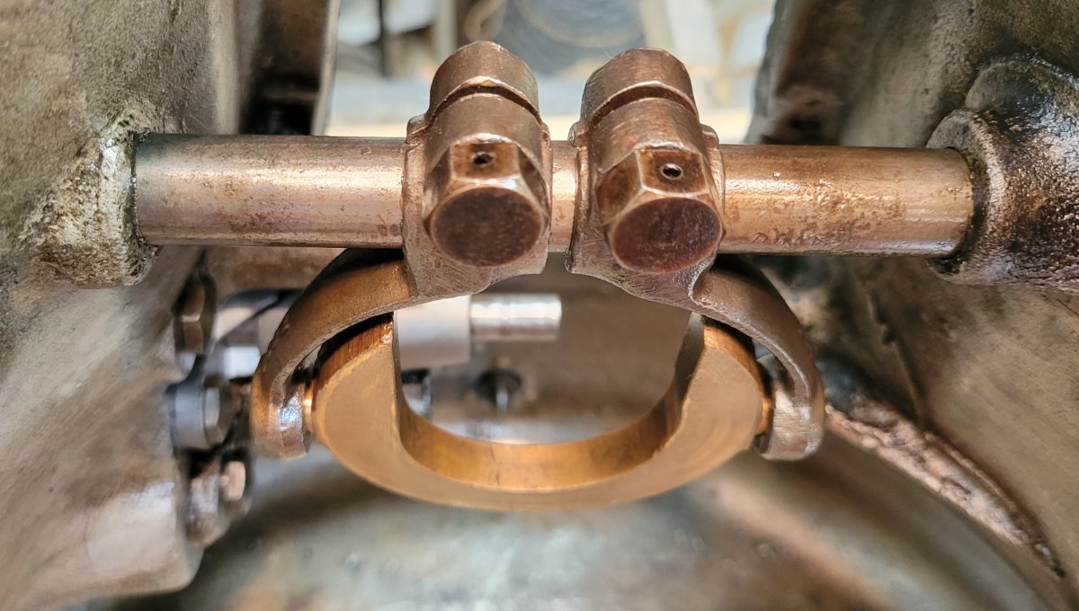

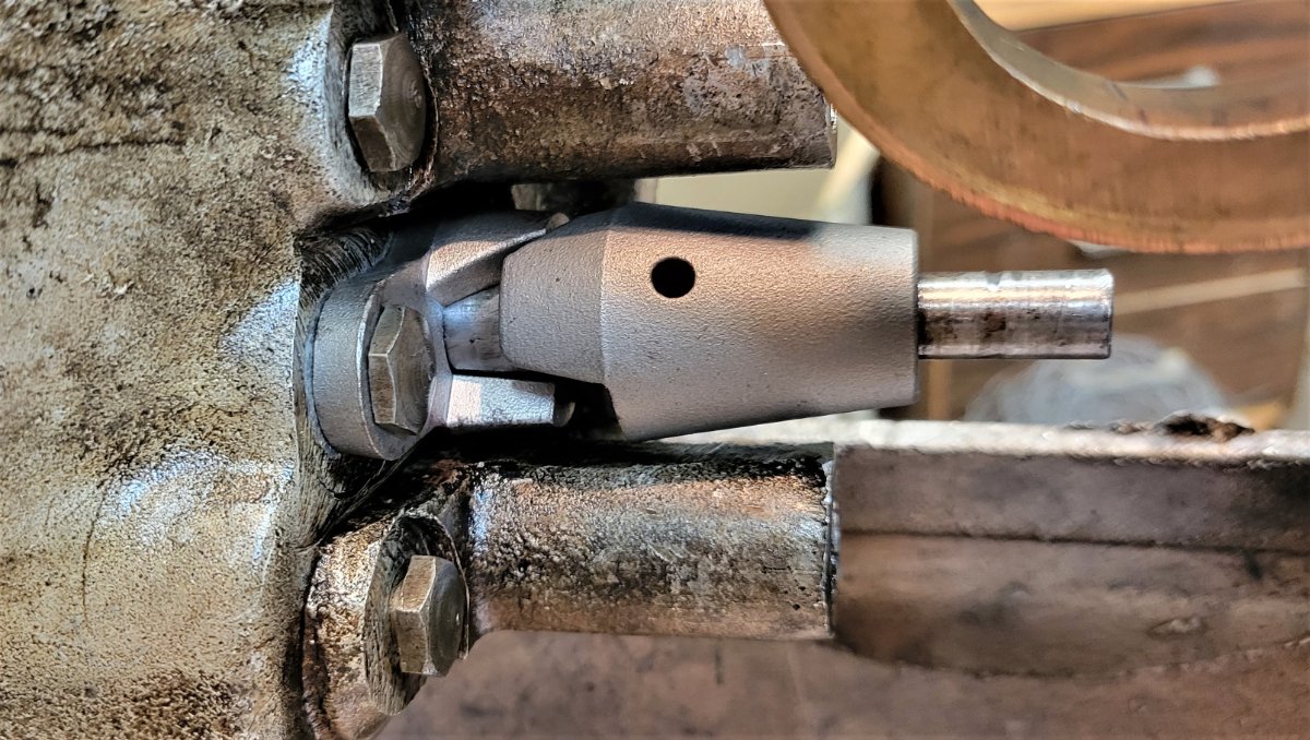

DON’T DO IT ! The spring & o-ring on the clutch shaft is a poor choice if you drive much. The spring keeps the bronze ring loaded against the steel collar in one direction instead of “floating” and wears out its inner diameter.

I concur with John and Allan. Mike Bender had an informative post on doing the job with lip seals but I can't seem to turn it up. Attached are a couple of his pictures. I use a mill as well but don't have an angle head. I stand the cover on its side bolted to a large angle plate. Be sure to retain alignment, especially on the clutch shaft. And, as John mentioned, take care that the outer pedal cams are lubricated. The Timken seal is #253747. Can be cross referenced to any brand.

Post by Sean Butler » Sat Jun 11, 2022 3:40 pm
Have seen this once or twice on a grooved shaft.

Posts: 5267
First Name: john
Last Name: karvaly
Location: orange, ca
Re: Happiest hogshead
Post by speedytinc » Sat Jun 11, 2022 5:10 pm
This is what I feared cutting a clutch or pedal shaft. Common sense warned me away.
I had not seen an actual failure until now. Thanks.

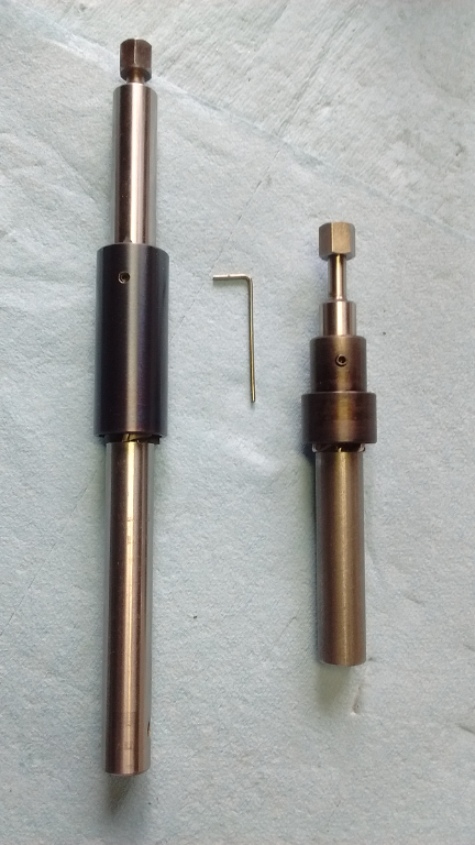

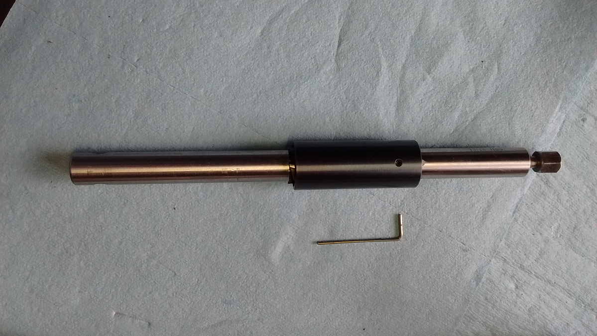

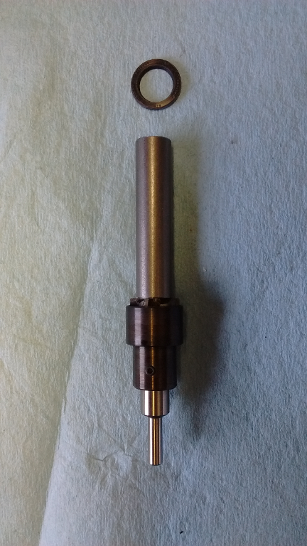

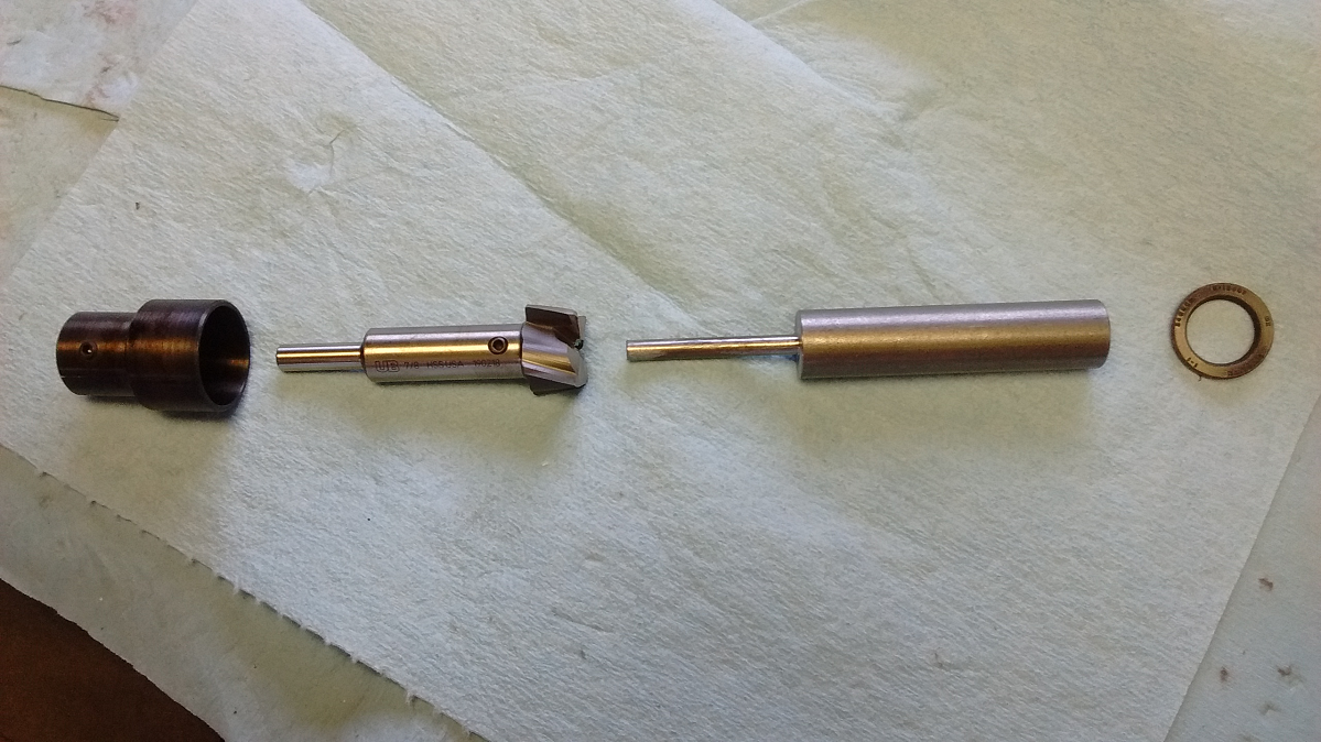

O-ring design parameters exist for both static and dynamic applications. They vary somewhat and do indeed work with moving parts and seal remarkably well when designed correctly and surface finishes of the parts are correct. All that information resides in many places, but my design favorite is the Parker Seal O-Ring Handbook. That said, just squishing them between the support and the hogs head in a home-made chamfer, well, under those parameters, I'd agree with you wholeheartedly. It's better than nothing, and "better" has a wide-open definition from shop to shop.
In any event, my personal preference is for a lip seal, but that's beyond the vast majority of owners with minimal access to the equipment necessary. In the absence of equipment, these work very well for that job and can be used with a 3/8 speeder and I've taken them with me to help folks who can't get to a shop or just didn't have the time to send the work out...they are built up from commercial counterbores and have pilots which mimic the pedal shafts:
