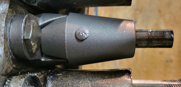

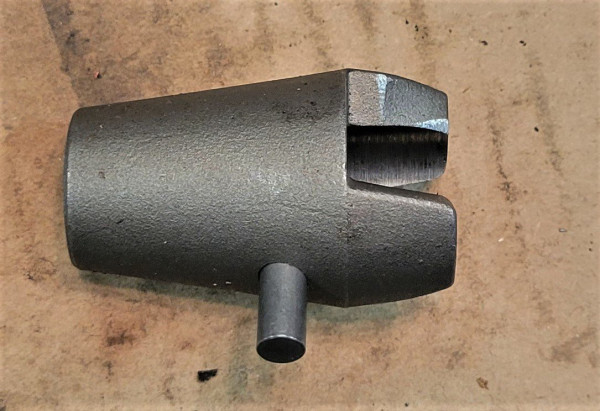

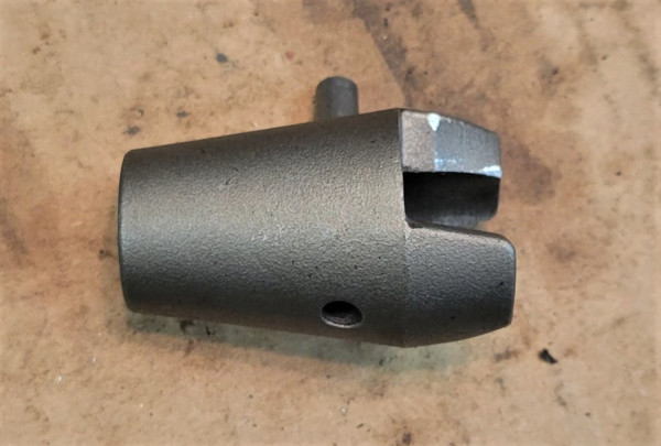

I'm replacing all my pedal cams, including the low speed cam and notch, which mounts on the pedal.
The notch is mounted on the low petal shaft with a 1/4" pin, however on the low speed notch,
one side is drilled to 0.250"
the other side measures 0.205"
Should this be drilled all the way through to 0.250"? Did someone goof or am I missing something?
