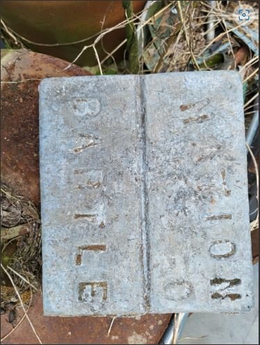

I have had this for some time. I have always wondered if it was
Nation Bartle.JPG (59.53 KiB) Viewed 3703 times
babbet. Does anyone know?

You can get a lead test kit from most hardware or big box stores. If it doesn’t test positive for lead, you may have something.

Babbitt, although named after the inventor, is a generic term, babbitt is of many mixes with %'s of heavy metals for different applications of bearings. I would think it would cost you more for testing than just buying what you need of a known mix.

There's no practical way to tell by looking at it. Babbit is a soft metal alloy. It is harder than lead. The item you have may be lead, or a high-lead alloy, intended for use by plumbers, tinsmiths, or newspaper printers. It may be an alloy intended for makers of ornamental objects. Or it may be one of several types of babbit metal intended for use by mechanics. Automotive applications require a high quality of babbit metal specifically formulated for high speed engine bearings. Babbit metal intended for general use on other types of antique machinery probably won't be suited for automotive use.

As for "Nation Bartle", that may be related to the National Lead Company. The original piece of material may have been cut in half and partially used. Perhaps it once read something like "National Lead Co. Bartlesville, Oklahoma". (Guess)

Looks like some soft blow hammers or fishing weights or toy soldiers to me. Not model T engine bearings.

:D Ok, you got me looking on the internet which is what I should have done in the first place. I'm guessing that this is lead.
