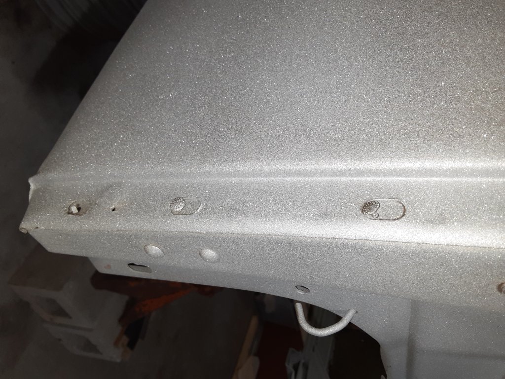

I have the gas tank out. Do the rivet heads go on the inside or outside of the cowl?

Re: Question: What Is The Best Way to ---?
As is shown in the picture, the rivet head goes inside. You need a helper to hold the rivet head tight against the inside of the cowl with the 1/4” punch, while you spread the legs of the split rivet and curve the ends deep into the lacing so the split legs don’t click against the hood while driving. Jim Patrick
Jim, I did notice in the picture that the rivet legs were on the outside of the cowl. I wonder where that picture was from. It looks like it could be from a manual. Maybe Tim will respond.
I wonder why the legs are supposed to be on the outside. It would seem that there would be less chance of of the hood coming in contact with the rivet if the head was on the outside.
Bruce. Just the opposite. The lacing is very firm, making it almost impossible to press the head into the lacing deep enough to recess below the surface. By the same token, it is very easy to press the split tines deep into the lacing. Also, with the head on the outside, the split tines on the inside have a difficult time seating against the inside steel surface of the cowl and will almost certainly start to rattle. Jim Patrick
PS. If you split the tines apart a little, then use a 1/4” - 3/8” round shaft between the tines and hit with a hammer, it will curl the tines down and imbed them into the lacing. The round shaft can be a screw driver or a small socket.
Jim, Thanks, that make sense!

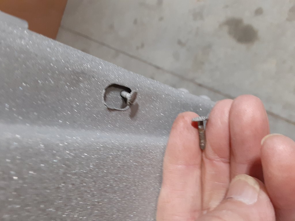

Allan, A threaded nail was used on the two lower holes in my cowl, where there is no access to the back side. The nail is shown in the attached photos. I will try to reuse the nails, but if they don't work I will do what you did.
