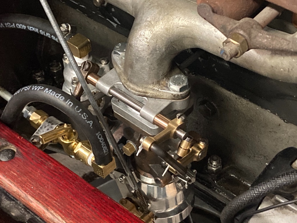

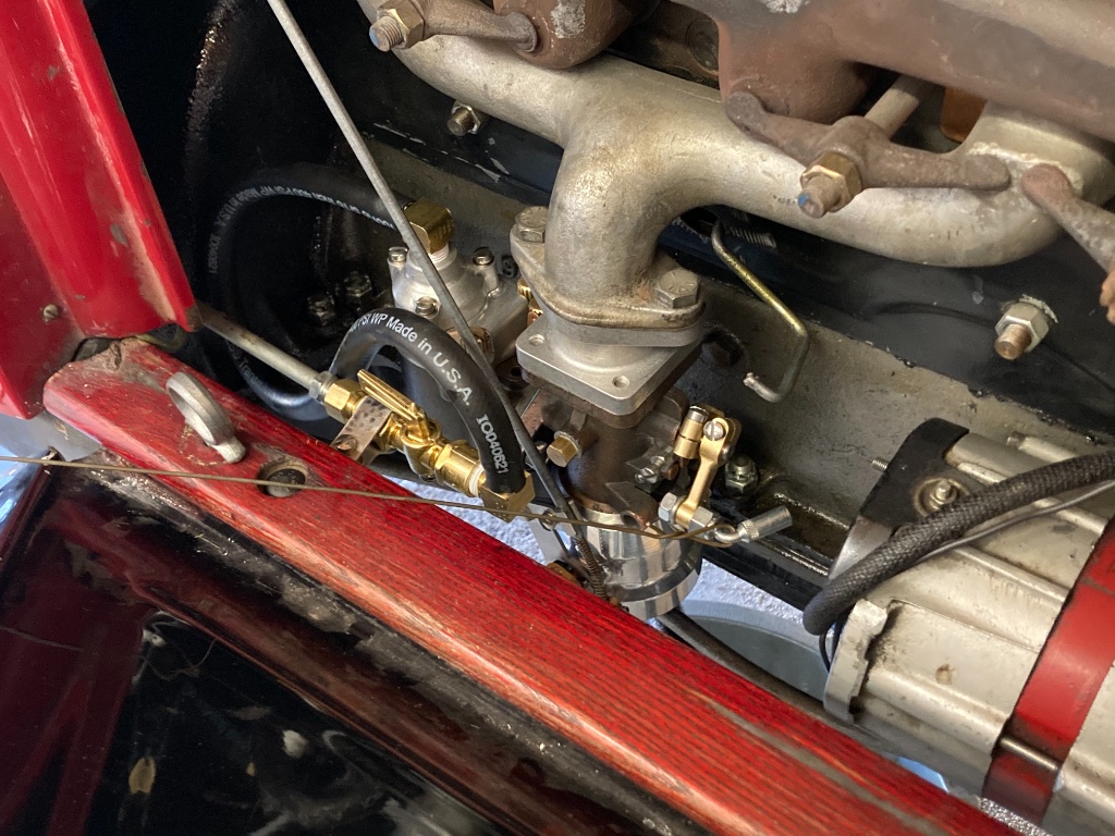

The most difficult part of the carb swap was solving the throttle linkage bell crank challenge. I wound up making another carb adapter with built in bosses to support the bell crank. Several simpler ideas were attempted, but ran into clearance issues every time.
Got it on the road today and ran stronger than ever (could be because the carb is noticeably bigger than the U&J), but also idles and pulls under load much smoother. The first drive yielded a slight hesitation during transition off of idle and acceleration. The plugs were kinda sooty, so I leaned out both the intermediate and high speed jets 2 clicks each. Went for a drive this evening, and realized that leaning it out was the wrong thing to do. The hesitation is much worse. Will open the jets 4 clicks before another drive tomorrow...
