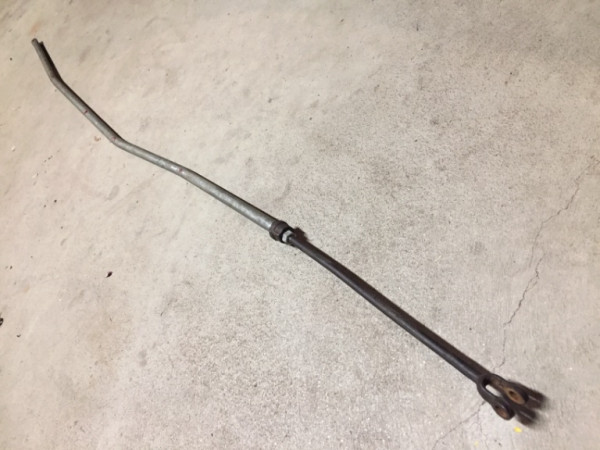

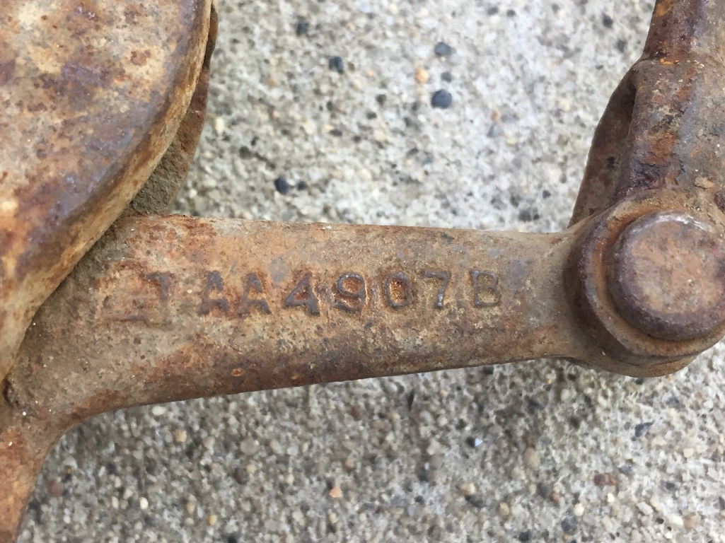

I added a Ruckstell, but haven’t added a shifter.
I heard of people who used Model AA shifter to shift a Ruckstell. The only thing I could find in the forum is this thread from 2010:
http://www.mtfca.com/discus/messages/11 ... 1270097310

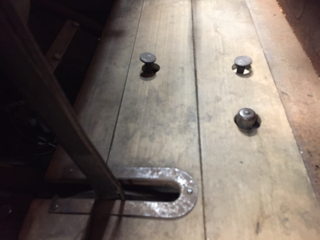

Today I got this from a friend: I like the idea of a foot shifter rather than having one more lever in my way.
Anyone use one of these?
Matt

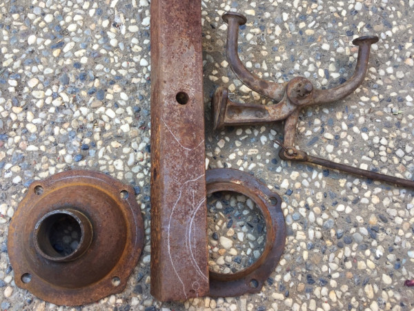

I like the idea that I can use my hands for the throttle in my right foot on the shift. So I’m moving forward.
I understand the concern if there is enough movement. I measured less than an inch of movement on the Ruckstell shifter. The foot pedal seems to have twice that.
Here is the first progress photo:

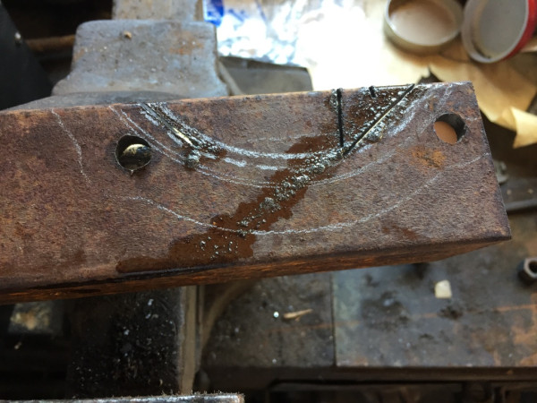

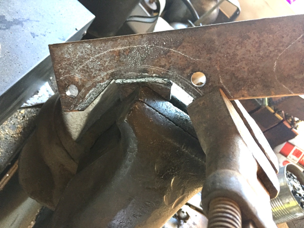

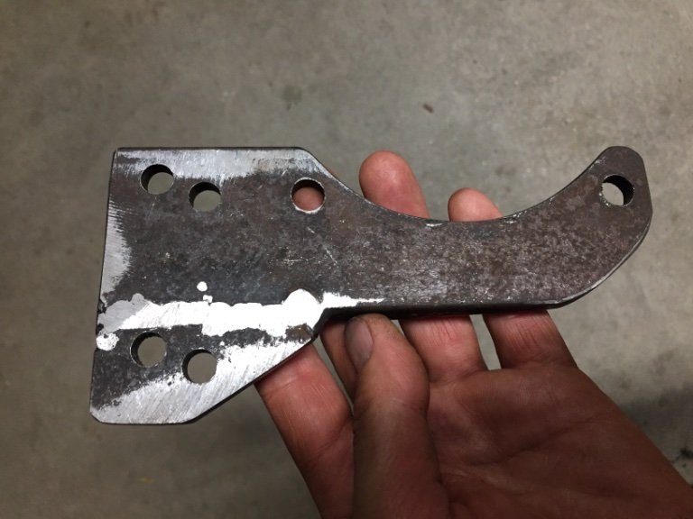

Cutting with hand saw: Breaking using chisel and bend:
You are correct this application requires more force and could be a issue with the casting.
Kieth,
You make some good points. No mater what a model T with Ruckstell can keep the arms and legs busy. I am locating this on the left side of the forth main. Your point about a straight rod is true. Unfortunately had to make some bends for battery box. Perhaps if I did it again I would have mounted to the other side of the fourth main. Here are some progress photos:

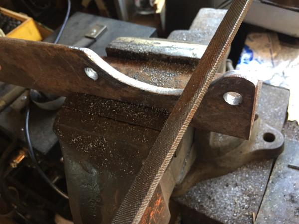

Matt in California
Topic author - Posts: 809
- First Name: Matt
- Last Name: G
- Location: California
Re: Ruckstell Foot shifter

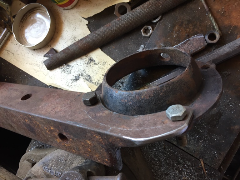

Course filing:
Fine filing:
More cutting:
Test fit:
Matt in California
- First Name: Matt
- Last Name: G

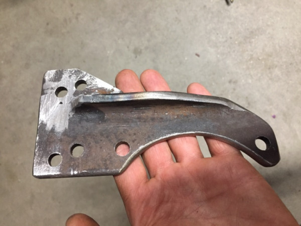

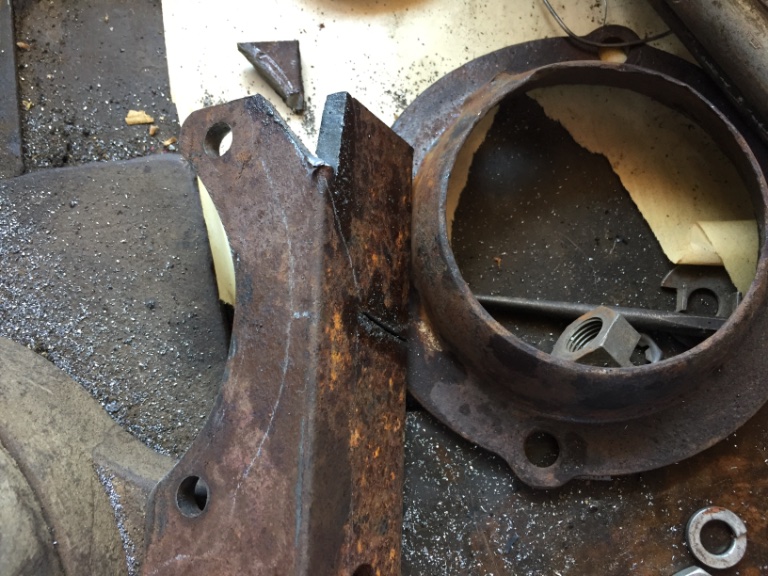

Finished Bracket.
All hack saw and file plus a weld.

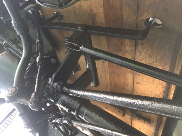

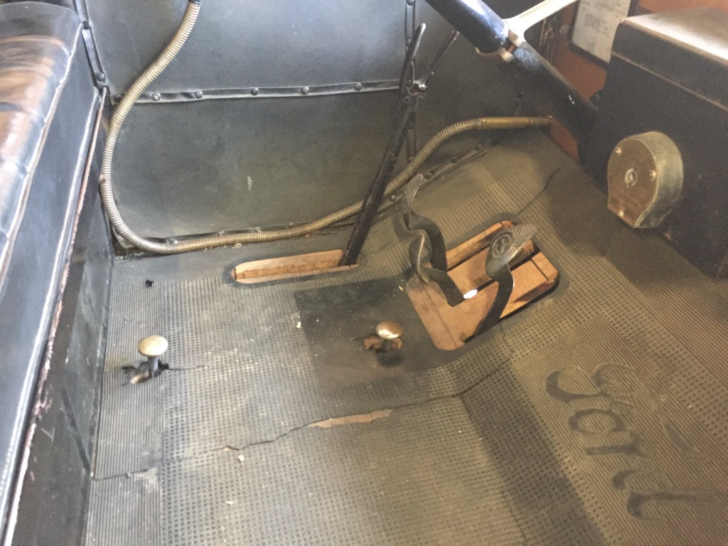

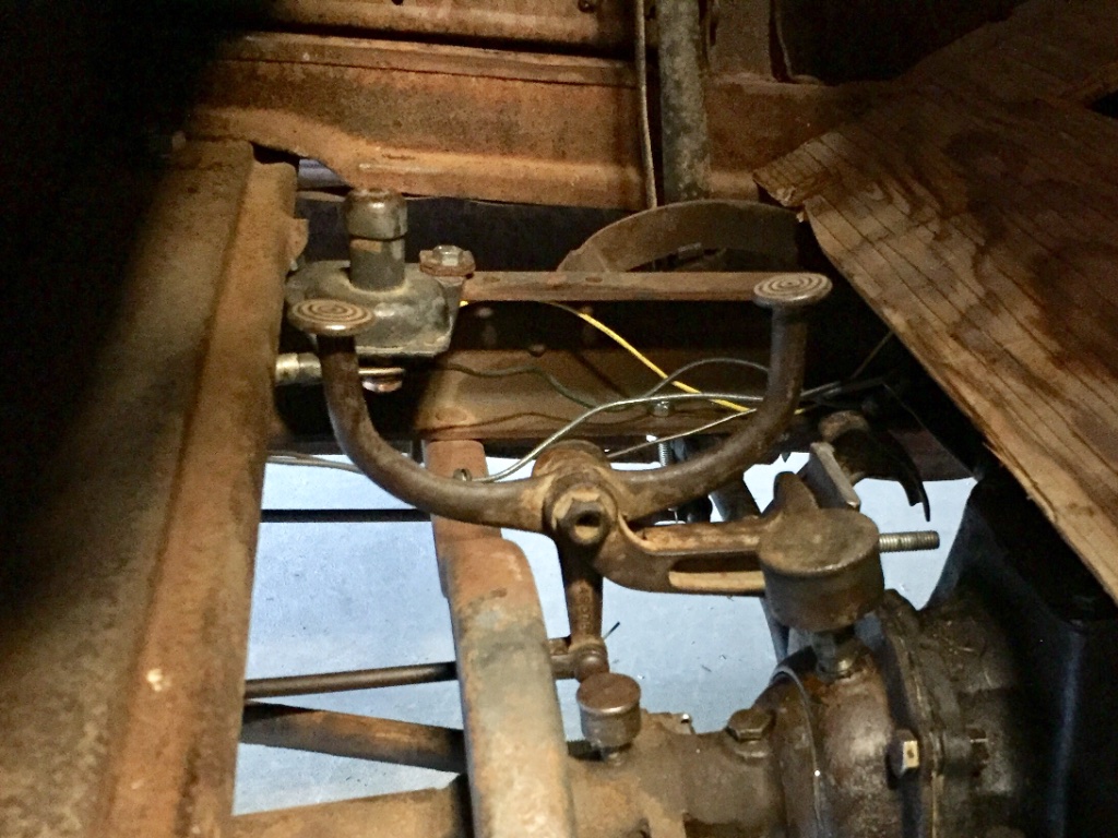

Installed
- Posts: 1203
- First Name: Adrian
- Last Name: Whiteman
Nice job Matt, and thanks for the pictures
Happy shifting !
Happy shifting !
- Posts: 5472
Nice installation ! So - does it actually work ?

Seeing it installed, thinking maybe, wondering if the pedals will be high enough where they stick out of the floor? By time you take up any play in the clevis ends, bowing in the rod between, both pulling and pushing, you might run out of needed travel by time you reach the floorboards. If you are going to have floormats, that will reduce the usable travel even more.
Don't take this as a criticism, I think it is a fantastic idea that may require a little more tweaking to make it fully workable.
- Posts: 5135
The linkage rod needs a length adjustment. Pictures show the pedal faces almost the same height.Mark Gregush wrote: ↑Tue Jun 14, 2022 1:51 pmSeeing it installed, thinking maybe, wondering if the pedals will be high enough where they stick out of the floor? By time you take up any play in the clevis ends, bowing in the rod between, both pulling and pushing, you might run out of needed travel by time you reach the floorboards. If you are going to have floormats, that will reduce the usable travel even more.
The rux should be in direct or rux, where by, one pedal face should be up all the way & the other down all the way. As shown, its in a near neutral position.
Neat idea & execution. Use will tell if the pedals are in the way of one's feet in operation, ingress, etc. Do let us know.
This idea adds another to the possibilities of better/safer shifting along with a left side shifter or foot throttle.

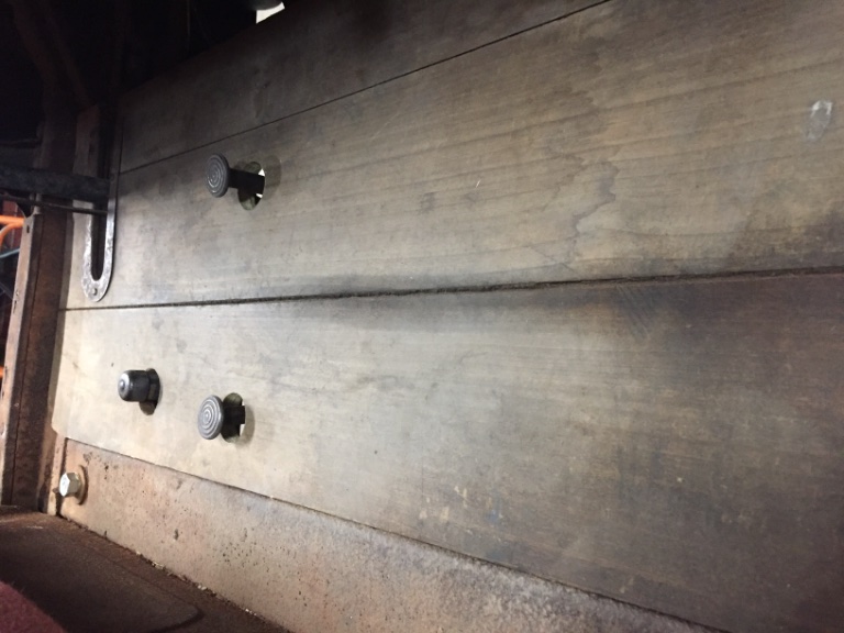

Matt in California
- First Name: Matt
- Last Name: G
Thanks for everyone's comments!Mark Gregush wrote: ↑Tue Jun 14, 2022 1:51 pmSeeing it installed, thinking maybe, wondering if the pedals will be high enough where they stick out of the floor? By time you take up any play in the clevis ends, bowing in the rod between, both pulling and pushing, you might run out of needed travel by time you reach the floorboards. If you are going to have floormats, that will reduce the usable travel even more.
Mark, yes you and others are very observant. After I took the photo I made final adjustments and when engaged the pedals come just above the running board in either the high or low positions. If you see the earlier photos of the finished bracket you will see two sets of smaller holes. I am currently using the lower ones and it seems to be working fine and not hitting anything. But if I added the a floor mat I would likely need to lift it. At this point, I don't even own a floor mat.
Robert, thanks for your helpful advice on shifting. I am starting to learn how to shift. Regarding driving in Ruckstell under drive for normal driving: I am doing it now to learn to shift, but would rather not wear it out. I can see why people enjoy running it to add the missing gear. I enjoy running a T as it was designed to be and plan to use the under drive only when needed.
I do want to make clear, as insinuated in the first post, this idea was not original to me. Actually, fellow member, Don Azevedo, showed me his 1914 Touring using the same concept. Don loves it and the car has had the set up many years because his dad installed it. I figured when I posted on here I would find others who have done the same, but evidently this solution was not common.
Matt

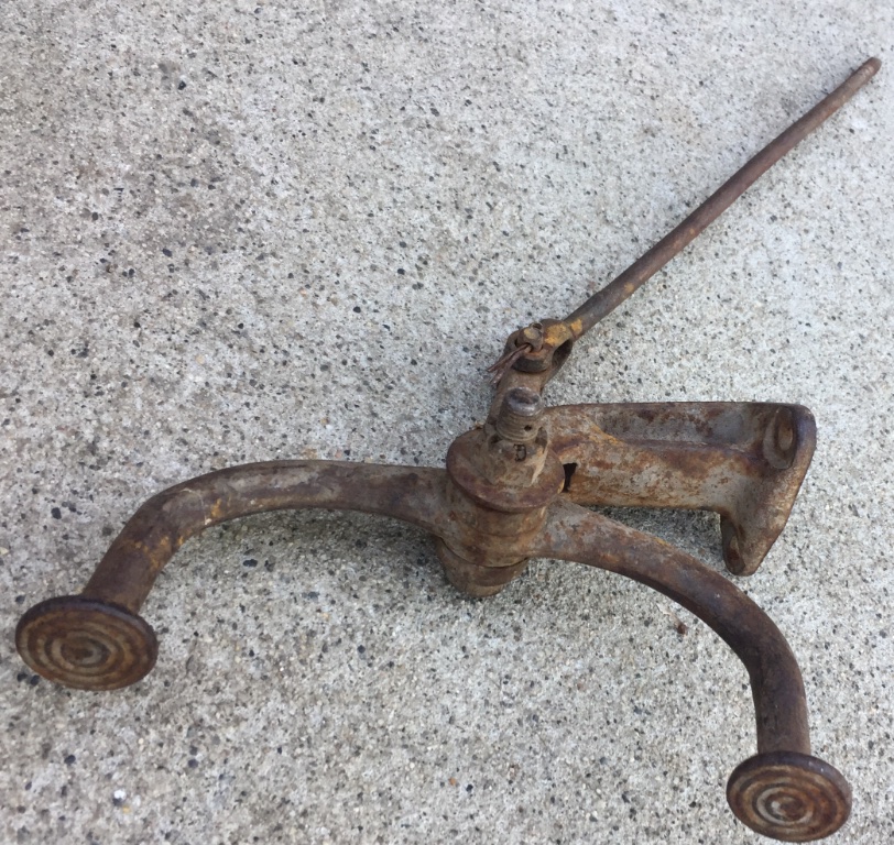

Matt in California
- First Name: Matt
- Last Name: G
Here is the setup that Don’s dad built.
As you can see the pedals are higher and wider spaced.
You can see I connected it differently. The designer seemed to take in account the concerns that were brought up here with a bit more leverage. In the 1914 the fender bracket is not in the way like it is on my 1920
As far as a proof of concept Don really likes the set up.
Matt
