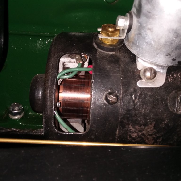

Feeling a little uncertain as to what to touch to adjust the 3rd brush.
I've read the ford service manual. Don't really feel good fooling with electrical ( as you may have read recently).
Does this look ok to you? It's set neutral with no charge or discharge. What's next??
The black discoloration on the green wire at lower left is paint.

Get yourself a piece of wood , just as wide as the copper segments and about a half inch thick by maybe a foot long... Wrap the end of the wood with some fine grit sandpaper. Start the engine and place the covered wood against the running armature the clean and brighten the copper contacts..... Then look at your ammeter and you may see that the generator is charging. I observe that the brush plate has been rebuilt, so even if you have to adjust the third brush for charging rate the movement will not crack a dried out insulator and ground out.

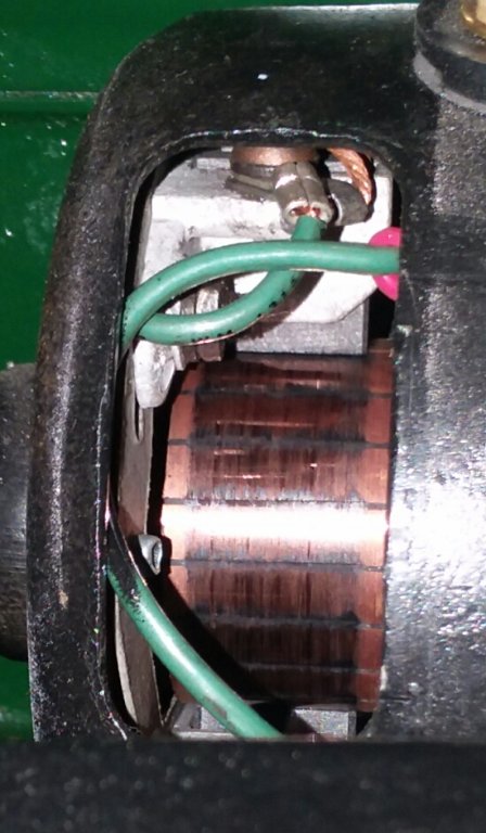

The mica does not appear to be cut down between the copper segments. Optical delusion?
The Setting of the near neutral was done with the 3rd brush up?
Rotating the 3rd brush toward the motor should increase the charge rate.
Be gentile tightening the 3rd brush nut. Just enough to hold. The carriage bolt head presses into the inner insulating fiber.
This is a very common area that grounds out the generator to appear dead from that broken insulator.

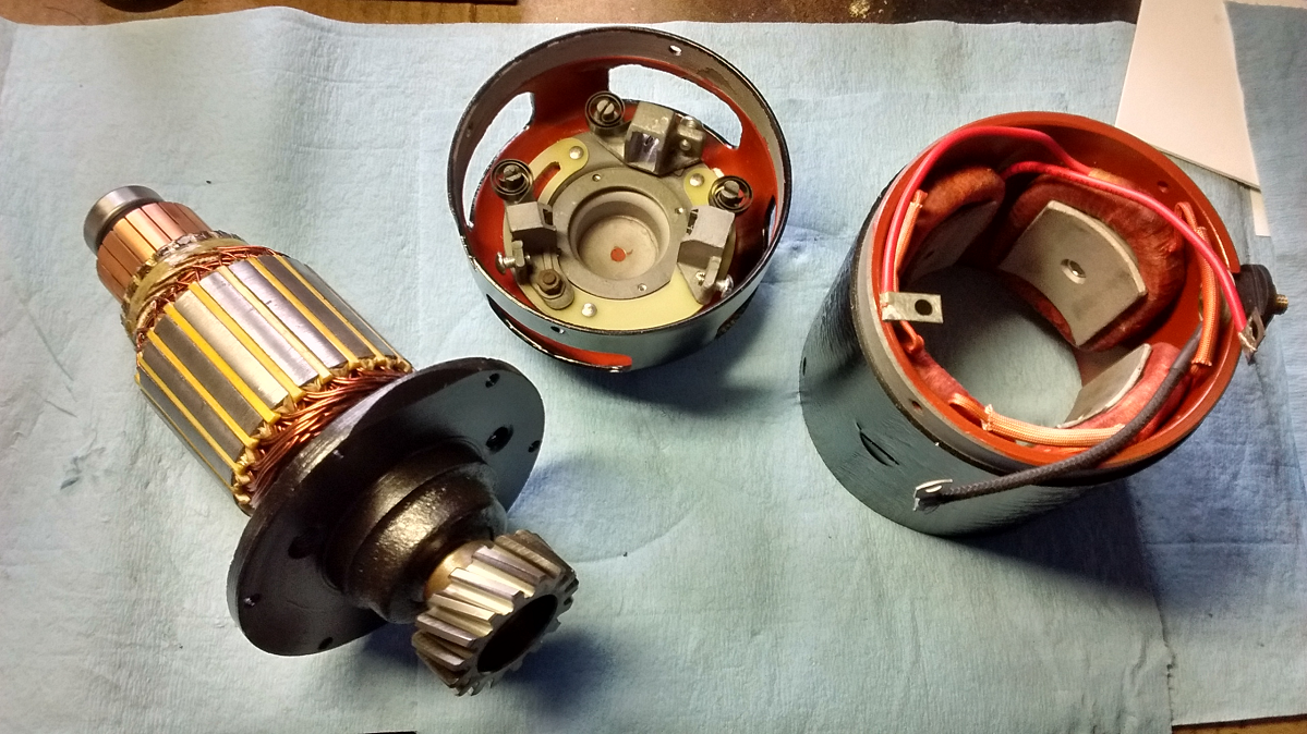

It's a fresh rebuild.

Rebuild looks well done
Dan. After the cleanup I suggested you should be pleased with the output of that generator.

Not to be pessimistic, but, that can mean very little.
Is the mica relieved as shown in your T1 manual?

If it works, it will not work for long, honestly, or will be intermittent or slow to start charging, with the oxide showing on the faces
at a very minimum, do what Jablonski advised regarding the abrasive cleaning of the commutator. Use increasingly fine paper until it shines...not just matte colored copper, but SHINE (finish with 600/800 grit). This will give the longest life to both the brushes and pole faces as arcing will be at a minimum. Also, the brushes look new and not yet bedded to the commutator. After a lot of running, they will bed in and you will likely have to readjust your output. The poles should be undercut, but that's now water over the dam.
you want something that looks like this, but with a little better finished commutator (I learned after this one that as received from the armature winder, that they did not undercut well nor polish past 320 grit). The difference in audible noise and slight arcing on the test stand is surprisingly dramatic between this finish and a 600 grit finish. Lesson learned!!:

The brushes should have a mating radius to the armature. Out of the box, they are flat & make little contact.
A little drum sanding fixture does the job.

New generator brushes are made with a mating surface that has a curvature to closely match contact with the armature. ..

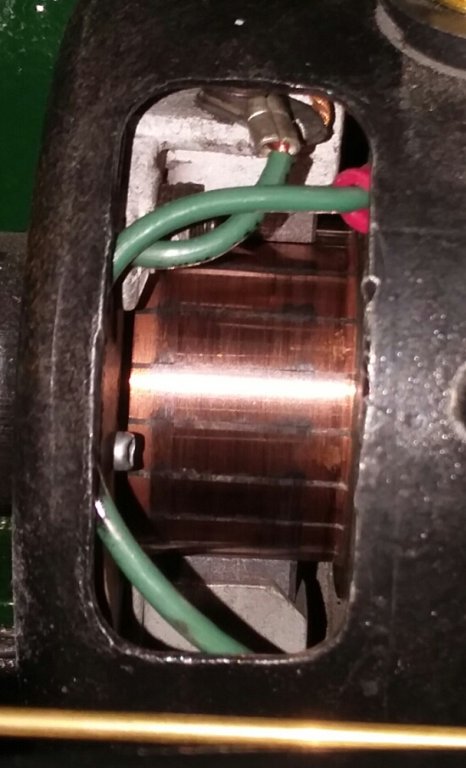

I was told years ago to never use emery cloth or aluminum oxide paper to polish a commutater. Don't know if it is true and never tried it. I believe it was Larry Becker who told me this in the late 1950s. Any opinions on this matter.

Possibilities of metal abrasive particles shorting out the segments

Polished with 800. Still no charge.

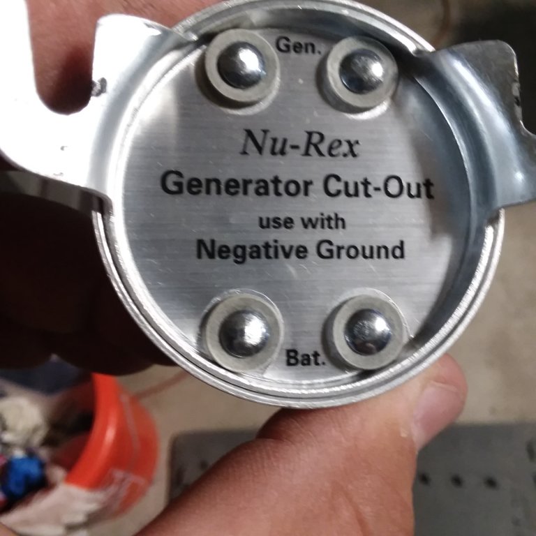

I have a Nu Rex from Snyder's.
Further testing reveals that I have current on the GEN side of the cut out. Tested by grounding test light to frame bolt and placing test light probe on GEN pole on cutout.
Light intensity was dimmer on GEN side than on BAT side of cutout.
So I'm possibly generating electricity but at a reduced level?

The armature segments need to be cleaned out it looks to me. After a good while of use the debris from wear and surface cleaning of the armature fill up the segments. Cleaning and polishing the armature is one thing to do but the next step is to cleaning up the segments.
You can do that with a fine hacksaw blade when the armature is on the bench and carefully do it. The generator repair book recommends to do this.
