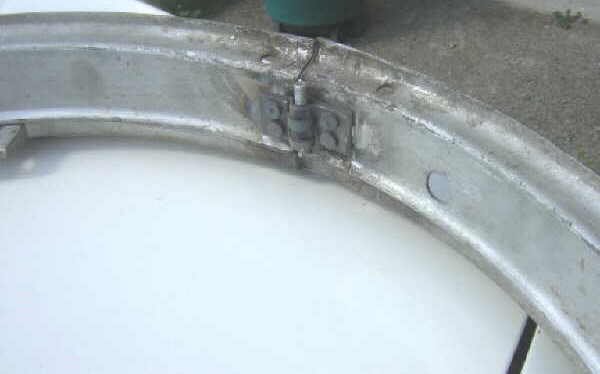

I can make the missing part but what does the pin look like that goes thru both parts of the latch?
Posts: 5511
Re: Split rim latch
Post by RajoRacer » Sun Jun 12, 2022 3:55 pm
That's a Canadian rim - I recall the pin looking like a door hinge pin with a head on one end.

Re: Split rim latch
Post by Alan Long » Sun Jun 12, 2022 8:05 pm
I agree with Steve.
Just confirm that when the main wheel part is attached that the latch or Pin doesn’t hit the end of the wooden spoke or it’s Ferrell. Alan In Western Australia

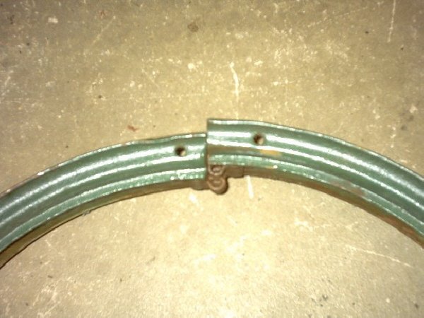

Re: Split rim latch
Post by J1MGOLDEN » Mon Jun 13, 2022 9:10 pm
The missing piece is identical to the piece showing.

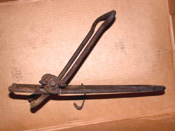

Re: Split rim latch
Post by J1MGOLDEN » Mon Jun 13, 2022 9:13 pm
There is a special tool to go in those holes to collapse or expand the rim when changing the tire.

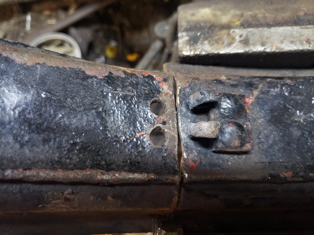

Re: Split rim latch
Post by J1MGOLDEN » Mon Jun 13, 2022 9:14 pm
This photo shows the whole latch assembly.
Kelsey Rim Lock 100.JPG (18.53 KiB) Viewed 3148 times

My rim does not have the two big holes on the side as shown in J1M Goldens picture
Posts: 7173
Re: Split rim latch
Post by Allan » Tue Jun 14, 2022 8:47 pm
Without the holes in the sides of the rim, you have something unusual. There were lots of rims without the holes, but I am unaware of any of these having that 'hinge type' joiner. Be aware that if you replace both sides of the 'hinge' joiner, the pin holding them together must be oriented so that it is entirely on one side of the joint. From your photo this is clearly shown in the piece that is still there. If you orient the pieces with the pin over the joint, you will not be able to fit/demount the tyres.

Re: Split rim latch
Post by bgarrett » Tue Jun 14, 2022 9:15 pm
Thank you, Allen, I will get a better picture of the hinge when I get back from the Petit Jean Swap Meet. Its badly deformed.
