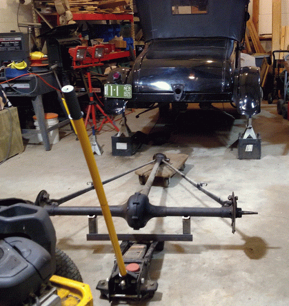

I made a spreader for a floor jack using Steve Jelf's method.

Looking @ the jack adapter, I would make it much wider to pick up the castings for the backing plates. Thats a lot of strain on those tubes in the middle. That was my thinking when I built mine.

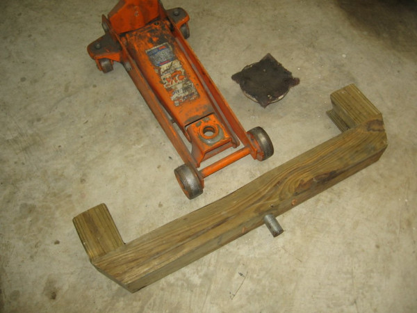

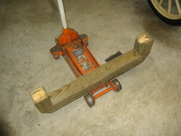

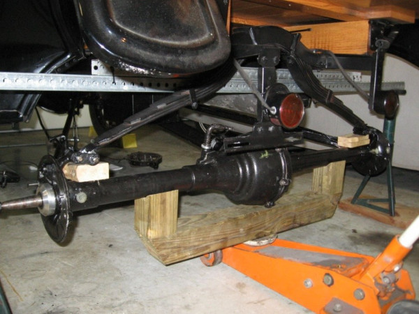

Rich is correct, here is my wood jack adapter. If you make one, be sure to put a piece of pipe in the middle to fit into the jack socket. Otherwise, the adapter can roll off the jack (I learned the hard way). I used wood blocks under the spring eyes to spread the spring as I jacked up the rear axle so I could slip in the shackles. You have to loosen (but not remove) the nuts on the spring perches to allow the shackles to slip in. :)

Thanks for noting that, Mark !! I epoxied a chunk of pipe into the hole I bored in the timber for a dowel pin that fit the jack. Very necessary !

Can you clarify or show a pic of how you adapted it to ensure it can't fall off the jack please

Post by CudaMan » Sat Jun 18, 2022 6:54 am
Here you go. :)

I see now, Thanks Mark
