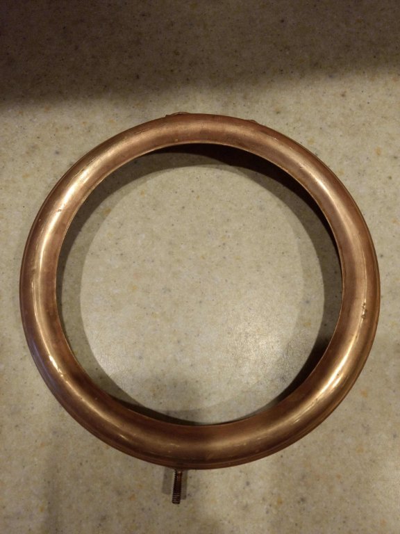

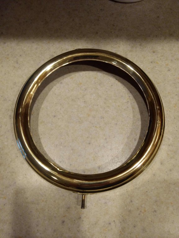

How corroded are you talking about? If it's green or brown I use Zepp calcium, rust & lime remover. buy at Home Depot & Lowes. Small parts can be soaked, larger can be wiped with a soaked rag. Use gloves, eye protection & use in a well ventilated area. I have used it to clean brass firetruck parts for years. keep an eye on it it can turn brass dark if left to long. Works good for cleaning radiators, engine & head cooling passages also.
Craig.
Craig.

I have also used the soaking method on extremely tarnished brass with good results. My chemical of choice is white vinegar. It does give brass a copper look until final polish and I may have read somewhere that repeated use might not be good. Only needed to do it once now just keep them shined up. Works for me! Your mileage may vary.

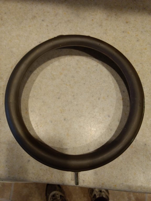

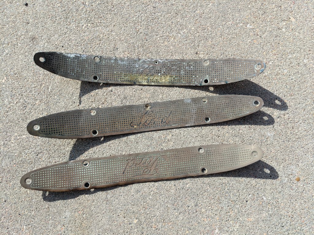

Craig,
here are the door sill pieces as an example. The other brass pieces are dull and brownish looking, but not corroded as bad.

Hi Neal,
Pat is correct about exposure. I used Zepp because it is stronger than vinegar. If you use vinegar try the commercial grade it's more like 30% -35%. Many of the polishes are acidic, I like to wash & wax after polishing.
Craig.
Craig.

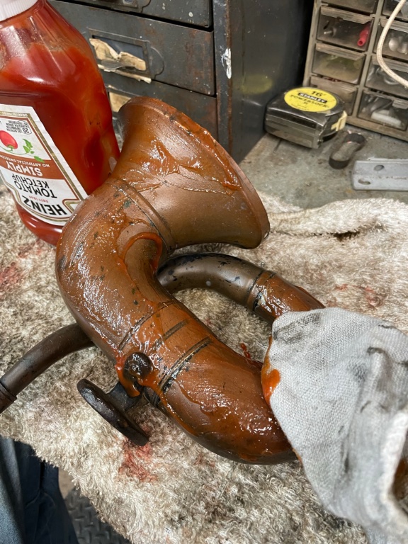

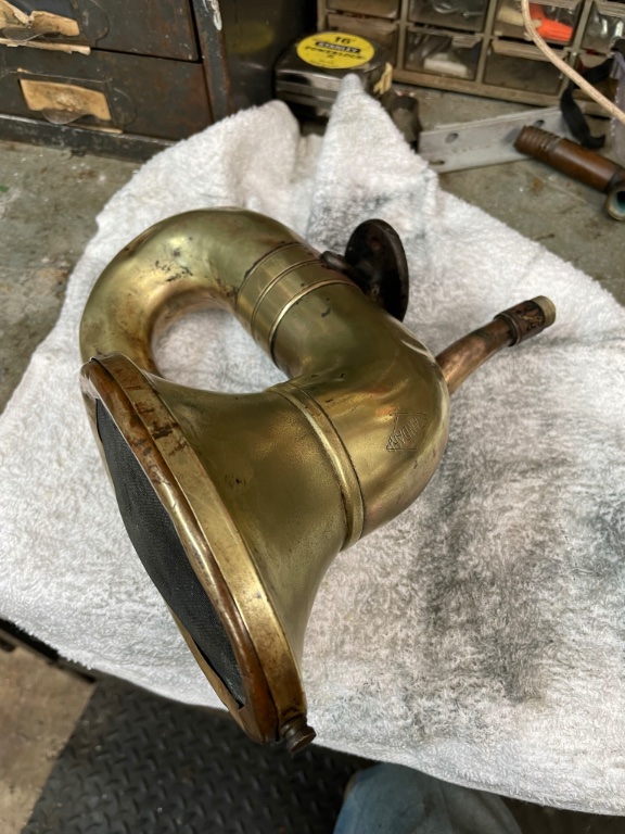

Easiest way found for me to remove the very old brass tarnish is ketchup
Really works, slime it on, rub with a rag and the tarnish is gone. Clean well in soap and water rinse, then go on to polish using your favorite product.

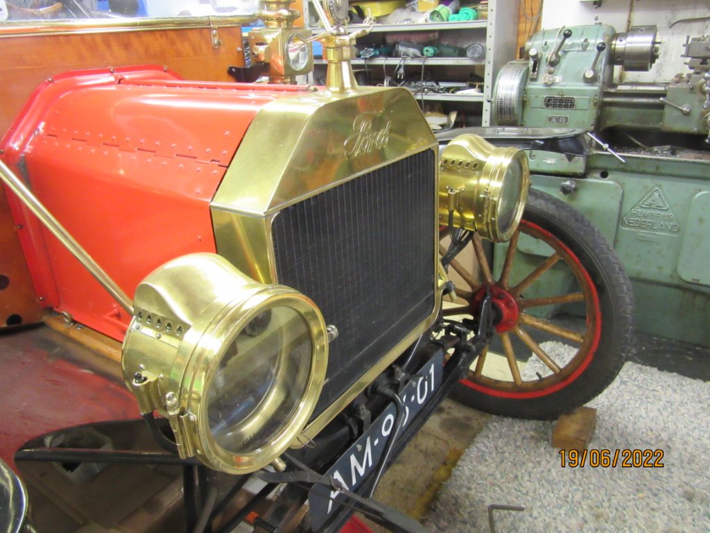

Re: Brass cleaner suggestions?
To polish our 1912 to do that it take's about a day .
And I don't like to do that often.
One time a model T-friend told me he has some thing to spray it on .
We both use that for four years ago now .After we drove in rain and snow several times, it looks still good.
Just a little darker as after polishing .
You can take it off with Aceton if needed
The spray is sold by: HG a Dutch company .

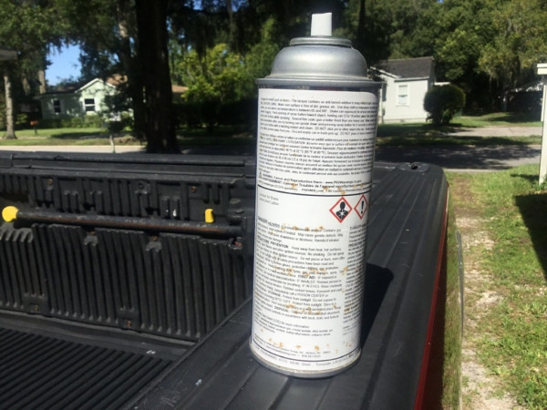

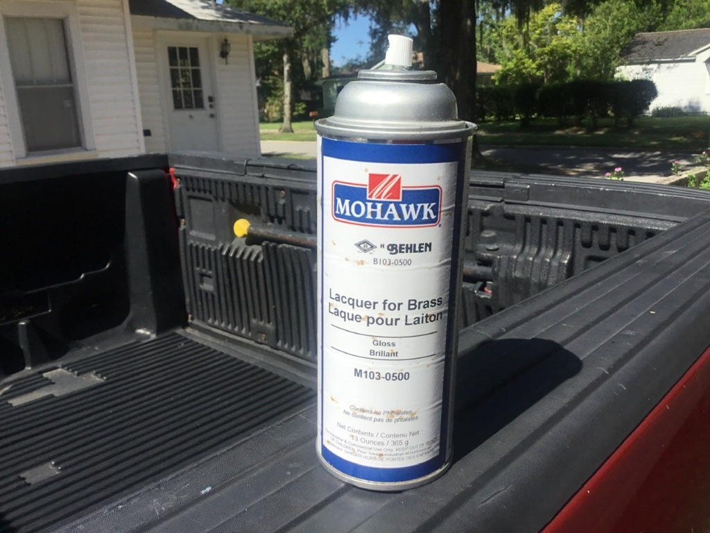

Once you polish your parts, you can preserve the shine with Mohawk Lacquer spray. It goes on great and, unlike most protective sprays, dries crystal clear with no fogging. Try it and you will never use anything else. Jim Patrick
I used the spray Flitz, was done with both headlights and radiator in 20 minutes.
