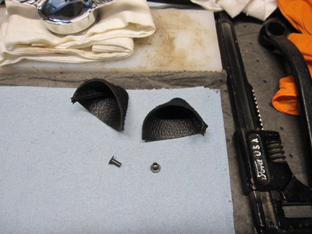

connect this little bugger through the leather pieces into the lower hood ends. I do not have any tool small enough to flatten the little supplied rivet.

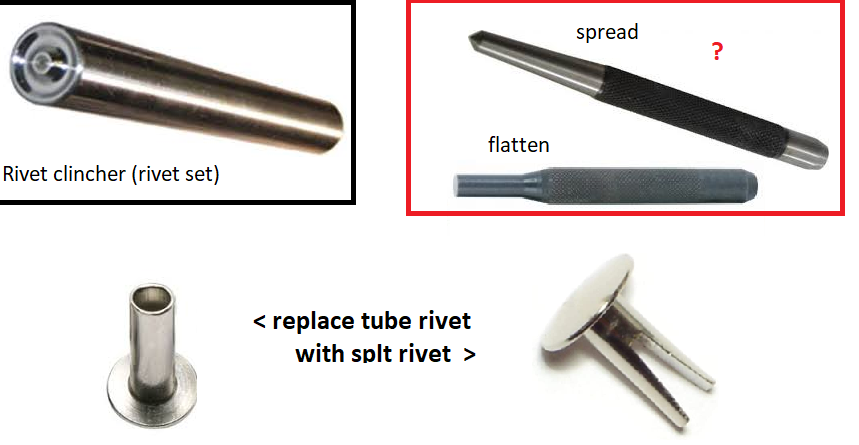

The proper tool is a rivet clincher. It is designed to role the edges of the tube rivet over (used on Model T ignition switch rivets). You could try to use a some punches, one to spread the tube and the other to flatten - chance of success about 40%. Or just replace the tube rivet with a split rive (washer optional).

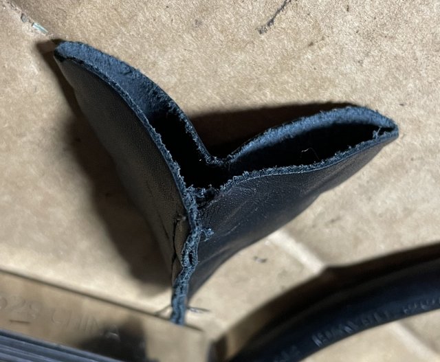

Re: How do you...
Post by MichaelPawelek » Tue Jun 14, 2022 10:10 pm
This is the proper fold.
