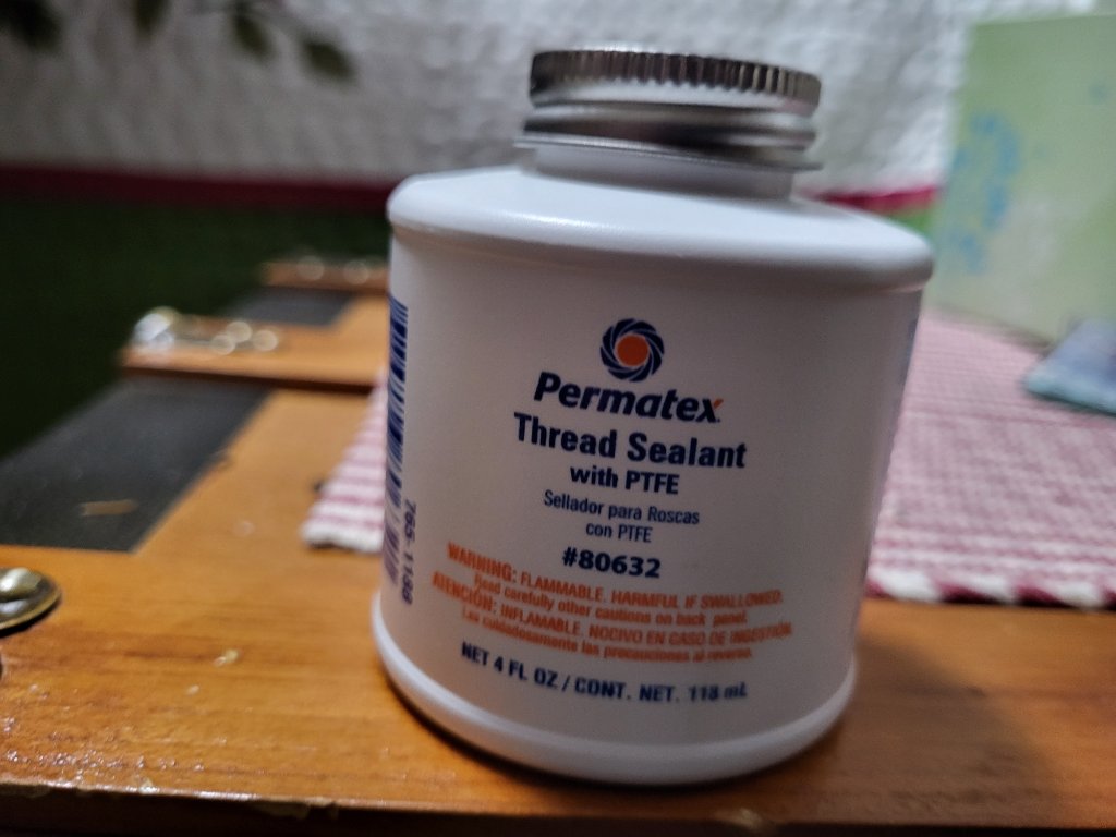

What thread sealant should be used on the sediment bowl to tank, gasline "elbow" to sediment bowl, gasline "elbow" to carb? I do have the Permatex product shown in the attached photo, but it is not clear to me if this is compatible to gas.
What thread sealant for radiator petcock? Could it be same as used for gasline elbows?

I've used Loctite 567 & 577 on my cars without any problems.
Permatex list their High Temperature Thread Sealant as suitable for fuel fittings:
https://www.permatex.com/wp-content/upl ... /59235.pdf
