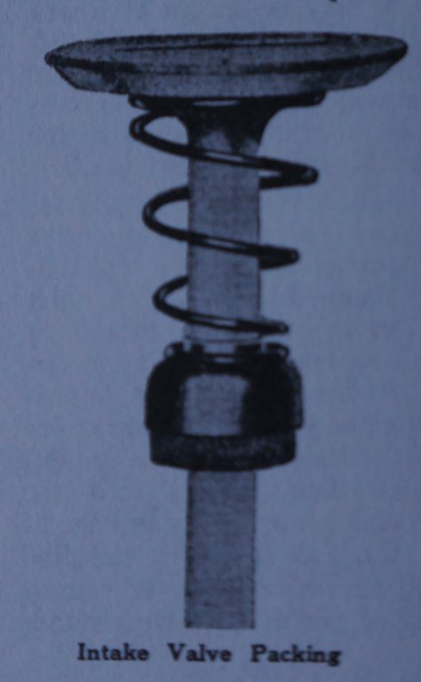

For the 20 years (to this day) that I've owned my T, it's always had a starting difficulty if the car has been sitting for more than a couple of days, particularly in cold weather. Once started and warmed up there's no further problems - easily starts on a quarter turn of the crank, and once in a while, a free start. Runs great, very smooth, does 75km/h (47mph) down the freeway, and goes up hills in top gear.
During some of its difficult starts, I've established the compression and ignition is good. Reading through a 1925 car magazine brought up something I'd never considered before - leaky intake valve guides. And yes, I've been aware that my valve guides are worn (they're original). But since the engine ran so well, I never thought it mattered. Anyway, my theory is that worn intake valve guides is causing the starting difficulty. When it does 'start' it sometimes runs very roughly on what seems like 2 cylinders, then quickly comes good after about 10 seconds. My guess is the oil is getting into the valve guides by then and providing a seal.
So what are the options? I could ream the guides and put in valves with oversize stems. I see the suppliers can provide both - but what makes sure the reamer stays straight? But then I saw these in one of Murray Fahenstock's books:
It seems that such an accessory was once available to fix this problem. Has anyone tried something like this with success?

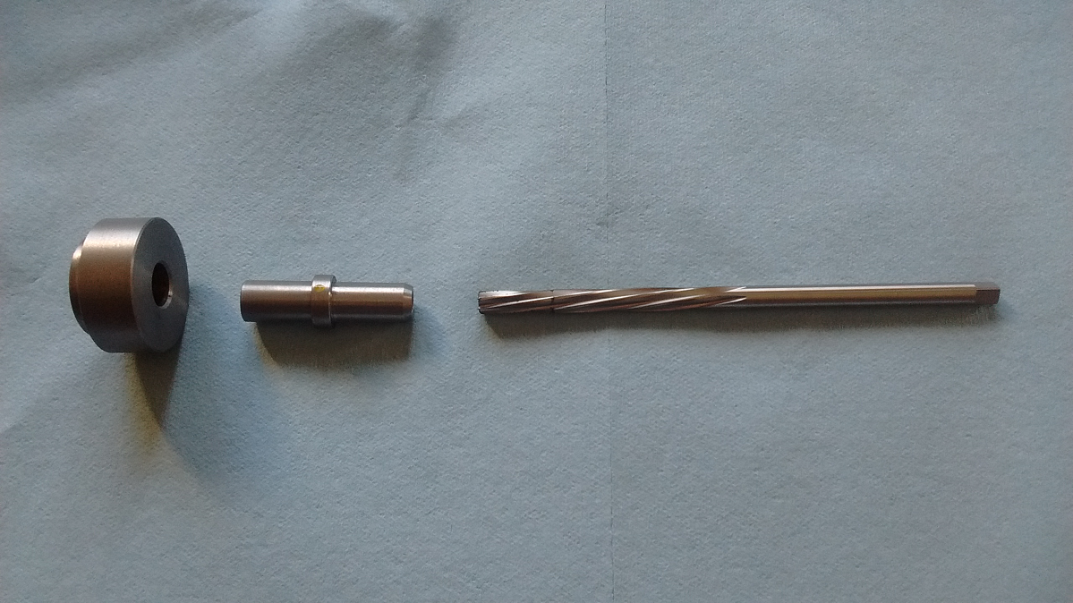

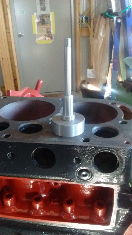

When it comes time to ream the valve guides, look for a Stevens Valve Guide reamer set up.
In order to accurately pilot the reamer through the guide, a centering guide is placed in the valve seat. When Ford machined the blocks, the valve guides and seats were machined at the same time. Stevens utilized this when they designed their valve guide reaming set up. See the attached illustrations from the Stevens catalog.

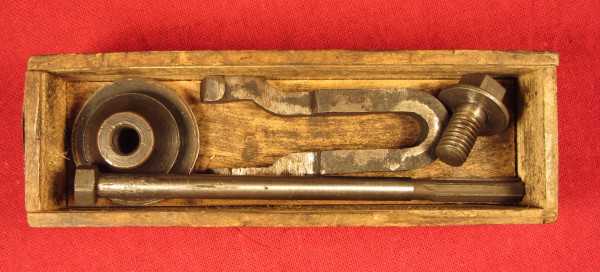

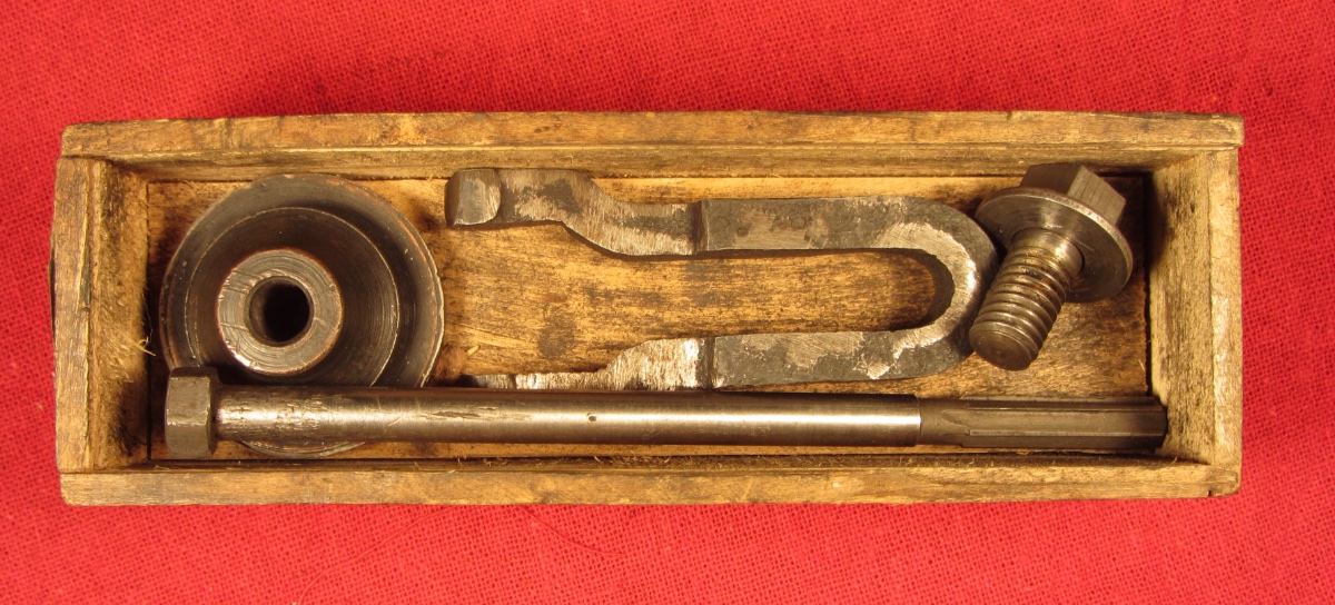

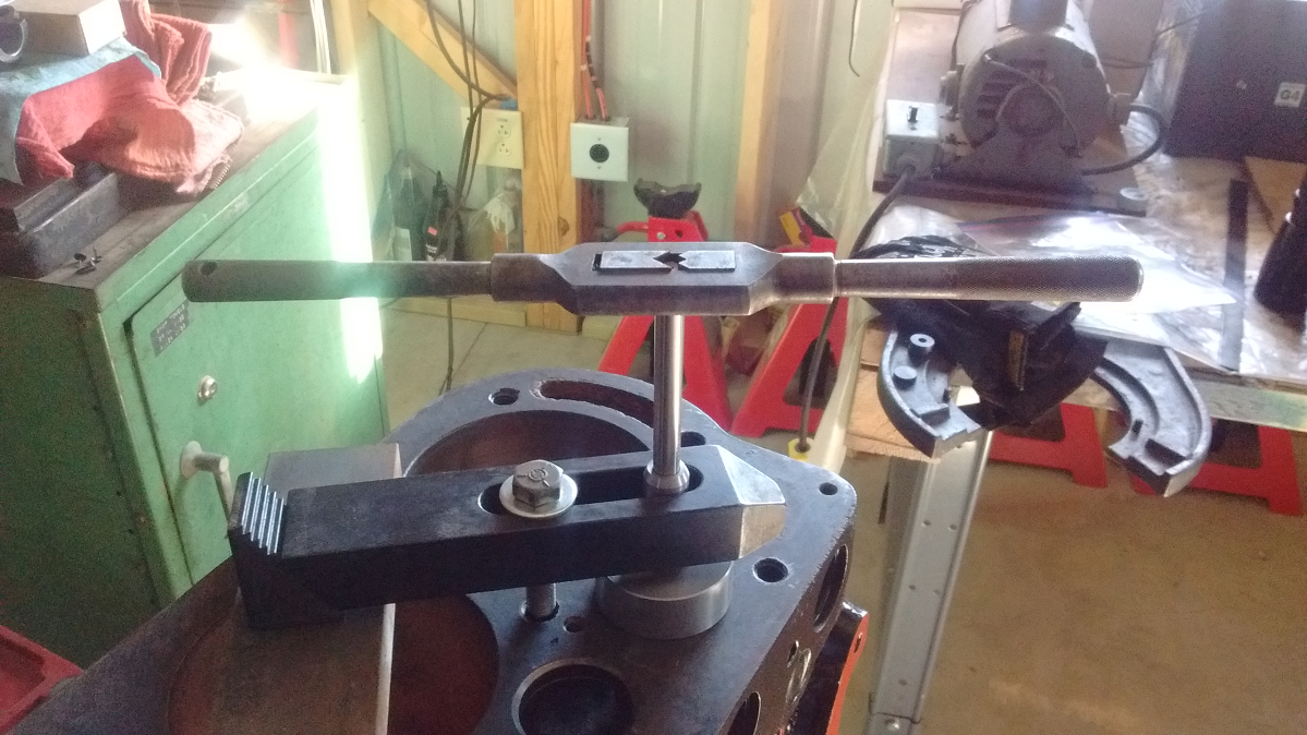

my version of the Stevens Tool for Reaming:
other than a rebuild, "in the car" is the only way I've done it, myself

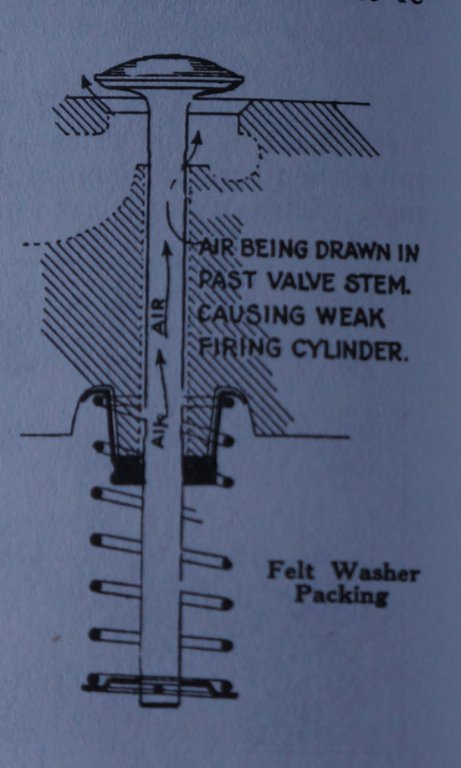

The opening surface area of a 1-1/2” diameter valve opening 1/4”, is 1.18” sq/in. The annulus of a valve guide with .010” wear is a mere .01” sq/in. If you consider that the efficiency of a pneumatic orifice is proportional to its length, you may want to reduce the .010” sq/in number. Also consider that the oil vapor being drawn in is combustible at some value. My point is that the valve guide air leak is most likely insignificant.
Other side effects of worn valve guides are; poor valve to seat concentricity, irregular valve and seat wear, and delayed valve sealing. All of these conditions cause the valves to seal poorly during engine operation, reducing overall performance.
Hard starting can typically be traced back to poor valve sealing. During startup, low rpm’s provide poor sealing valves lots of time to leak down the essential compression necessary for quick starting, especially if hand cranking. Once the engine is started, the poor sealing valves have less time to leak and so therefore are more efficient.
More than likely, your engine suffers from a commonly overlooked problem, excessive valve seat width. A valves sealing power is a result of valve seat pressure. The valve spring supplies a constant amount of force when the valve is closed. This spring force is divided amongst the surface area of the valve seat contact surface. Larger valve seat contact surface = lower valve sealing potential. With valve springs as weak as a T, the seat width must be watched closely. A minimum of a 3 angle valve grind is required for proper valve operation, resulting in quick starting and reliable performance

It looks like in the picture the seal is in the intake port. i guess that would allow oil to retain in the guide. But if its correct that the vacuum created by the intake valve draws oil mist into the valve chamber in the first place i guess oil starvation would occur with a seal added. now if you had a pressurized system i could see the advantage of the seal. i like the idea of soaking the guides with oil before start up to see if its actually the problem. probably have to use thick oil though or you would have to work quick.Craig Leach wrote: ↑Thu Jun 16, 2022 12:47 amBryant,

the oil comes up the pushrods, even though the clearances are very small. How much clearance does an intake valve have? Over what length? Is vacuum "sucking up" oil there? Oil will indeed get "sucked" into the combustion chamber on a really worn guide, but is vacuum the sole mechanism to lubricate a new engine's valves? What about exhaust valves where there is no vacuum...how do they get their lubrication?
the reality is that a felt seal will become wet with oil and will continuously and forever, lubricate whatever valve it is installed on (like you mentioned, it would be short-sighted to not thoroughly wet the felt with oil first). The method was very successful and was the primary disbursement mechanism for oil, on nearly every plain-bearing machine there was, in the era that our cars were built (after the cessation of the use of drip oilers).
Perhaps you know all of this already and if so, forgive me...I just saw your post and thought I'd chime in.
since you've thought it through and asked some good questions, here's some interesting food for thought: early engines had no drain-back holes in the valve chamber...yet they would fill up with oil (considerably!) and leak past the valve cover gaskets with abandon...where could the oil come from? How would the valves get lubricated?
Bryant
- Posts: 1186
- First Name: Bryant
- Last Name: Shafer
Re: Intake valve guide seals.
I understand a lot of things but your post has me confused. To be clear I don’t think it needs valve seals. The topic of the thread was about valve seals. According to modeltfordfix oil gets in the valve chamber by vacuum. I would think a seal would stunt that vacuum. But hey do whatever works for you. Ok now what could be making this engine start and run like it does? Most say carburetor. I think carburetor. So what’s the man got to do to solve his issues?
