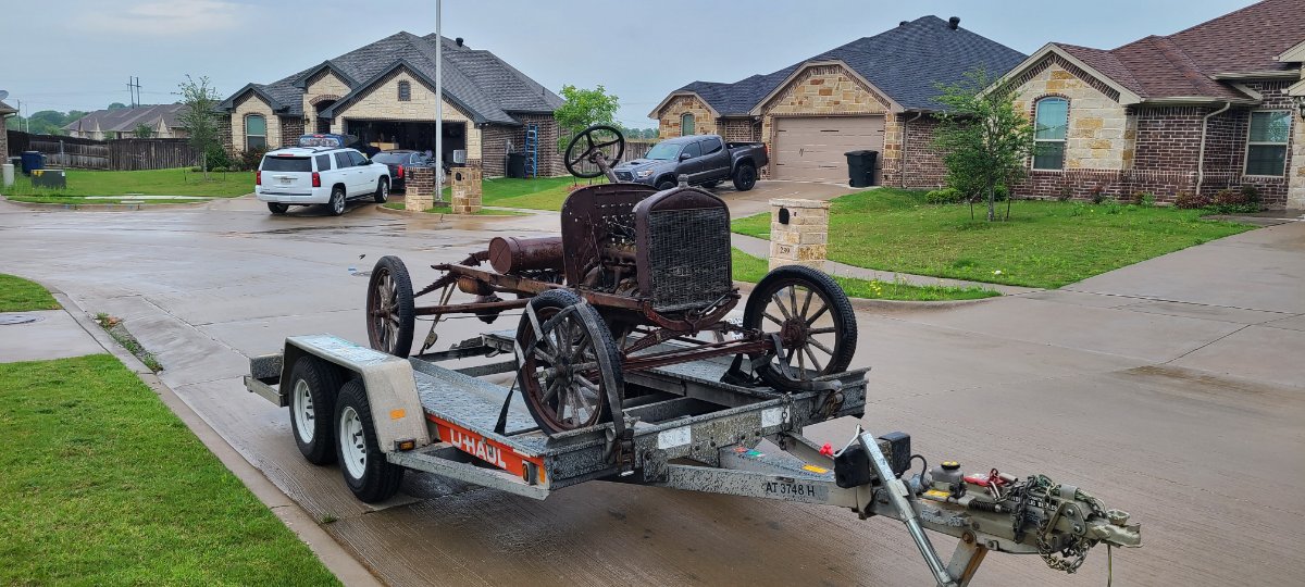

Hello y'all, I have a simple but difficult question. I recently got my hands on a semi rolling chassis with the plan to do a full build series on youtube and of course I'll post updates here to get y'alls tips and tricks. But I have come to a dilema, what do I build it to? Do I go low buck period lowerd speedster and have fun on the streets or do I build a salt flat racer and chase a speed record?
Some things I do know currently. The engine is completely stuck so no matter what I'll be doing a complete rebuild of that. I have no title but according the previous owner and looking up the engines numbers it is a 1919 chassis. I definitly am going to lower it in a period fashion. I have done tons of research on underslung and plan to either get a lowered front axle or dodge/chevy spindles. Most lickely I will be getting wire spoke wheels but for now I'll stick to the wood. I am pining for a OHV conversion but we'll have to see if that is in the cards.

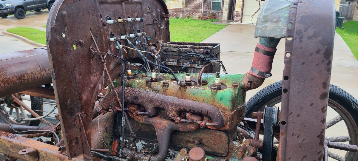

The valve cover looks 1921 or later, and the firewall is 1924 or 1925. So I doubt the 1919.

Also high radiator, 1924 or later.

Thanks for your input Wayne. Yeah its real nice blank slate. Which is kind of the problem. I have and idea of what I want to do if I choose speedster but Langs has so many good choices for bodies its hard to pick.
As to the year. I have checked the number on the engine before against the info availbe on this forum and have atleast the engine dated to august or september of 1919. The rest I figured was a hodge podge of what ever the last couple of owners had.

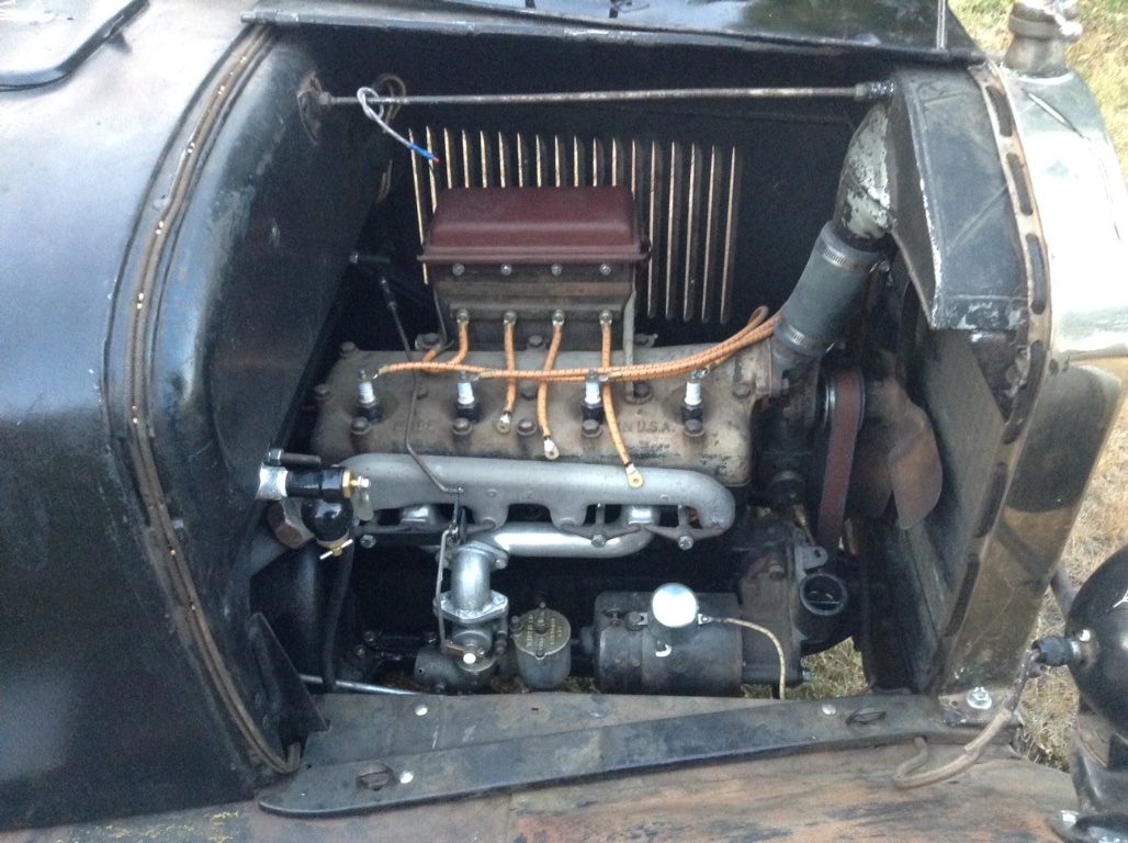

This 'sparked' the thought. Since it has two coil boxes. Would there be any advantage to running two coils per cylinder? Two wires to each comutator terminal. Just a thought.
Oh, and speedster first for tooling around and then you have something to drive to the parts store while building your next one.

I used to run a similar “dual” ignition in my ol roadster. Not sure if the performance gains were measurable tho

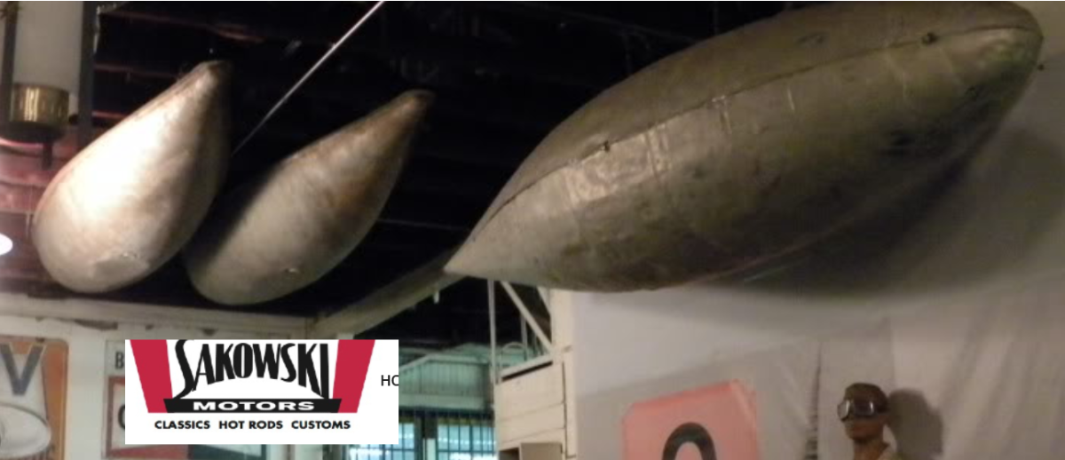

Where do you plan of finding a P38 drop tank?

May still be for sale https://sakowskimotors.com/classic-cars ... onneville/

For the $20 000 for the belly tank, I bet some tin basher could make you
up a pretty nice nice body. Or you could buy an nice speedster..........

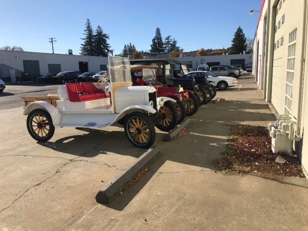

Here's what I did with a frame and 4 wheels AND about $3000.00
