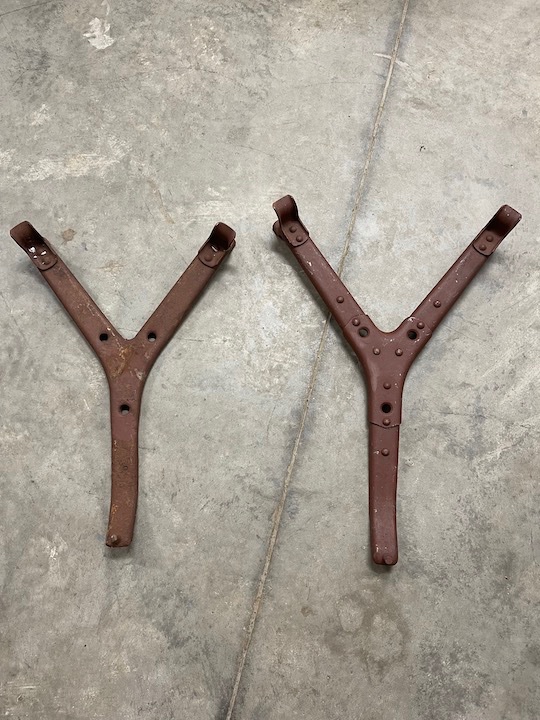

So I have two spare tire carriers one seems to fit my 21" model T wheel the other is a bit larger. Any Idea what car? Seems to be made a bit different as well (extra bracing in the center).

Post by Mark Gregush » Mon Jun 20, 2022 12:42 pm
it is for the 30 X 3-1/2 rims. Not nearly as common the 21 style, but a few 1926 and maybe 1927 cars did/do use that size wheel/rim.
