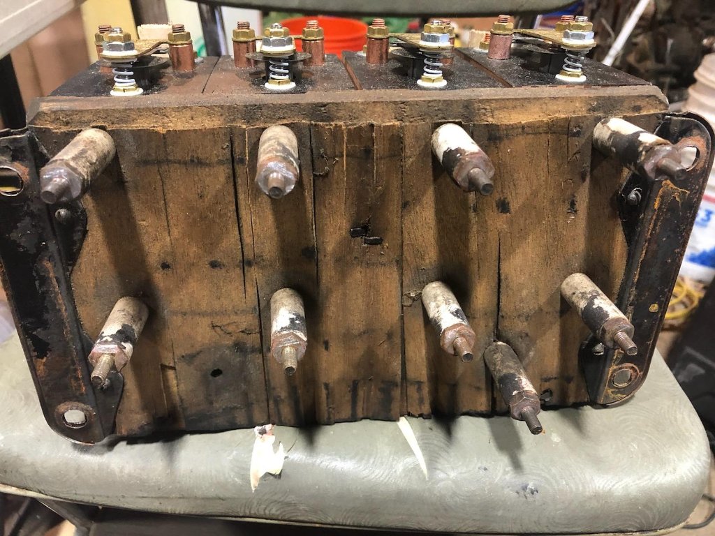

How bad is this?
Wood is cracked and deteriorated. Car runs good for 5 seconds then skips and does not recover.

It's bad.

I have repaired worse.
Best though is to replace the wood with a good (used to be?) Fun Projects kit (if they are still available?).

No Brainer! Coil box is shot and needs rebuilding. No kidding.

I don't think the plastic replacement kits are currently available. Nonetheless, the wood in that box is shot and needs replacement.

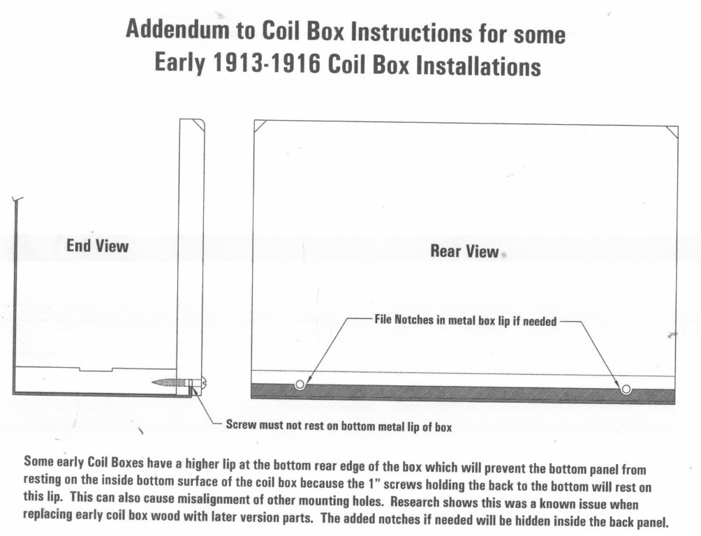

- Posts: 6542
Re: THE HORROR!
Note this requirement
