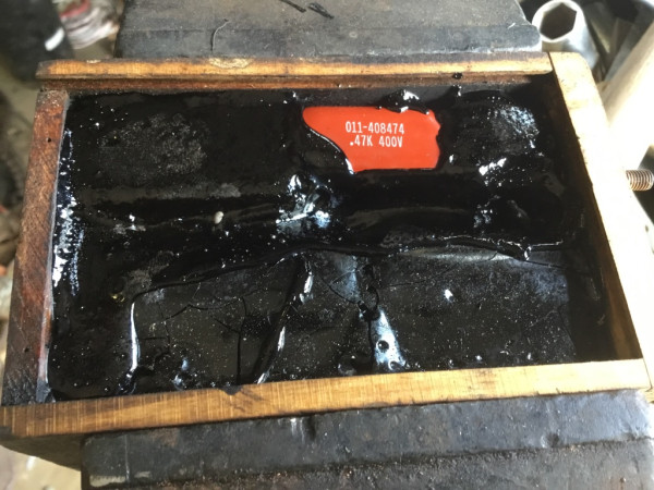

All four of my coils have leaking capacitors. how does everyone feel about the ones Lang's sells? Other recommendations?

It's a bit tedious, but you can rebuild them yourself if you're handy. You will need to repour the tar, and you will need a tester to set them up properly. Easiest to send them to one of the recommended rebuilders, but I'm cheap and like doing things myself.

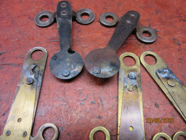

I rebuilt all of my coils with capacitors and points from Lang's and they preform fine. I have had 1 set of points that the top contact came off from the arm.

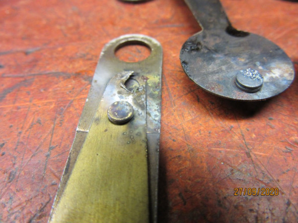

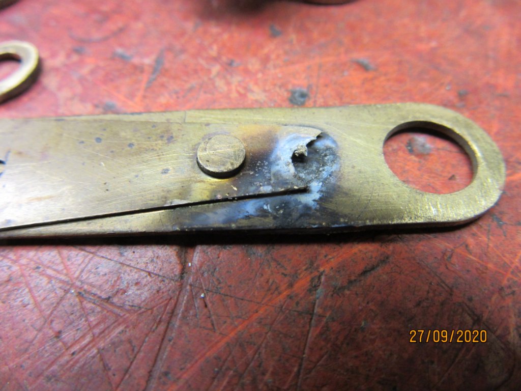

Re: "I have had 1 set of points that the top contact came off from the arm." /////// I had this happen with a set of KW points. The lower contact on one point set came off the steel spring. If your engine suddenly loses performance, this is one thing to visually check before you disturb anything else. In my case, the coil continued to fire, but the engine misfired at higher speeds. The situation rapidly got worse as the defective coil damaged the timer. Attempts to adjust the coils by ear worsened the problem. After damaging 2 good New Day timers and getting all 4 coils badly out of adjustment, I discovered the bad point set. I then repaired the bad point set with used parts sourced from a stationary engine and cleaned up the better timer as best I could, then tried to re-adjust the coils by ear. Failure. I adjusted the coils with the engine running and got better results, but still sub-par. A proper coil adjustment with an ECCT restored the engine to good performance at all speeds and ended the timer problems.

Pat Mc.
Some years ago there was a batch of points who where not good .
I had the same problem [see pictures ]
Toon
Toon
- Posts: 8640
Re: Coil rebuild
I had another issue with a set of used KW points failing after a few hundred miles. I believe that was due to my having filed away most all of the platinum from one of the point contacts, which allowed the steel beneath it to crater out.

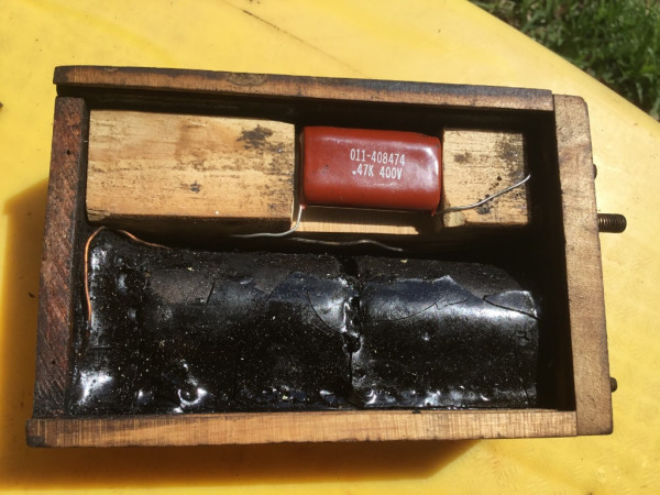

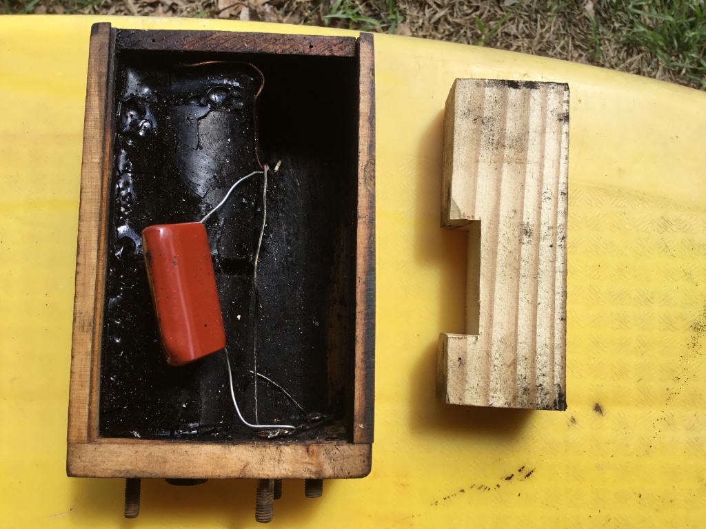

Steve they aren’t hard to repair. The caps sold
by the vendors are OK. Usually I remove the sliding door and gently pry off the short side next to the cap. Chipping out the tar and removing the cap is easy then. Solder in the new one and refill most of the space with wood bits. Save the tar I chip out and you’ll have enough to
Secure the loose parts. I melt my tar
In a Tin can outside with a propane torch. Done about 20 over the years.

. Putting a block of wood in works to conserve weight and tar.

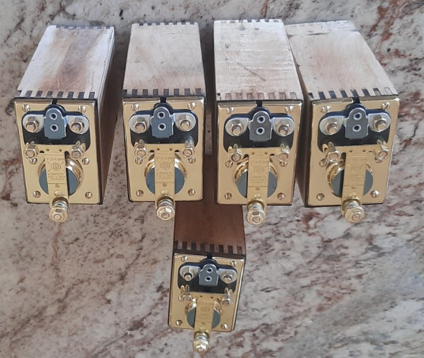

I'd like to bring this thread back to the top.
I agree with certain posters and I am a definite "do it all myself" kind of guy.
That being said, this summer has been challenging in regards to my allowable time.

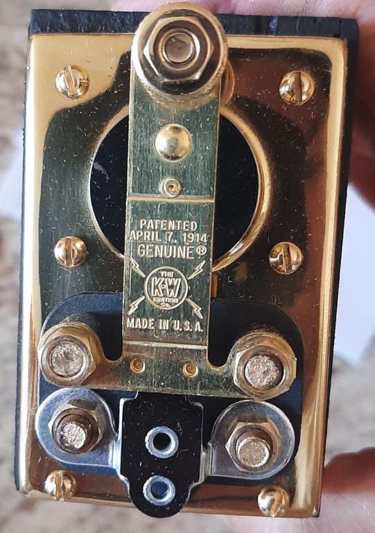

When I opened up the box and saw Brent's work, and then put them on the ECCT and found them all to be nominal, well, Brent is an Artisan of the highest order and I'm grateful for his skills.
The work on my wife's family "T" now continues.
Kind Regards All!
Kind Regards All!

All,
It was a great Mother's Day. Got the 1914 Roadster running and driving and was able to drive my mother in law around the farm. The T hadn't been started since the 70's as far as I know.
As of yet, we haven't used the electronic timer, I wanted to get it running as she was.
My thanks to the Coil Doctor, ECCTfolks, and Lang's.
The restoration continues.
