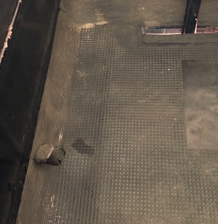

Post by bnold5000 » Mon Jun 27, 2022 12:26 am
There is a strange little foot pedal in the center of the floorboards just forward of the seat that is no longer hooked up to anything on my 1915 touring car. What was the purpose of the pedal?

Re: foot pedal on floor
Post by Chris Instness » Mon Jun 27, 2022 12:56 am
Most likely was connected to an accessory exhaust cutout.
Post by Norman Kling » Mon Jun 27, 2022 12:56 am
Is there anything below the floorboard? Such as a switch or a lever? It could have been a starter switch if the car had a starter at sometime in the past. Or it could be a muffler cutout switch or a switch to an exhaust whistle. If you can show what is below the floorboard, it might be easier to figure out what it is for.
Post by KWTownsend » Mon Jun 27, 2022 12:52 pm
What does the business end look like?

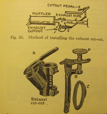

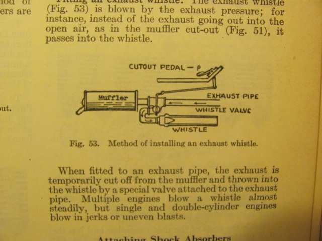

If that pedal is a 'locking' pedal, with a small toothed notch and spring too), then an exhaust cutout was once installed. The locking is to keep the cutout open, until you hit the pedal and release the lock, before the cops catch up with you :lol: .
IMG_5005 - Copy.JPG (99.73 KiB) Viewed 2788 times
If the pedal is just plain hinge, that is for an exhaust whistle, as you press and hold for just the instant sound, and a typical spring mounted some where in the connections allows the release for stopping the sounds.

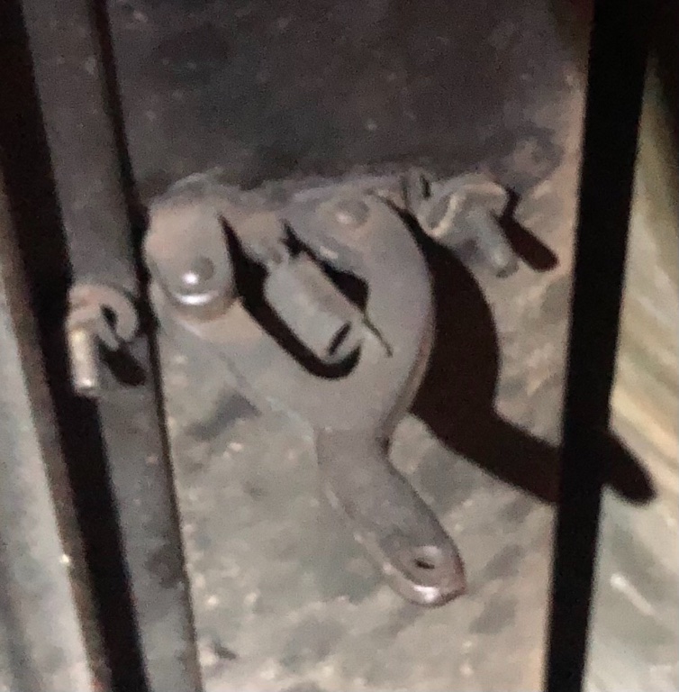

Post by bnold5000 » Tue Jun 28, 2022 11:43 am
i finally got a chance to check the pedal out in more detail. It has the tooth that locks it down and the spring……so it looks like i had an exhaust cutout at one time.
Post by bnold5000 » Tue Jun 28, 2022 11:44 am
here is the underside
Posts: 6582
Post by TRDxB2 » Tue Jun 28, 2022 12:34 pm
Take a look at the exhaust pipe towards the rear o see if you have something attached to it. May be that the spring from the pedal is gone
