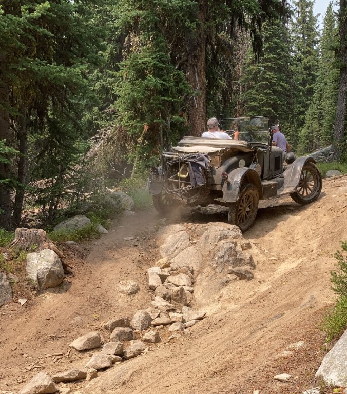

Post by Dennis Prince » Thu Jun 30, 2022 8:46 pm
I am with George, I have run rubber pads on my T's and it does nothing but help. I have put over 100,000 miles on one of them and there is no wear on the frame or the mounts and I run mine pretty hard. Some people seem to go on theory alone and don't do any research. A theory is just that until proven or disproven.
