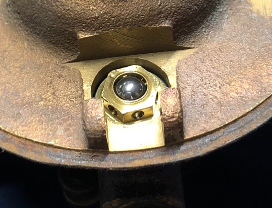

My 1915 Touring Car is running rough at higher rpm after I’ve replaced all ignition components and I’ve decided to go through the carb. and make sure it is ok as I have never done this yet on this car and feel that some issue with it is probably the culprit.
I have discovered that instead of a needle and seat attached to the float that I instead have a ball valve. Is this a “grose jet” that I have read about? And does anyone know what the correct float level is on the Holley G and how to set it?

The last thing in the world you need as an inline fuel filter. In a gravity-feed fuel system it just makes fuel starvation worse. If you have dirt fine enough to get through the sediment bulb screen, the answer is a clean gas tank.
That ball valve is not the original type. Maybe somebody who has used it can tell us if it's any good.

That is a Grose valve and I have had a bad experience with one
I replaced it with original type but with Viton tip. Works well.I like to have a shut off valve at the carburetor, but 1/4" valve is too restrictive, so I run 5/16" line. I also use in-line filters and have never had a problem.

Model T Fix website has pages for rebuilding different carburetors.
This is the link for the Holley G.
https://modeltfordfix.com/rebuilding-a- ... arburetor/
They use 5/16” as a float setting.

This is an initial setting. The correct setting is confirmed wet with the 3 screw cover top off, Looking @ the fuel level in the jet bowl.KBurket wrote: ↑Wed Jun 29, 2022 11:13 amModel T Fix website has pages for rebuilding different carburetors.

That dimension is in the service bulletins book, among others. I dont recall off hand. Ill have to check my books unless someone beats me to it.

I run a G on our '14 - they have a reputation of being "temperamental" at best for float setting. The Ford Service Bulletins show a diagram & a special measuring tool to properly set the depth of the gas in the well corresponding to the pick-up tube. Corey Walker set mine up - runs flawlessly !

The beauty of this carb, is that its easy/possible to get perfect by having visual access to the actual fuel level.RajoRacer wrote: ↑Wed Jun 29, 2022 11:32 amI run a G on our '14 - they have a reputation of being "temperamental" at best for float setting. The Ford Service Bulletins show a diagram & a special measuring tool to properly set the depth of the gas in the well corresponding to the pick-up tube. Corey Walker set mine up - runs flawlessly !
NH's have to be fine tuned by determining running performance.
