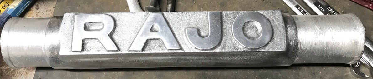

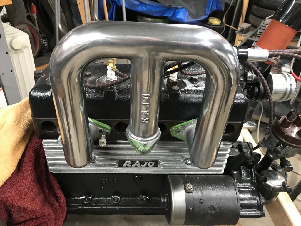

Polish it and then clear coat, if desired, with high temp paint. Its easier than you think the process is simple, you need to be aggressive. Start with a grit heavy enough to remove casting bumps and marks, then move up to the next grit to remove the scratches made by the previous grit, repeat the process till your at 600 grit. Then clear coat with 2000 temp.
On a visit to see Elvan Townsend (he made many of the aluminum castings accessories and speedster builder the BULLET), I purchase this water outlet from him, when I mention polishing the letters, he proceeded to show me. Started with a medium coarse file to a fine one then sand paper.
That aggressive approach helped me proceed on my first attempt. This was done by hand, in about 4 hours. I was a bit cautious not knowing what to expect. Could do it now in 2-3hrs

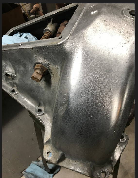

I intend to do a aluminum hogs head, I started to see how it would go with 100 grit just to see what to start with
