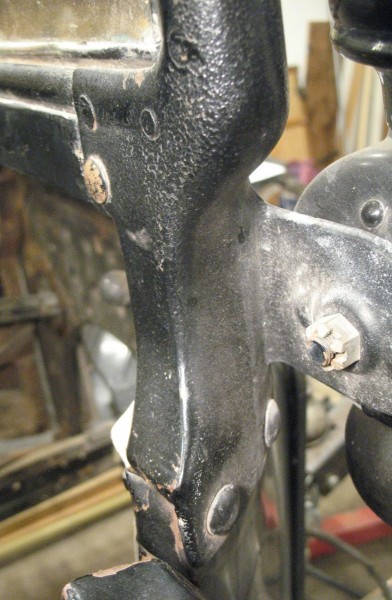

- Posts: 4414
Re: '15 touring windshield removal
According to the parts I have, the two carriage bolts on the outside are NOT the only thing holding the windshield brackets onto the body! There is also a bolt inside the body lines bolting the bracket to the inside of the cowl piece. On my car, I used a round head bolt for that inner bolt. The decision to use a round head bolt was based upon a few old photos, and may not be correct as the bolt really didn't show well in those pictures. I am not certain what style bolt was originally used there. Besides, that bolt may have been changed on any car through the many years now. I have noticed several Ts with common hex head bolts there.
Both the spare windshield and another spare bracket also have the hole for that inner bolt. So I am fairly certain it does belong there on most open Ts during those years.
For whatever it is worth. I know some people have removed the windshields from their touring cars or runabouts, supposedly with little difficulty. However, I plan to NEVER remove the frame from my runabout. It was h0!y he!! putting it on! The body had been separated from its original chassis decades earlier, the wood was rotten, about half missing, and the sheet metal had been messed up a bit by someone wanting to make a "bucket roadster" out of it. After which the body sat half collapsed outside for a few decades. Basically, a lot of repair, guesswork, wood replacement, and damage undoing was done before the windshield brackets and frame were installed. Things didn't quite want to line up, but I finally fought it all together, and it looks good. I have the glass for it, but have not tried to install it yet. I dread the day.
- Posts: 7413
I stand corrected. As Wayne says, there's another bolt inside. I don't know how I missed it.
- Posts: 4414
Thank you Steve J for the picture!
