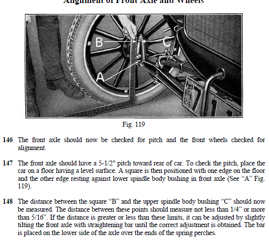

The front axle should lean back about 5 1/2 degrees, see the attached diagram. An easy way to check is to place a carpenter's square up against the front axle. That will make the lean easier to see.

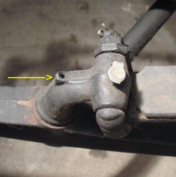

Later spring perches have a divot on the top for a lathe live center to fit in when they were originally machined. That divot should be on the rear side of the perch when installed correctly, see the attached pic. :)

Figure 119 on Page 45 of the Model T Ford Service Book shows a photo of how to check that front axle 5 1/2 degree lean.

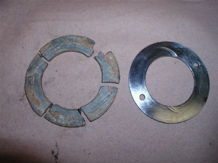

I went through the same problem about 3 years ago with a complete restoration 1926 Touring that had received all the AACA Awards they had to offer and most parts of the car were New Old Stock parts.
The car would do anything, but go straight ahead, if it headed for the ditch and I steered it straight, it would head across the road, and it always continued to do that again, as it headed back toward the ditch.
What I finally found wrong, after the front axle had been totally removed and inspected, was that large Babbitt washer on the ring gear side had been ground to pieces the size of course gravel and when some of those pieces got between the ring and pinion gear, it would work like a crawler tractor turns, by braking one rear track wheel.
The best Babbitt washer was on the opposite side and not too good.
Thrust Washer2.jpg (27.19 KiB) Viewed 2717 times
Now, I still believe the most over-looked part of any restoration is that rear axle assembly.

The figure Jim mentioned in the service manual can be confusing. This is from the manual.
Caster measurement.gif (67.7 KiB) Viewed 2680 times
It says the measurement at B should be between 1/4" and 5/16". However, the distance between the upper and lower bushing surfaces is 6". I did the math. If the axle is tilted 5 1/2 degrees, the dimension at B would be 9/16". The axle on my '26 has 9/16" rearward tilt at the top and it steers beautifully.

Mark Nunn wrote:
Thu Jun 30, 2022 8:55 am
Its not confusing, Its just plain wrong. The bible has an error. Which spec did they intend??
The axle tilted back 9/16 does make for a very stable front end.
Especially noticeable @ hi speed.
