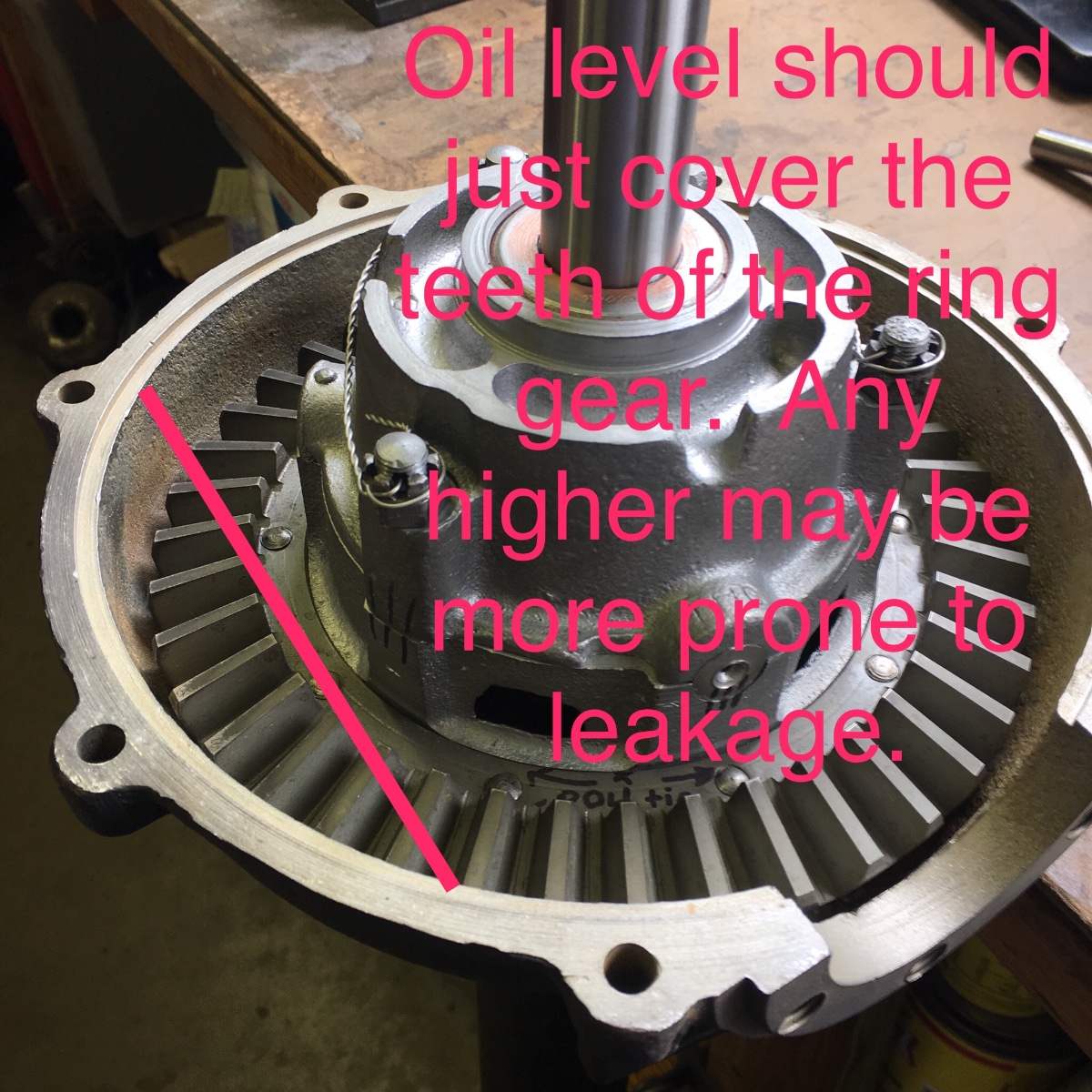

Probably nothing to worry about. Just keep an eye on the level and change the diff oil every time its over full.
You only have to fill the diff this much:

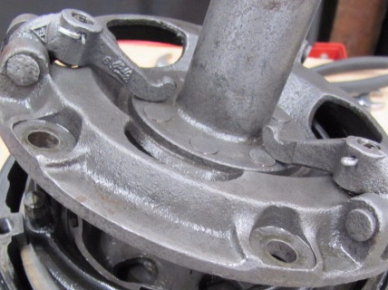

If you are getting that much engine oil into the rear end, most likely there is no plug in the transmission driven plate output shaft. There should be a concave type freeze plug in the transmission output shaft just in front of the square that the u-joint fits into. That plug is to prevent engine oil from going out past the u joint and down the driveshaft. Has your transmission been rebuilt in the past? Also, you will also find that there is no grease in your u-joint as the engine oil has diluted it.

When the engine was out we replaced the reverse drum, which was scored, and installed new "Jackrabbit' clutch plates.
Not sure what the driven plate is.

Post by DanTreace » Sun Apr 14, 2019 3:09 pm
Driven plate plug placement.
Driven plate

That makes it clear. We re-installed the old component during the engine swap. If it is missing the plug, it must have been for a while. I suppose you can't check if the plug is there unless you drop the drive shaft?.
