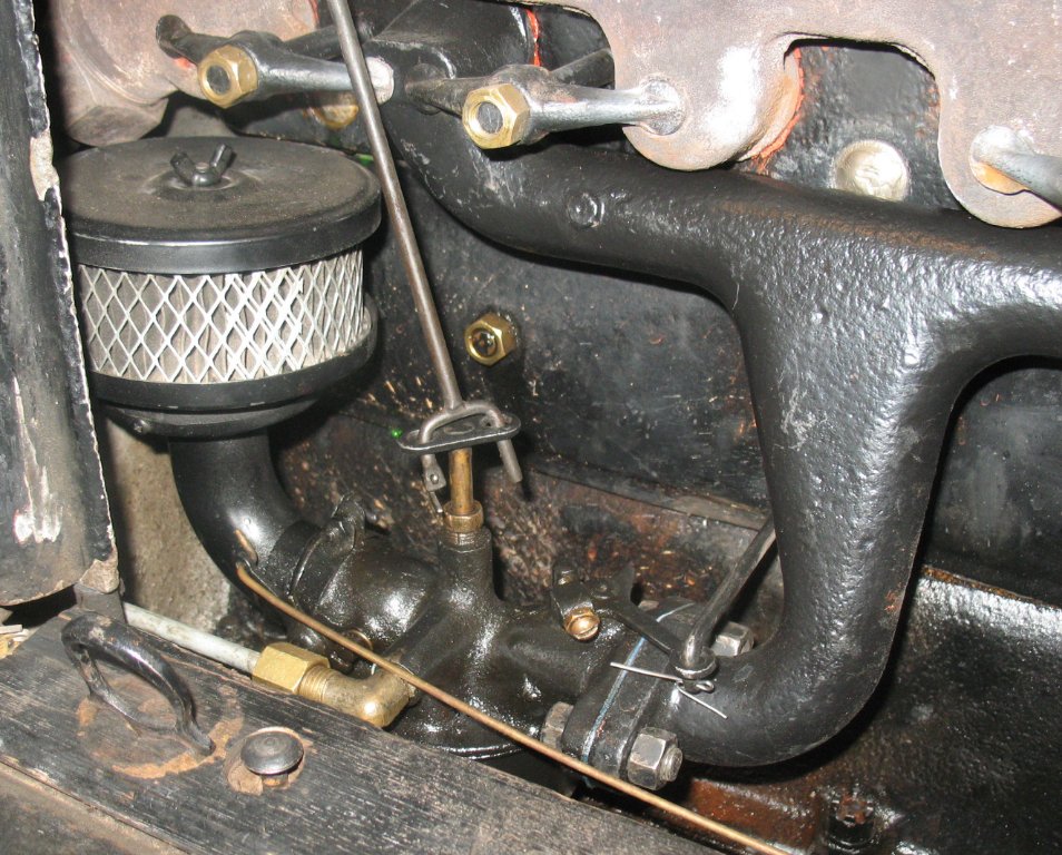

John.Zibell
- Posts: 391
- Joined: Mon Jan 07, 2019 9:09 am
- Last Name: Zibell
- Location: Huntsville, AL
Re: Does The Model T Need That Hot Air Pipe?
I'm a believer in delivering filtered air to an engine. I use the spring loaded foam filter available from vendors. I live in humid Alabama. I've seen condensation on the outside of the manifold, but run with no issues. With the filter against the hogs head it may pick up some heat, but I'm not using nor do I plan on using a hot air pipe.
