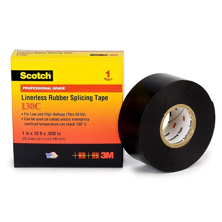

My T, with a roller type timer, ran well when idling, but had trouble when I advanced it. Turns out that the timer contacts would touch the timer rod at certain locations on the rod as the timer would rotate. I remedied it by wrapping the timer advance/retard rod with 3M, 130C rubber (not vinyl) electrical splicing tape. Stretch it as you wrap it around the rod and it will weld itself to the prior wrapping creating a solid rubber sheath of insulating rubber the length of rod that comes close to the timer contacts as it is advanced. This is the type of rubber tape your baseball coach used to wrap the baseball bat grips with. Jim Patrick
PS. The featured box says the roll contains 10’, but since it stretches about 4 times the length you pull off the roll, you really have about 40’ of tape to work with.
